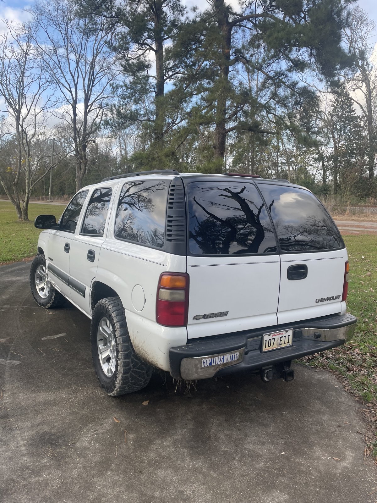

Pics of the truck, please.

That thing is clean. I didn’t think I would like the look of a lifted Tahoe. But yours is nice.

I’m not lifted at all… yet. But I just stuffed some 33’s which helped with ground clearance. But I will end up having 3” of lift in the back so thank you!
