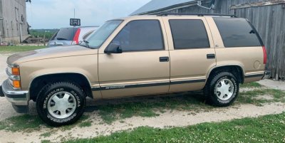

Need some help!! Does 2dr tahoe leaf springs fit 4dr tahoe?

While the measurement on the rear leaf springs look to be the same, measuring from center pin to the eye on each end looks to be 27" on front of spring and rear of spring, the width can vary as well as the leaf pack count itself. May require a different axle pad for the springs to fit and mount properly. The thickness of the leaf spring can also be different. There are samples of them at RA. I am saying all this assuming you have a 1998 Tahoe.
