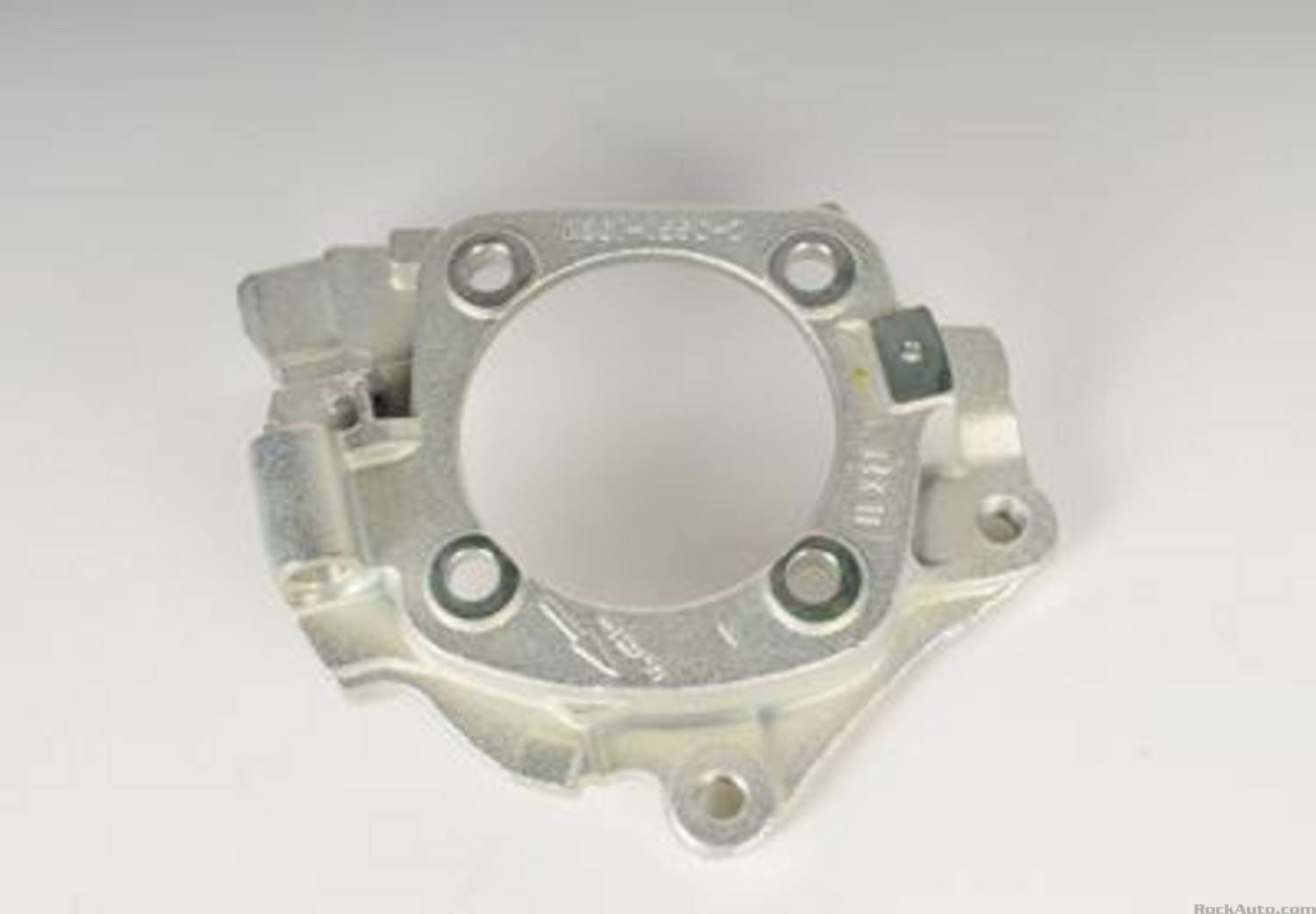

A new adjustable parking brake cable may help a bit. This runs from the pedal to the rear end of the truck along the driver side frame member.
I found out the issue with my truck was the Brake Backing Plate. These have a tendency to wear down where the lever your pedal and that cable move, pivots to apply the parking brake shoe. Over time there's not enough leverage in the system to activate the parking brake anymore. IMO the metallurgy is lacking, it's aluminium which erodes too fast with use.
Link to part
I got some different ones for my truck from the junkyard. They helped my truck quite a bit but isn't perfect. I recommend buying new ones if you do that but would try a new cable first and COMPLETE service as it's a bit of a PITA to change the anchor plates. You have to remove the axles from the housing meaning there's a fair amount of disassembly involved. Although, most certainly something about anybody can do.
There are several styles so make sure you buy the right one... This is what my truck used but looked up for a 2005 1500 Suburban
