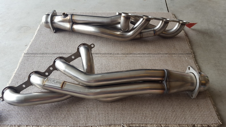

Kooks all the way. I have an extra Y pipe for sale at an amazing price. Sounds freaking awesome, check my build thread. Quality is second to none...
Edit: No clearance issues with 07 Denali 6.2 AWD and Kooks 1 7/8" with kooks Y pipe. Fits perfectly... Sounds better than a Corvette
Don't go with a cat back and down size your 3.5" stainless exhaust to 3" like all kits except one (not corsa).

I agree. After several years of skimping on headers both shorties and longtubes, I decided when I pulled the trigger this time I would spend the extra money for quality and fitment. I am TOTALLY happy with my Kooks. Everything fit great and NO issues with the AWD. There may be longtubes out there for less money that work and fit just as well but I wouldn't change a thing. I went with the Kooks 1 7/8 primaries with the catted Y-Pipe through the factory catback. I swapped out the stock muffler with a Magnaflow and did the SLP Resonator Delete. Sounds great!!

Same here and it sounds amazing... No drone at all. They aren't that much more than others if you shop around. I'm sure the long tubes can be had for $750-850 and I've got a set of the catted Y pipes for far less than the $699msrp.
Kooks!

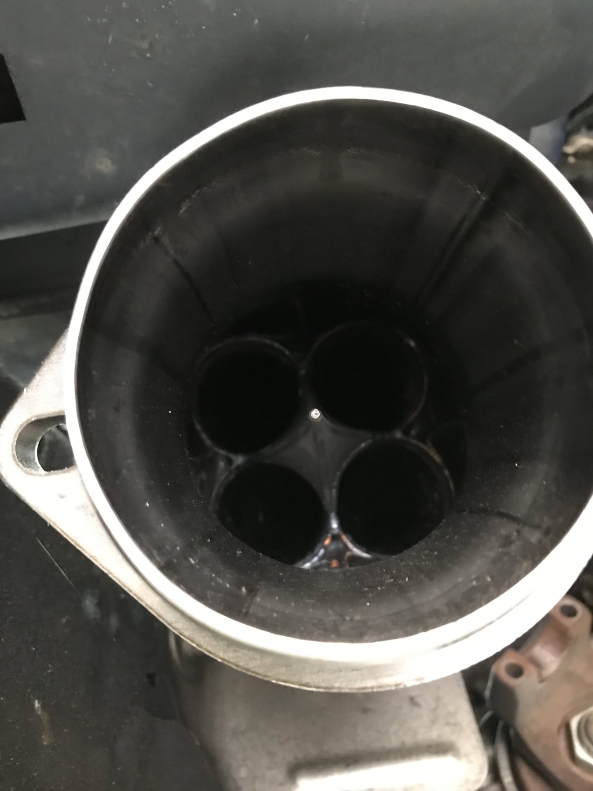

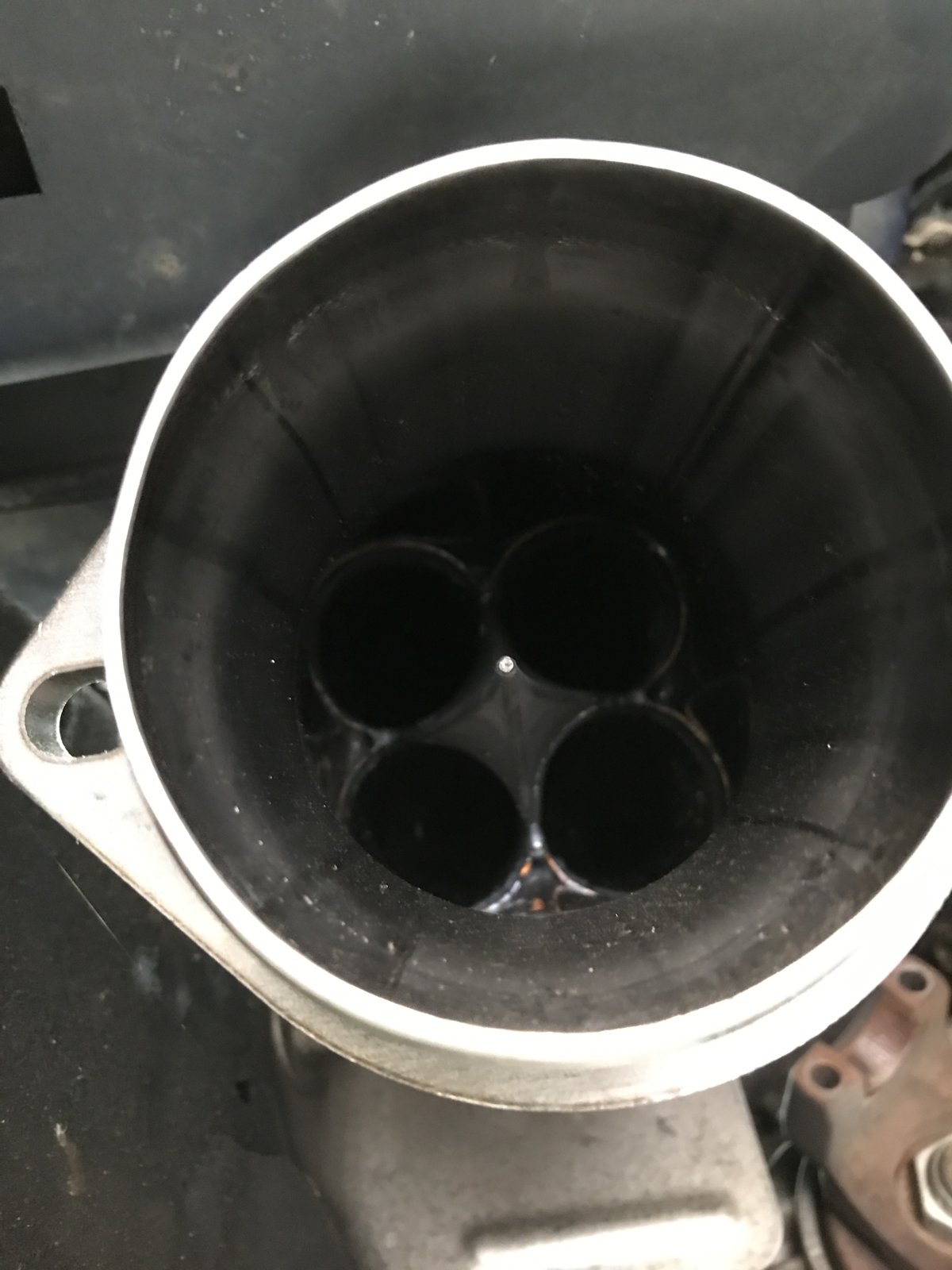

They really go the extra mile on quality. Welding is top notch and the merge collector is very well designed. A nice touch I've never seen on many headers..
