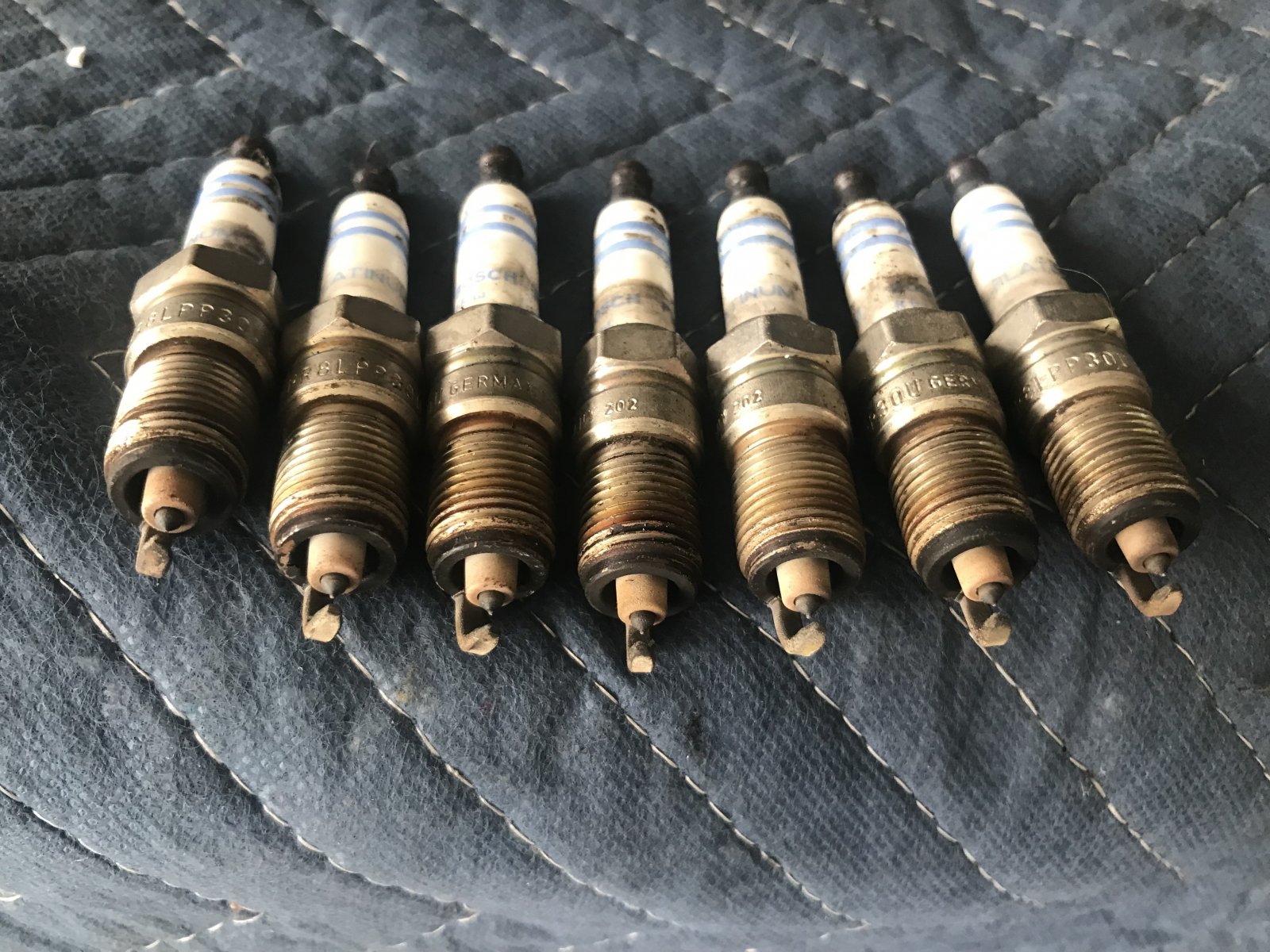

Too Funny...are you trying to get me started on my RANT against so much plastic these days? You may be on to something tho i will agree about the excessive back pressure and heat. The plugs were Bosch platinums and all seemed to have equal burning, only 7 already had chucked 1. Compression test incoming along with a fuel pressure test. Fuel pump replaced 2 years ago, not sure on the regulator. I have cleaned the MAF sensor before but never tackled the throttle body.
