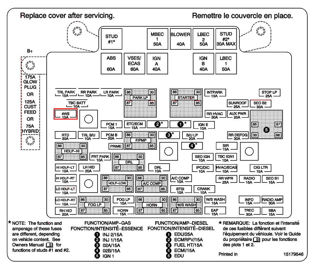

Final update. If anyone has the vent solenoid code, check your 4ws fuse under the hood. Apparently the vent solenoid under the truck gets power from the 4 wheel steering fuse regardless whether you have quadrasteer or not...
So after finding that out and putting a fuse in, my evap codes are gone and has successfully pass inspection

so the vent solenoid the one above the rear diff runs off the the same fuse as quadrasteer even in vehicles without you should post a picture of were the fuse is at

Yea it was a tough one. I had searched before for any evap fuses but this one didn't come up until I searched for evap wiring diagrams.
Here is the pic. This is the under hood fuse box. Circled in red
