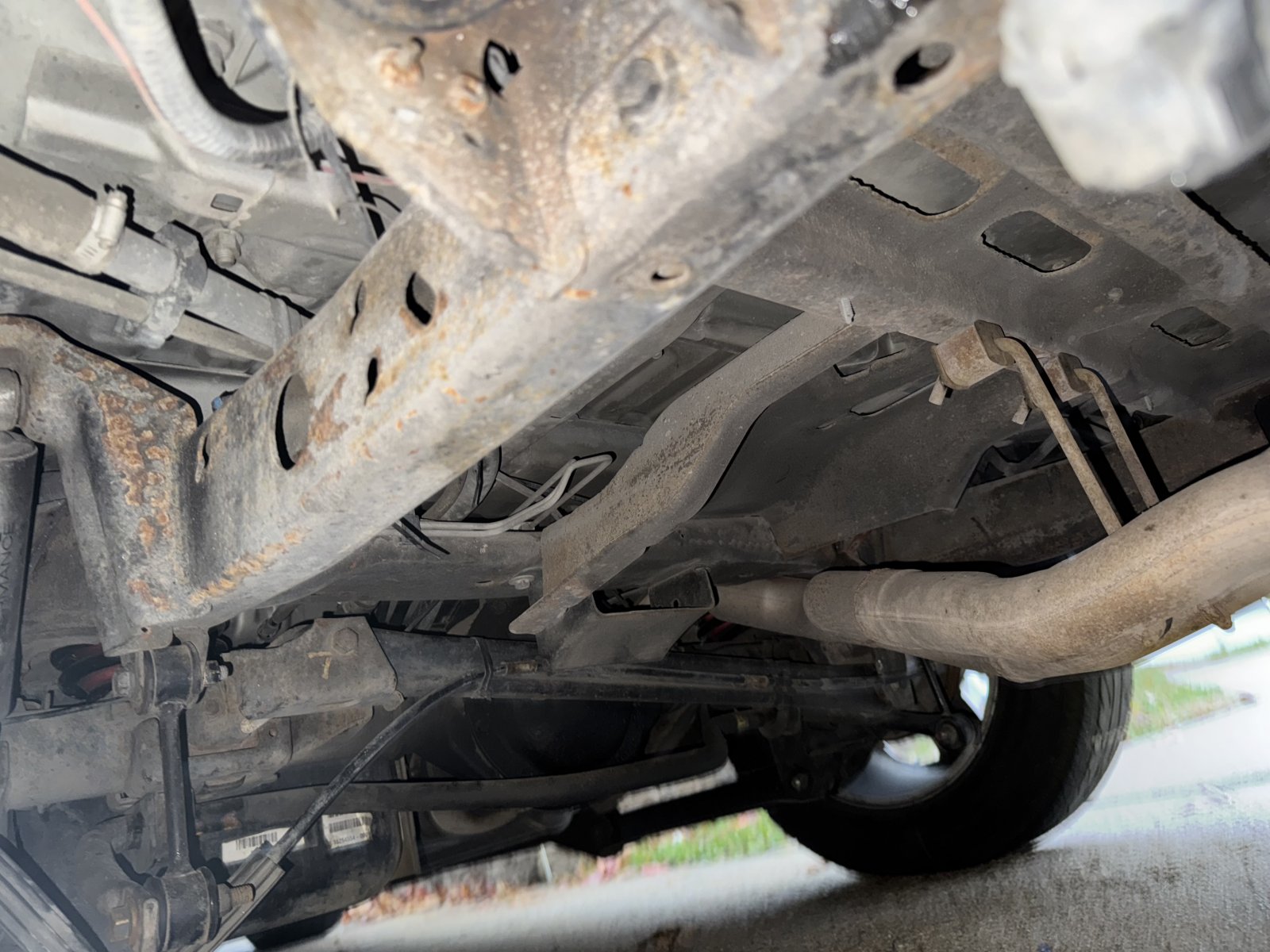

I was driving in the rain stepping on it to make the wheels spin and sliding. Stopped at a gas station to fill up and go home. And as I was leaving I heard and felt stuff going on in the rear. So I parked to check if my driveshaft fell out but it didn’t so I went to put it back into drive and it didn’t move at all. Put it in each gear and didn’t get any movement even in neutral. Got it towd home and look under the next morning and saw that broken. Lifted the rear and put it in gear and nothing moved not even the driveshaft. What else could cause it not to go in gear? Broken rear end? Broken transmission?

I'm unsure what that is from your picture...
Can you get a better of the broken linkage. That doesn't look familar to me. What's it next to? Perhaps get a picture showing more of the stuff around it.
What year make and model is your vehicle? If one in photo looks like a lowered GMT800 Tahoe chassis? Is that a leaf spring on right hand side of photo. I cannot tell what that stuff is.

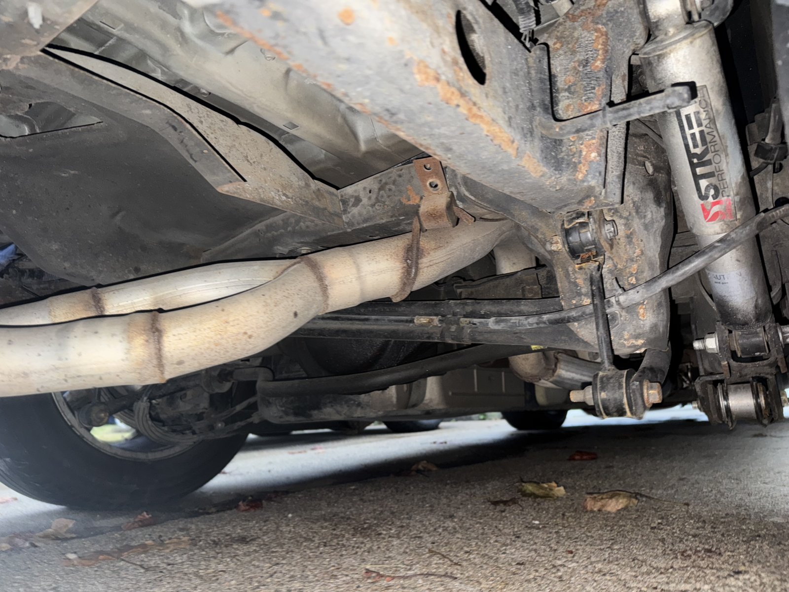

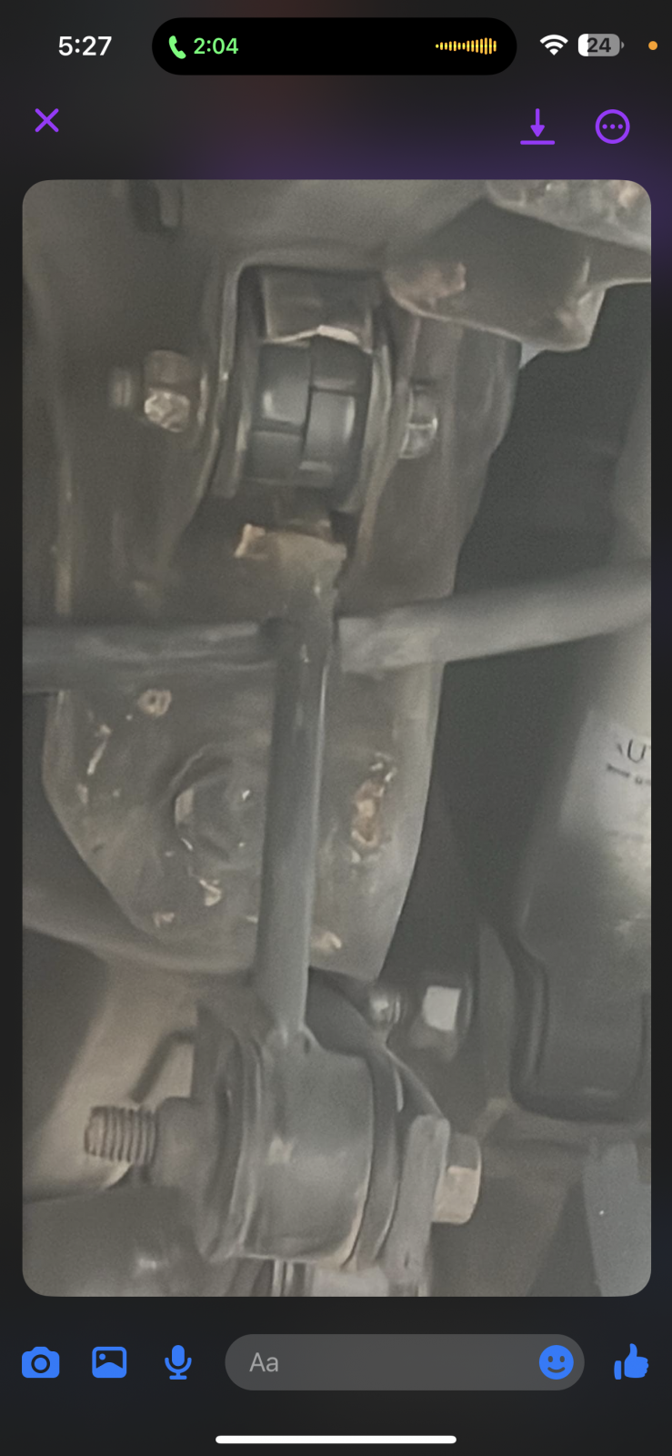

First pic is passenger second driver. It’s a 2006 2wd. will check all the fluids when it’s Not so gloomy out. Put it in every gear but did not move at all driveshaft didn’t even spin only revved up. Haven’t checked for codes just yet. When it did break the noise came from the rear kinda like the diff area but has since stopped making noises.

I'm not familiar with the 2wd frame / suspension. However, that's a sway bar end link. You'll want to order a new one. Not sure if it's factory as your truck looks lowered??? Either way it's a piece of cake to replace so long as you get the right part. It would make a huge racket but wouldn't keep the truck from going into gear / moving.
It could stop making noise if the linkage completely brakes and falls down. It's pretty common for sway bars, and links to break.

Obviously a broken piece here, when these trucks are lowered its good to install an offset arm like this https://djmsuspension.com/product/2...r-sway-bar-end-links-for-lowered-suspensions/

The broken part in the pic is not at all related to why your vehicle won't move. The sway bar link is for nothing more than vehicle sway, side to side, like while cornering. You could likely have snapped your sway bar link while you were sliding around in the rain. It's at the incorrect angle to do its job properly. Your vehicle is lowered and that looks like a stock sway bar link. The sway bar should be parallel to the ground, not at an angle downward.

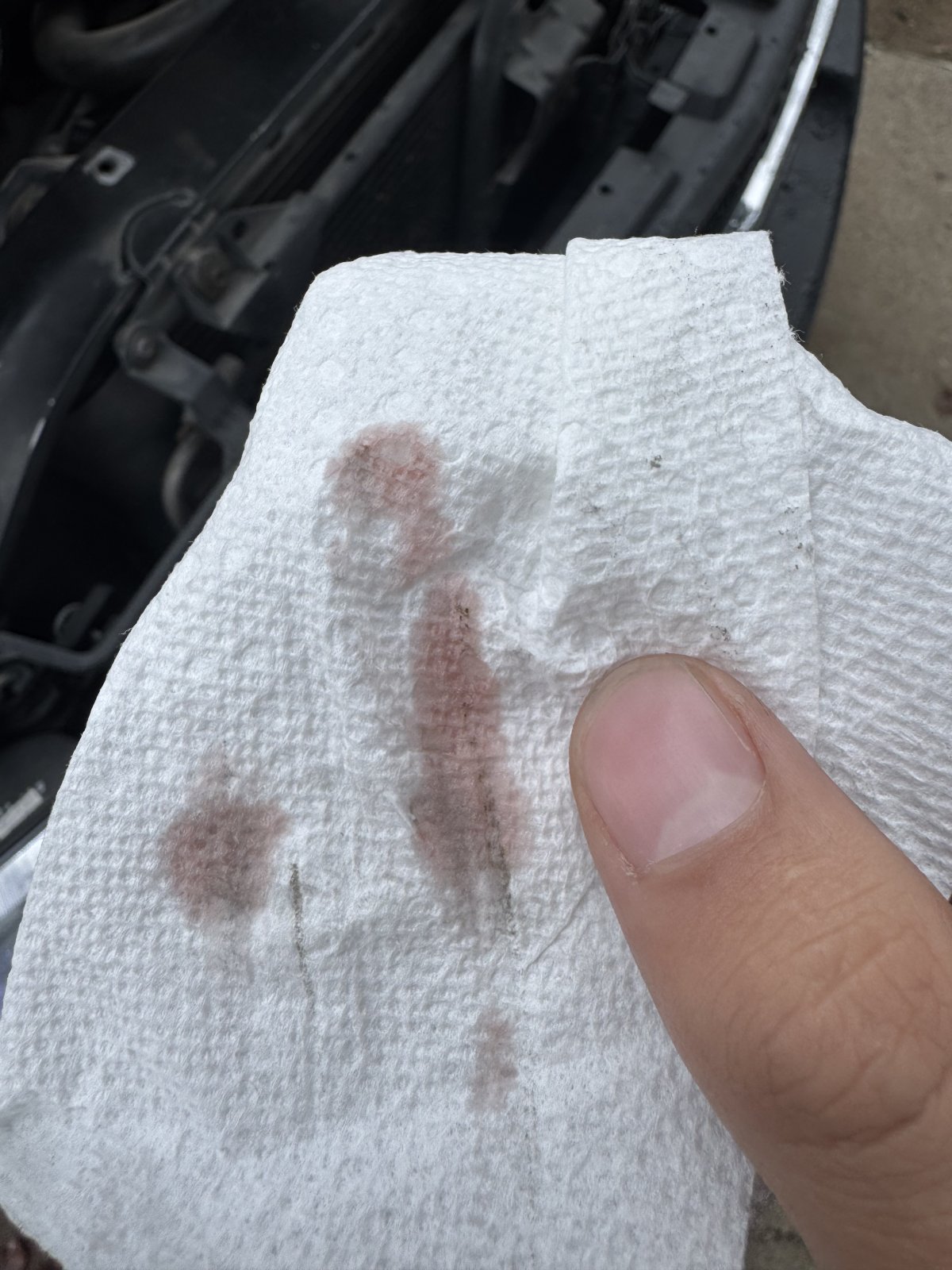

1. I checked that and it looks all good there seems to not be messed up any
2.they used a truck that picked it up by the rear wheels so the fronts rolled.
3.i tried spinning them in all gears with both sides off the ground and it Didn’t want to move any.
4. Still none have popped up.
5.im not too sure as I bought it built how it is all I was told is “it has 4:10 gears with a locker” in it
6.transmission fluid looks good but can’t really tell in the pic but the build only has 30k miles on it look at pic for detail of fluid.

Fluid pic looks good. That's reassuring. Not to say there's nothing in bottom of pan, but at least you aren't seeing clutch material in the fluid.
