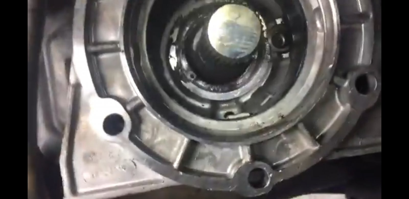

Okay so I've discovered the terrible design of the 4L60E tailshaft when mating to a Transfer Case Adapter. There is no external seal on the transmission so the adapter "tunnel" fills with ATF. I've been scouring the internet and found others with the same problem. There is some discussion of a "grey silicone". I don't believe it's RTV. Can anyone tell me what it is? Mine actually had some on it when a remanufactured transmission was installed! I have some Permatex Transmission Sealer that's supposed to be impervious to ATF. Should I use that? I am actually considering tapping a small hole in the bottom of the adapter so I can remove the plug and drain it once in a while! Need some advice please.
There’s a seal on the transfer case and paper gasket between the two. I usually put a smig of rtv on the gasket surface before bolting up
