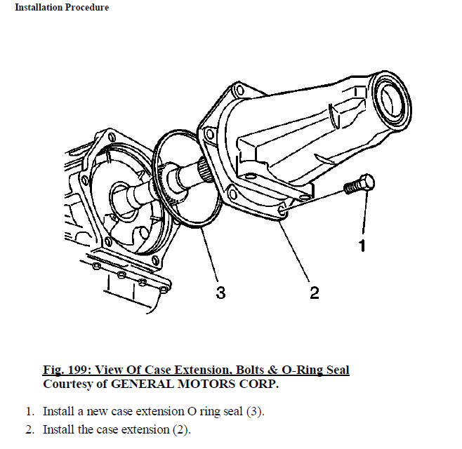

There is a large o ring if I remember correctly that goes in the extension housing. Other than that, there is a paper gasket between the t case and transmission extension housing. There is no need for any type of silicone/RTV

My memory isn't the greatest but I think this area is supposed to be dry and only becomes fluid filled when one or the other seal fails. Precision Transmission's youtube videos talk about this relationship as does the shop manual.
Yeah I've watched a lot of videos lately. Like that guy Richard. Is he ill or retired now? How about a photo of that page from your manual buddy?

No difference between tail adapters, same o-ring and seal.
Hey Thanks! Glad to hear he's okay. He's a good ol boy. And I like pictures. Kinda what I expected though. Poor design in my mind. I believe they put a seal in with a snap ring on the 6L80E?
