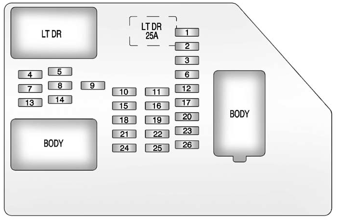

Which one in this diagram is info?

It's number 22 on that diagram (same as the diagram in my car); thanks for replying. I would love any input you can give

So I've done some digging and found out some interesting information. Lots of what I found out confirmed what you guys said...inside fuse 22 = info, which is the DIC. But when I pulled the fuse, what I thought was the DIC, was still on. I thought that it referred to the buttons to the right of the cluster, and the display at the bottom of the RPM. I was confused because the buttons still worked and all of the functions of that VFD still worked. So I dug a little deeper.
After running across some wiring diagrams, it looks like the DIC that fuse connects to is the OnStar module, also called the VCIM. Sure enough, the little green light on my mirror is no longer on. I can't find any other functions in the car that are affected, so I think that this is indeed the main culprit. The resting power draw is now about 90mA, which is more than I would like but much less than it was. I'm going to keep digging and post here, but I hope that info helps someone.
