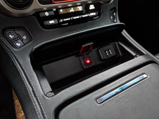

There are plenty down there to choose from. Also, I took out my 12v socket in the console and installed one of those ubiquitous little round 12v switches. Since that socket is switched, it was easy to repurpose. I kept the flip-down cap over the switch and use said switch to control my Uniden R3 radar detector mounted top left of windshield. Maybe that might be an option.

Got it. I used a switch on mine since I’m regularly in VA and occasionally have occasion to switch the unit off. Pic below, although I replaced the little pod it’s in because the spring broke.
If you don’t need the switch, I’d say just run it from a fuse tap on the drivers side fuse box and either method, run it up the a-pillar, being mindful of the airbags.
Good fortune with the install
