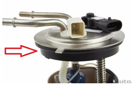

It seems to include the “fuel sending unit gasket” that’s indicated by the arrow:

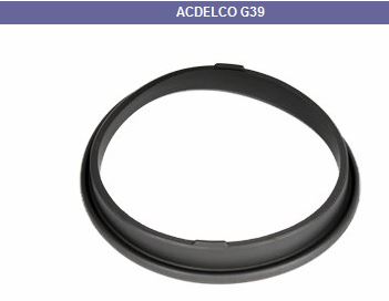

And separately that gasket looks like this:

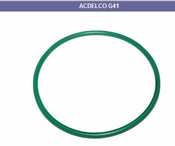

Is that the only gasket I need for this, or do I also need the “fuel pump gasket” o-ring?
Kind of curious if the o-ring is used only on the non-Flex pump, or if it applies to both types.

I did my 06 L59. I did not buy ant extra gasket or o ring. My pump is different from the one you listed...Here's a post...

Interesting, @HiHoeSilver. The pump for my '04 will be different if the catalog is correct. Yours shows just the o-ring but mine has (or should have) the larger black gasket. They must have changed them between '04 and '06.
Good info, thanks for the part numbers for the other stuff, too!
05 shows the same as me, so probably one of those 05-6 things... there was a wire harness change somewhere along the way, as in, updated, not a model year change. Mine plugged in to the factory plug. I have read guys that had to splice in a new pigtail, though.

BY VIN# PART NUMBER 88966962 MODULE KIT, HAS BEEN DISCONTINUED. THE MODULE INCLUDES THE PRESSURE SENSOR 12247409. WHICH IS SERVICED SEPARATELY. FOR AN AC/DELCO MODULE. USE 19337978.
L59 FLEXFUEL 5.3L
FUEL PUMP MODULE ASSEM. GM#19337978 $504.28 AC/DELCO#MU2294
FUEL PUMP SEAL GM#15103734 $55.28 AC/DELCO#G39
