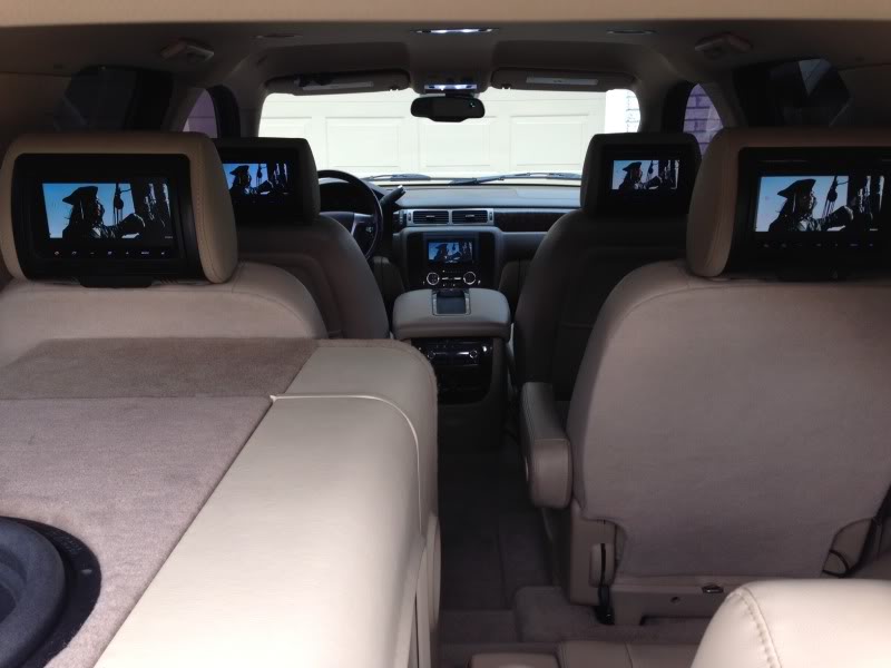

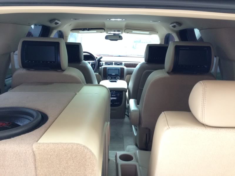

Added a 4th headrest LCD so my woofer can watch movies now too
honestly the only reason I did it was because that remaining headrest wasn't shaped like all the other ones and it really bothered me (OCD)
I'm gonna just remove the headrest on the 3rd row...
NathanJax
NathanJax
Vacation Nathan
May 9, 2009
49,141
943,577,203
Jax, Fl
All 5 screens on and playing the same thing. The 4 headrest have speakers built in as well as IR for headphones. I can also play something completely different on all 5 screens if wanted/needed.

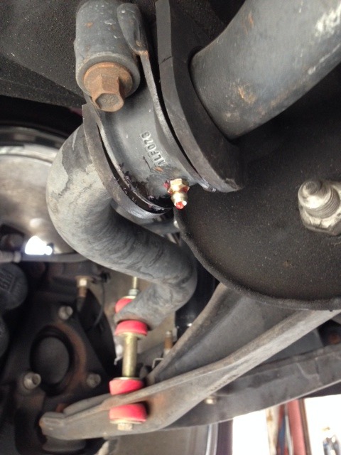

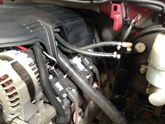

Installed my catch can from CatchCans.com

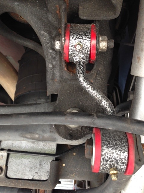

And also installed zerks fittings for all my suspension parts. Now and can grease the front and rear sway bar bushings and the rear sway bar end links

Looks good Nathan
You have you take the parts off to drill them correct? What size bit?
Nope, not if you're careful. Once you get past the bracket, you'll just keep going in to the rubber till you hit the bolt. go very slow and take your time and it's fine.

where did you get them shorter sway bar link for the front? I been looking but don't know where to find them at
Also what did you have to do to add them zerks to the sway bar bushings?
Napa or any auto parts store.
Drill a hole in through the outside metal and through the rubber and then bolt in the fitting.
LoHoe
Oct 29, 2012
211
For the sway bar link is their any specific make and model to buy? I went to autozone and bought the sway bar links for the front of my Tahoe. They was way to long and would work out.
---------- Post added at 10:28 PM ---------- Previous post was at 10:14 PM ----------
I think I found them
http://www.autozone.com/autozone/ac...-end-link/_/N-25we?itemIdentifier=449728_0_0_

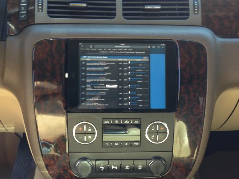

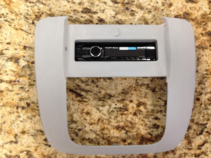

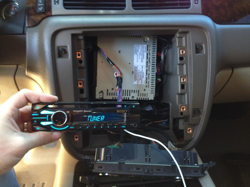

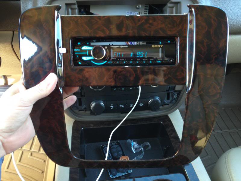

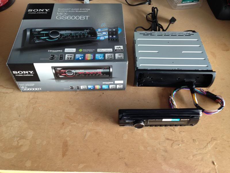

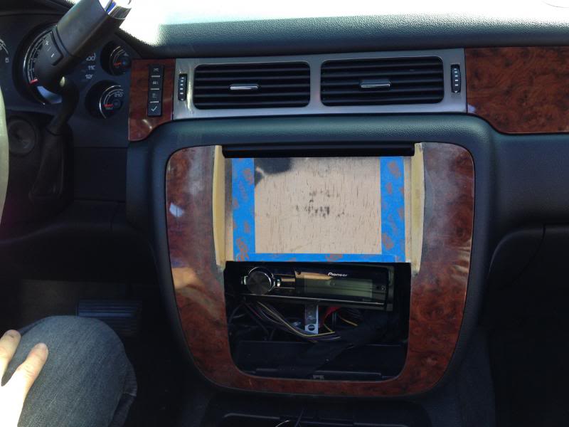

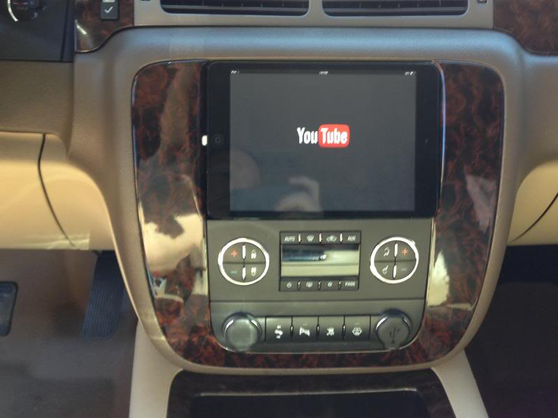

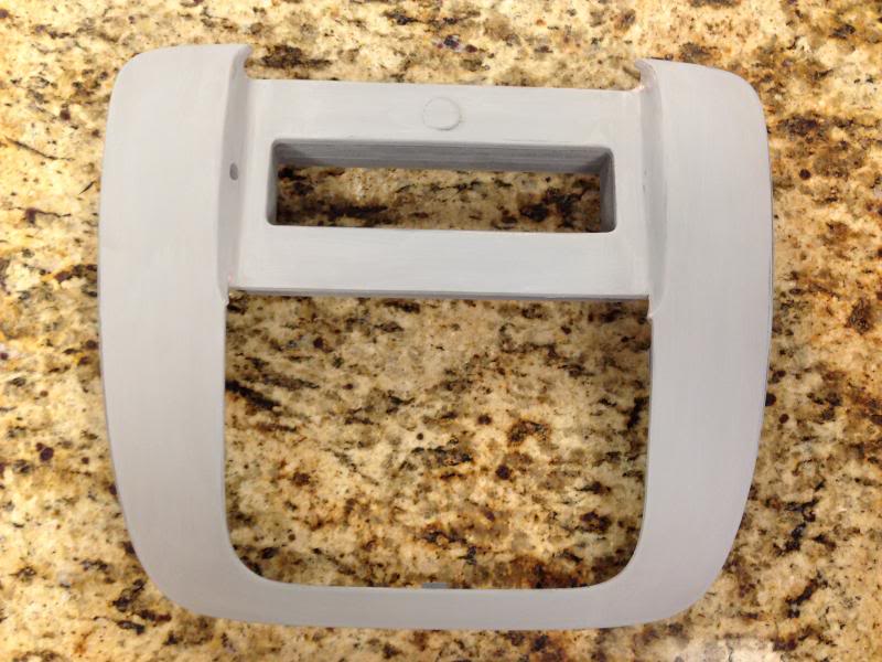

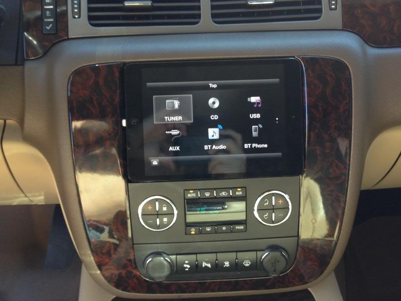

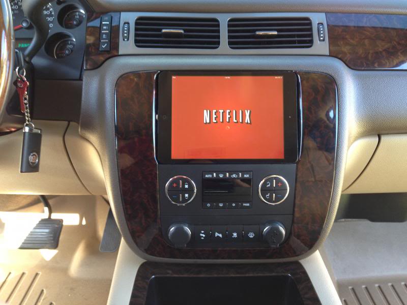

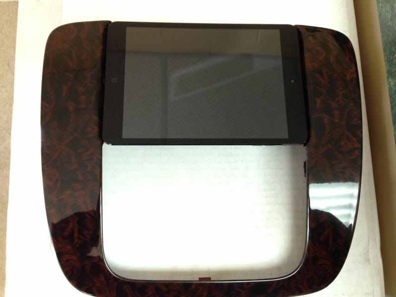

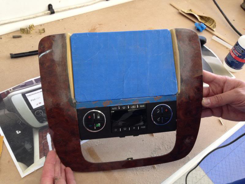

So, this has been going on a few weeks now. I molded an iPad mini in to my dash. I used a Sony MEX-GS600BT radio because Sony has an App I can use from my mini's screen. Steering wheel controls, Phone BT for calls and audio works, everything works like an OEM radio. I have a video I'm uploading to see more. The mini has AT&T service so I get full use of everything while driving. Internet, Netflix, Maps, etc. It's charged when the car is on and held in by magnets and I can slide it out at any time if needed. When I slide it out, we put the radio faceplate behind the mini. But we soldered wires from the radio itself to the faceplate because the radio won't fit that far back behind the iPad. Not that I'll take it out much, but it was just something to do for the looks.
A few questions already.
- I've got a black lightning to USB cable on it's way so that white one doesn't stick out.
- I lost my backup camera, because the iPad doesn't have an input like that. I have the 09+ rear view mirror with LCD back up screen coming.
- I lost the output from my head unit to my 4 headrest, but I think I have a solution for that. For now the headrest have built in DVD players and inputs I can hook up my iPod Touch to.
- I also lost my USB dash plug, but I got that back working, but only to charge stuff, not for input. I'll show that in the other thread
I'm actually leaving on vacation in a few minutes, but I'll try to get the video uploaded later.
The main screen
This is the Radio app that I can change the inputs, listen to the radio, etc.
Maps
Internet
YouTube
Netflix
And yes, even my air ride can be controlled through an App with Accuairs i-level

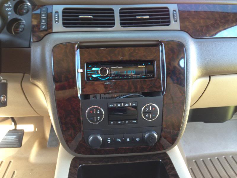

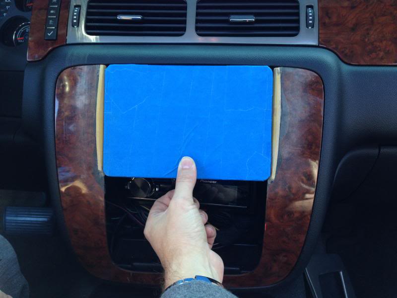

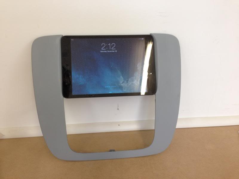

Here's what it looks like when I slide the mini out
And here's some install pics. We used my friends Yukon to mock everything up and I had it hydro-dipped to match the Denali dash almost perfect.
