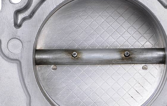

Whistling: Take the smallest pieces of electrical tape you can use for this, and tape off the holes in the throttle body. The reason for electrical tape and small, is that if it dislodges, it's small enough to burn in combustion without causing other issues. Scotch tape would also work. Just don't use something fibrous like duct tape. Not really any directive in this one, but it'll tell you if that's the source of the whistle. Some aftermarket throttle bodies either exclude these holes, or have a different orientation of them that can quiet it down if it bothers you. Reiterating that fuel trims are a great spot check if you suspect it's a vacuum leak
