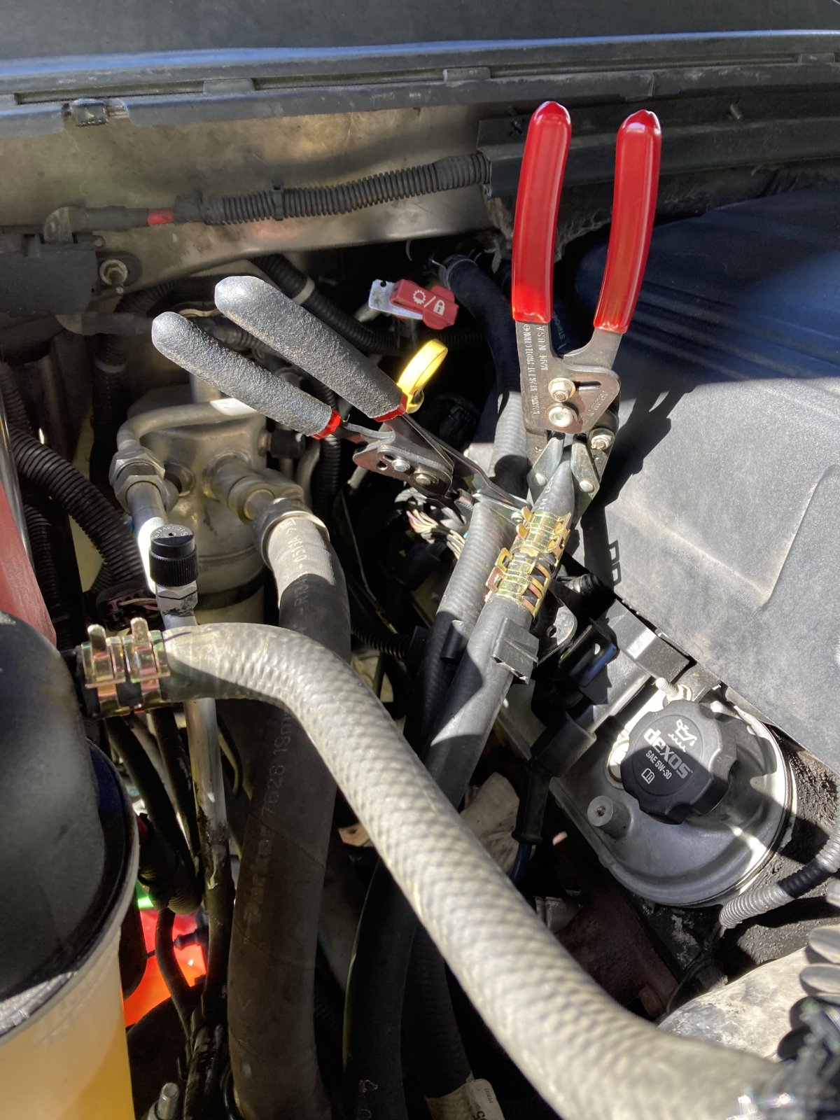

Yup carry extra coolant and I also have a barbed fitting spliced into one of the heater hoses with double clamps so I can bypass that whole she-bang in an emergency failure if it comes to it.
