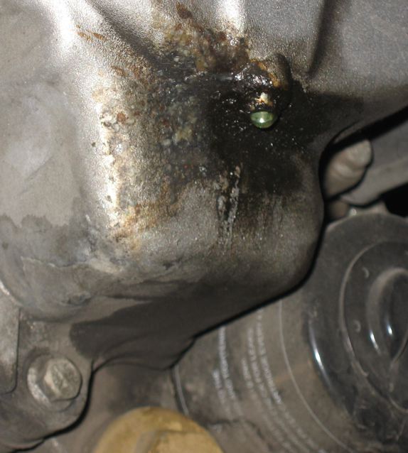

Mine had a similar problem. I would have to refill the reservoir about once a week or about every 150-200 miles. I FINALLY found that it was dripping from the weep hole on the water pump. But it was evaporating as soon as it dripped onto the hot engine, that made it extremely difficult to find the leak. Once I replaced the water pump it was fine ever since then.

Drive it for less than 5 minutes, and then fully inspect it for leaks. That's how I finally found my leak. Once the engine gets hot, it literally evaporated as soon as it dripped out. But taking a drive around the block and then inspecting it, sure enough I saw an actual wet streak running down from the weep hole on the water pump. I was adding coolant about once a week for over 2 months before I finally confirmed 100% that it was dripping from the weep hole in the water pump.

Here's my update. 2005 Z71. Had a coolant leak. Reservoir was always slowly draining last 6 mos. took it to local repair shop. Pressure test, all good. Pulled plugs to see if coolant was leaking into the engine, nope. Checked heater core, all good. Car wasn't running "hot", nor was there ever a puddle of coolant under my truck any morning, nor did I smell coolant. Total mystery. I just kept monitoring.
Then, over Christmas, I went skiing. The temp change must have effected it, because now I could see it leaking from the water pump. Best guess is the metal contracted in the cold and cracked a gasket or something.
Repair guy told me that I undoubtedly had a slow leak and the drops would burn off on the hot engine before I could smell it. Excess drops would land in the skid plate.
So, I would check the water pump. Mine lasted 135k miles.

Look at the weep hole. If there is any greenish/orangeish crud around it, Your pump has been leaking. Replace it. Same goes for the water pump gasket. Check the perimiter of the water pump for the same residue. This residue is what is left over when the coolant burns off. If there is no residue around the weep hole or water pump gasket, I'd stop looking at the water pump and start looking into whether you have Castech heads or not and/or looking at the or head gaskets.
