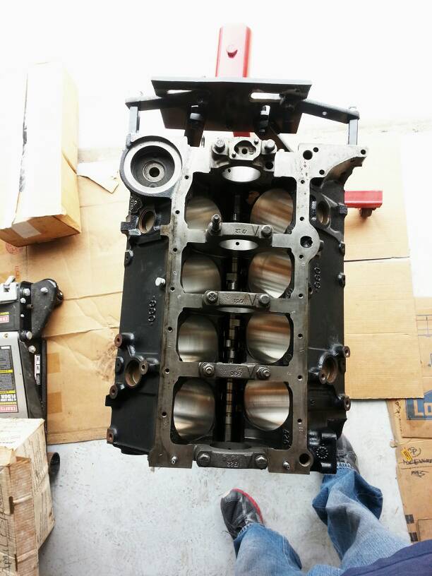

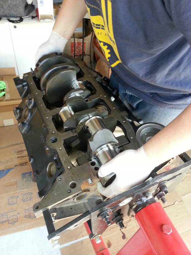

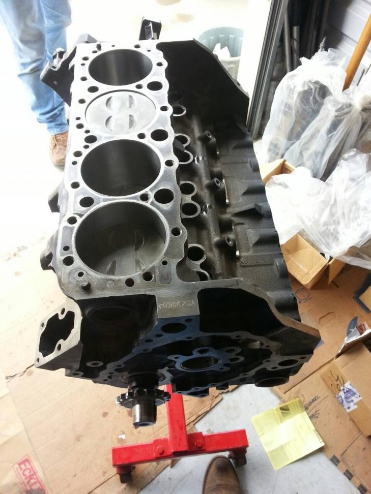

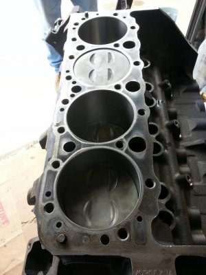

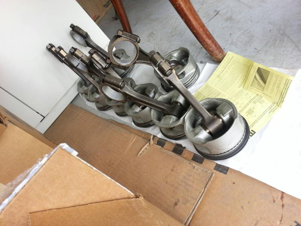

Hey guys just thought I'd share my project. It's a rebuild of the Vortec 5.7 in a 99 2dr Tahoe. This was a budget build and I reused a set of pistons and rods from a grand sport corvette. Pairing that with an LT4 hot cam and ls6 valve springs. All in all its been a fun project with the exception of having to helicoil the crank.

Yes they are short skirted. I'm thinking that the stocker that's still in the truck and broken may become a 383. Picked up some SP hypers for $50 bucks on CL. Just need a good set of Vortec heads and might do an E85 beast.
