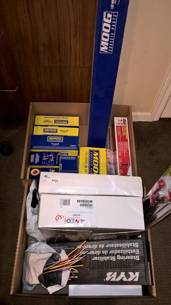

Still haven't gotten to the last batch of parts and I order another batch. D they have a 12 step program for Tahoe addictions? Since I already put a new pitman arm and gearbox in for the steering I ordered the rest of the parts for the steering. Got all Moog parts from outer tie rod end to outer tie rod end. Got new tail lights and the last of the parts to finish my denali console and get the subwoofer working.

Install a new Goodyear gatorback belt, new anzo led taillight assemblies and a new mode door actuator

Another batch of parts installed this weekend. Put a new idler pulley and tensioner pulley. Replaced the fan clutch and fan because the old one was seized up. Cleaned the throttle body and the MAF sensor and replaced both batteries with 800CCA Duralast Golds. While I was screwing around checked and charged the A/C.
