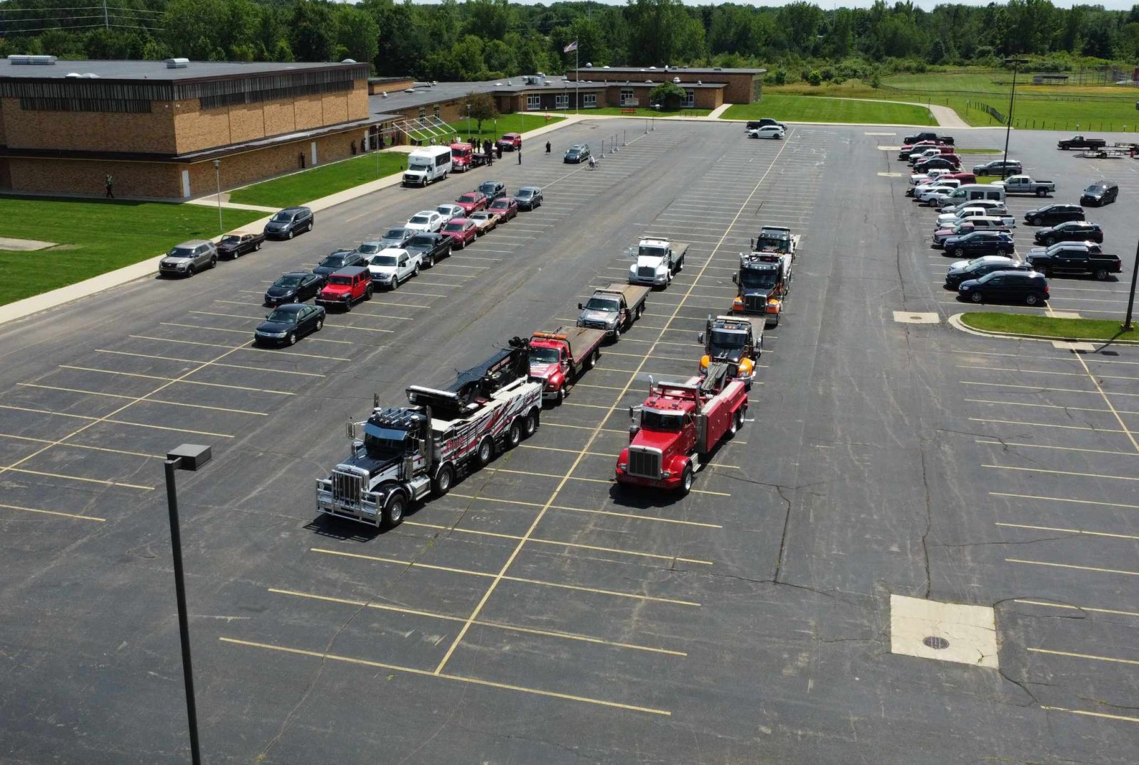

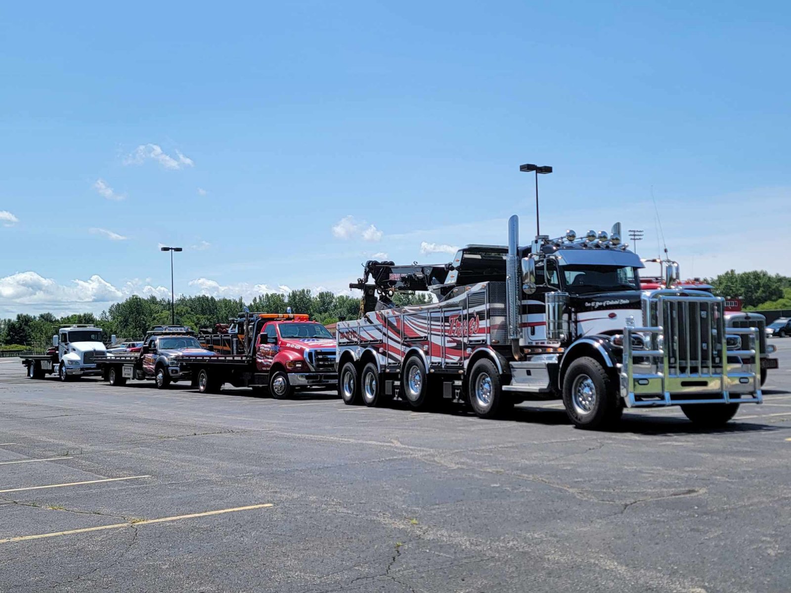

he was a mechanic and wrecker service for 30+ years, so we convened a convoy of trucks to lead the procession ( led by the county sheriff that was also a friend ) and and i drove the truck that took him for his last ride. it is our family friend that we have both driven for and was also like a son to him, and he drove dads car. ( pictured at the funeral home the evening prior at the wake)

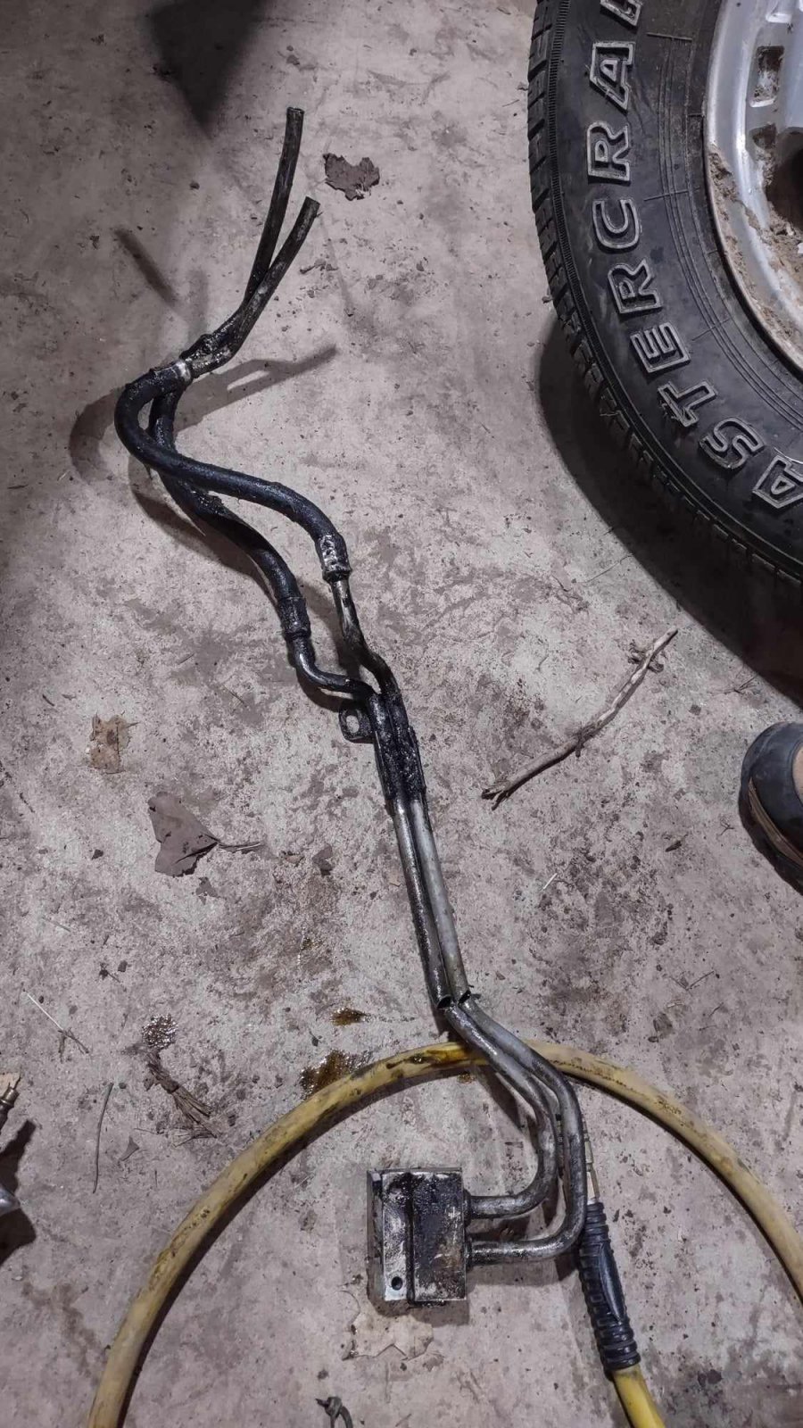

got the stupid cooler lines patched to not leak.
she drove it again and........ apparently fixing the lines stressed the old brittle plastic, and... tank leak!!.. right beside the fitting.
so i went cheap and got a cooling line block off. and figured to use the rad i took out of the avalanche when i scrapped it.

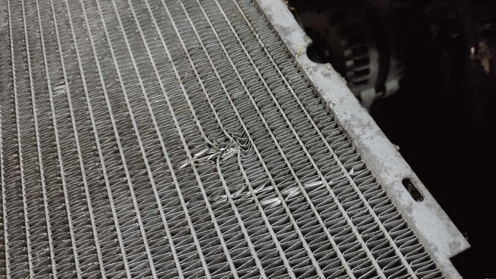

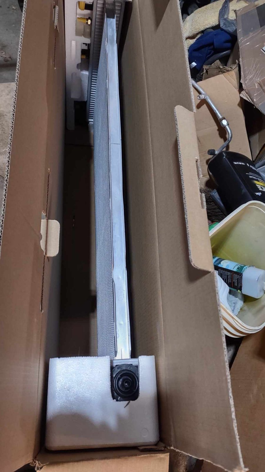

Apparently the clutch was also not great on the fan. But got the rad swapped and found a leak right away. Apparently it got bumped and damaged at some point
But also with the block off came out the lines. And those were a pain to get out.
But a new rad later, and back in business ......... Again.

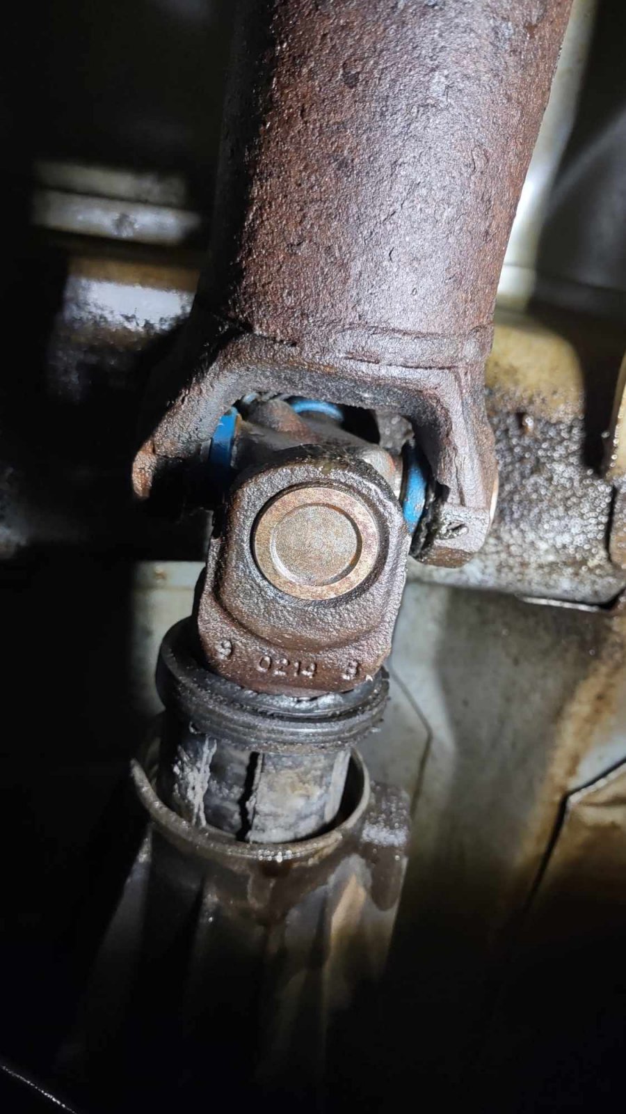

Or so I thought till she was driving and the yolk flops around in the back of the case. So. I had to source a used one. And more on that in a bit.

I am about to do the oil cooler lines on a 2018 Suburban and I have found some research that says to loosen the front diff and let drop down for clearance to snake the block out and in.

It was a bit of a wiggle, and I had cut the front of the lines repairing them , and got them wedged and bent them pulled some more. But I knew I was trashing so didn't care. Everything was covered in oil and such , it took me longest to find the stupid bolt on the front holder, as I could see it.

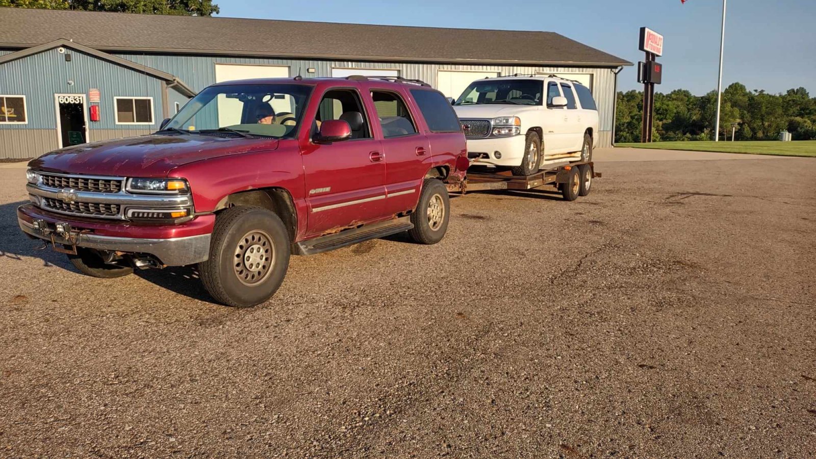

So, made the Tahoe keep doing work! With the case being bad, had to get it home. More on the Denali in a min.

Yea, that holder/clip on the left front side of engine, holds the lines before they go across the front of engine to attach at radiator, is also easier to access when front diff is dropped.
The videos I saw, about dropping diff, show either leaving bolts in, 2 of them, and dropping that much or pulling both bolts all the way out and dropping the diff further. But then you have to fight the diff weight to reattach/start the bolts.
