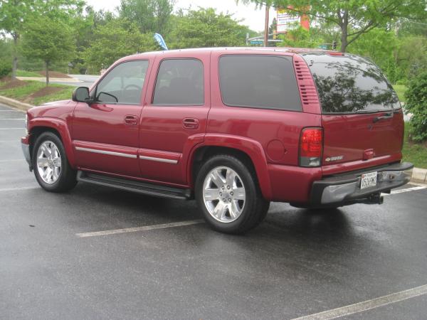

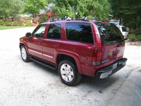

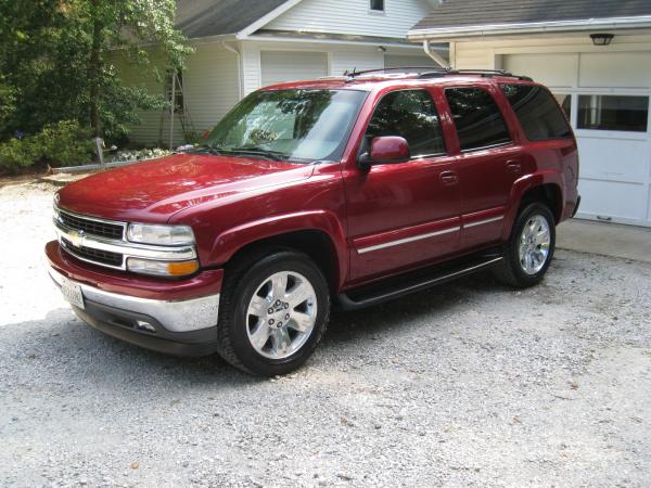

Here it is BEFORE:
Here it is AFTER:
BEFORE:
AFTER:
BEFORE:
AFTER:
