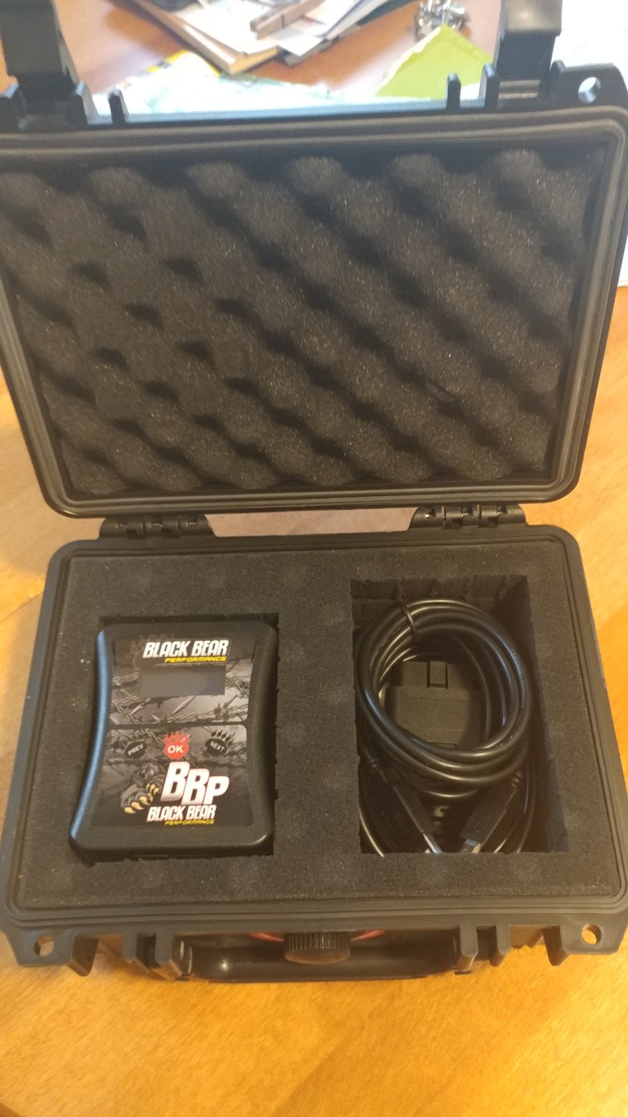

Anyways, the only update so far. So when you order. Blackbear offers to send you the autocal in a nice case.
The only reason i opted not to, is im pretty cheap. And... i had a few cases i bought on sale at harbor freight that do the same thing.
So, here is that.

Which case did you get? I bought the small one thinking it would work but was a little too small.
cmc76
cmc76
Sep 5, 2014
685
314
The small one. If I did it again I'd go bigger. But it works as is

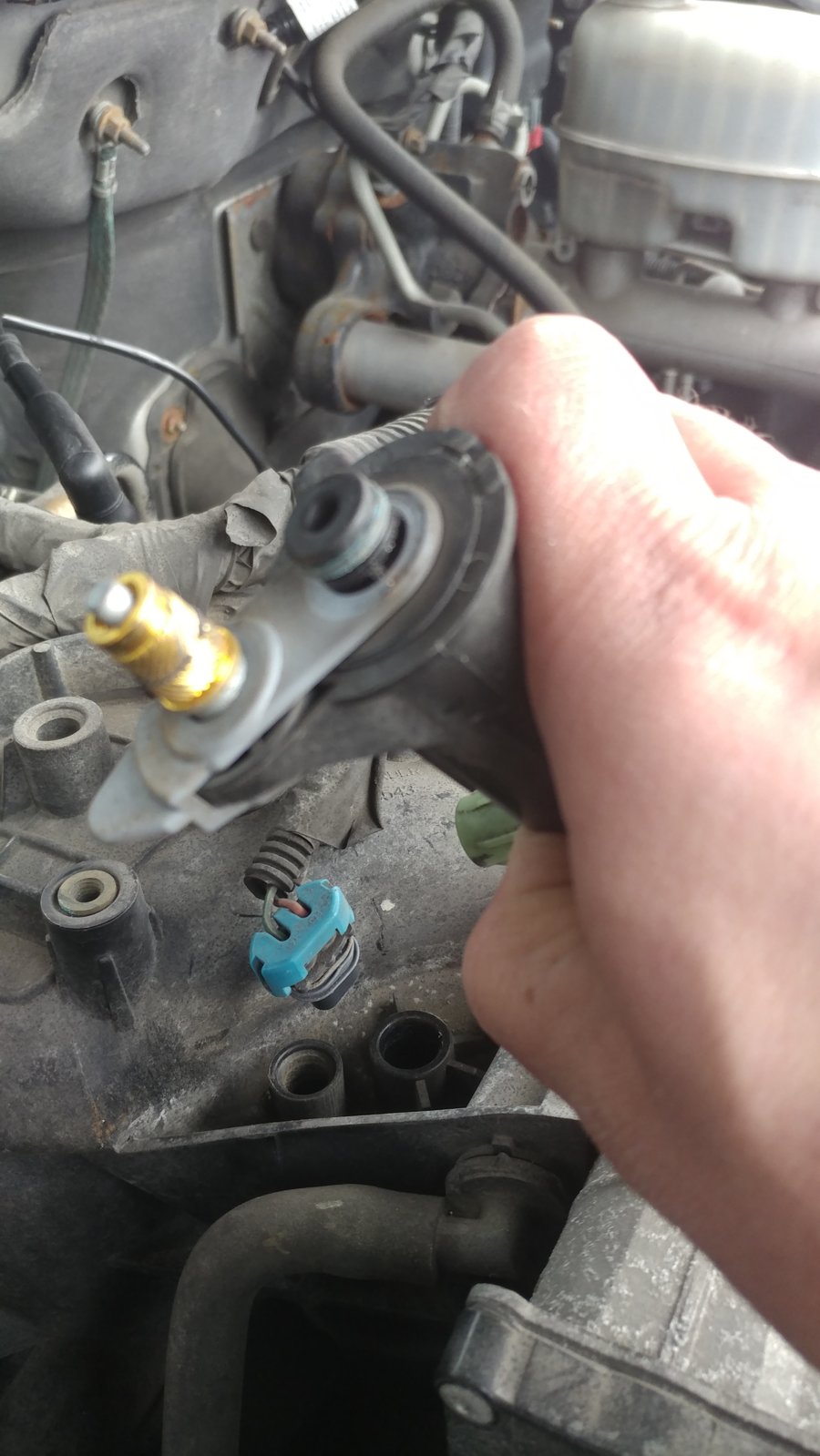

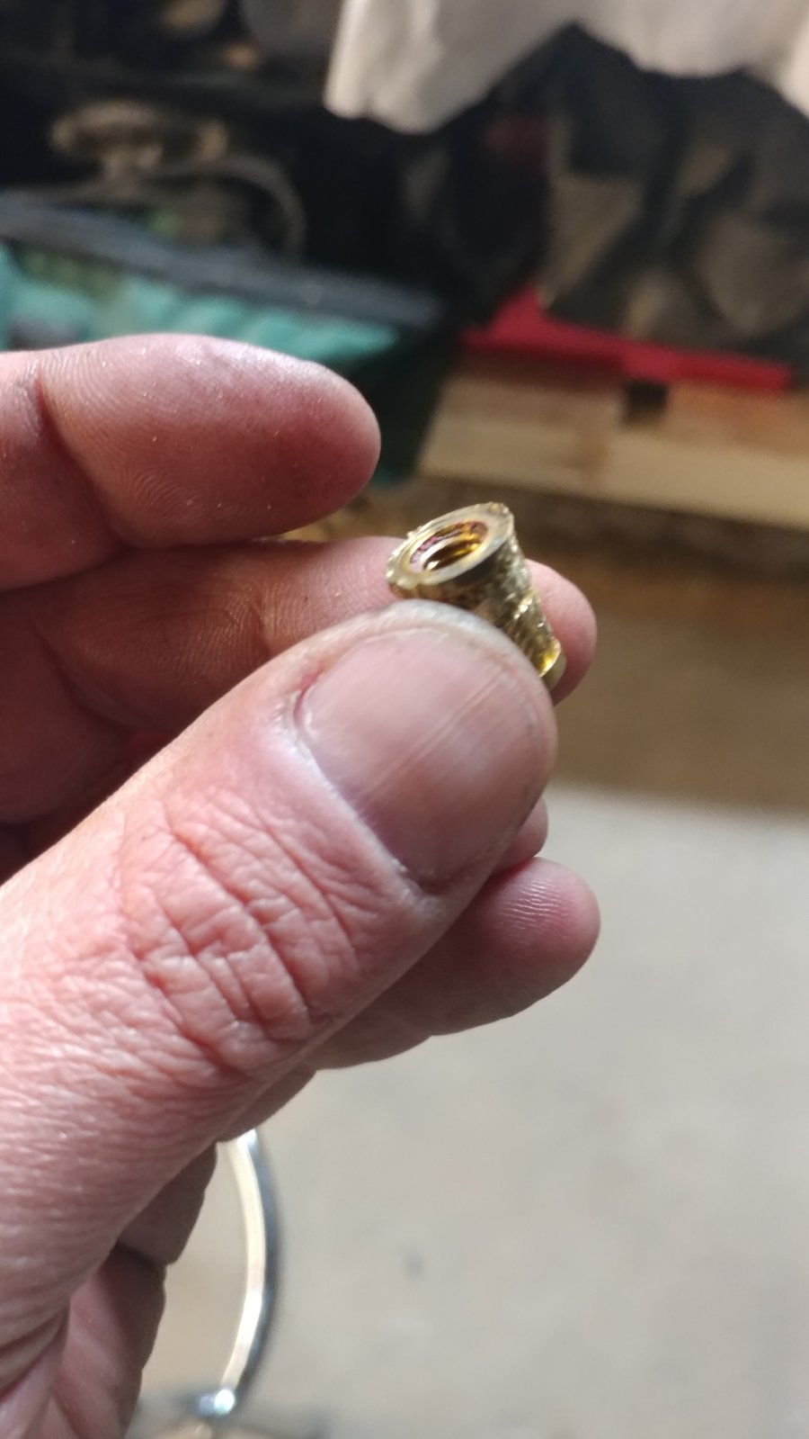

So other than this loose purge solenoid. I cant find any leaks. I finally got it out .The tiny brass insert had spun in the manifold. I'm going to try to epoxy it back in. The solonoid wasn't snug .Could have been losing pressure.
And i pulledmy floor mat out. Sure as shit was blocking pedal travel. Wtf?
