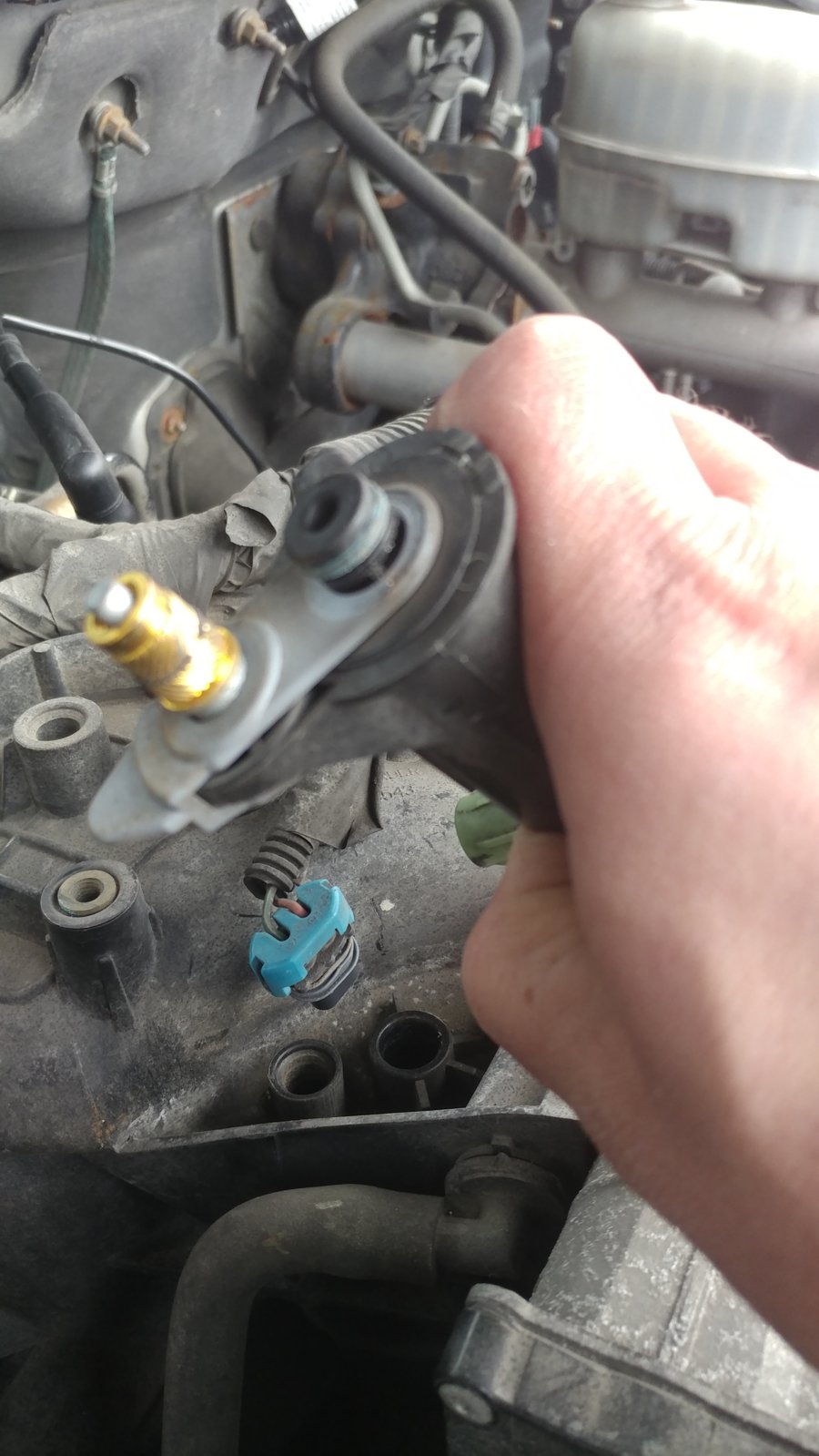

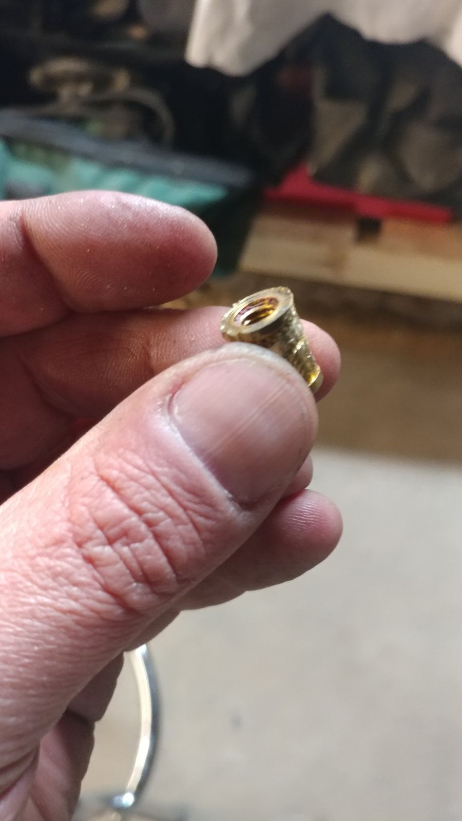

So other than this loose purge solenoid. I cant find any leaks. I finally got it out .The tiny brass insert had spun in the manifold. I'm going to try to epoxy it back in. The solonoid wasn't snug .Could have been losing pressure.
And i pulledmy floor mat out. Sure as shit was blocking pedal travel. Wtf?
View attachment 196675 View attachment 196676

So I got the brass insert to hold .Snugged the purge thing in. Went for a few hot laps. Floor mat removed.
I do think I was losing out on some pedal travel.
As for the vacuum. We will see what Justin says .

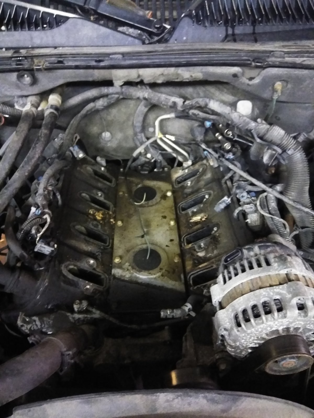

So the intake gaskets are done. Got the drop springs in too.
Since its snowing....again. Ill put off logging files for the day. I doubt it will make much adjustment. But this way BB can see the files without a massive vacuum loss.

Mechanic thought so. I was on the fence with the smoke machine. But he seemed sure. So I did them. Should be able to tell tonight if the bank 1&2 codes are gone. In addition ill re scan and send logs .Its too icy tonight for hot laps.
52,949
When I had intake leaks after installing my blower, I pulled it and it was obvious where it had been leaking. The rubber gaskets were easy to see where the leaks had been.
