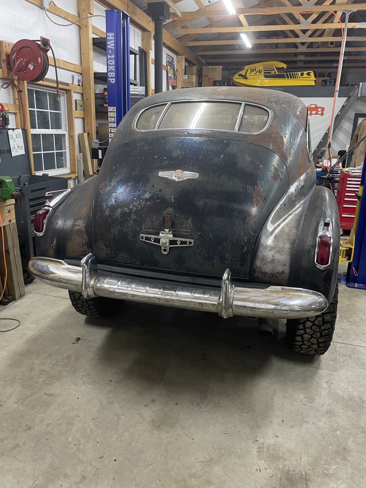

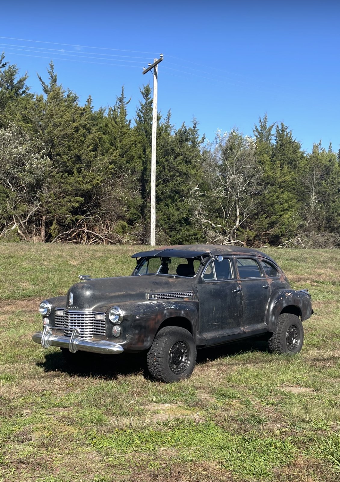

My 08 Yukon is shaping up…..1st time moving on its own under a 1941 Cadillac body

My 1941 Cadillac on an 08 Yukon XL

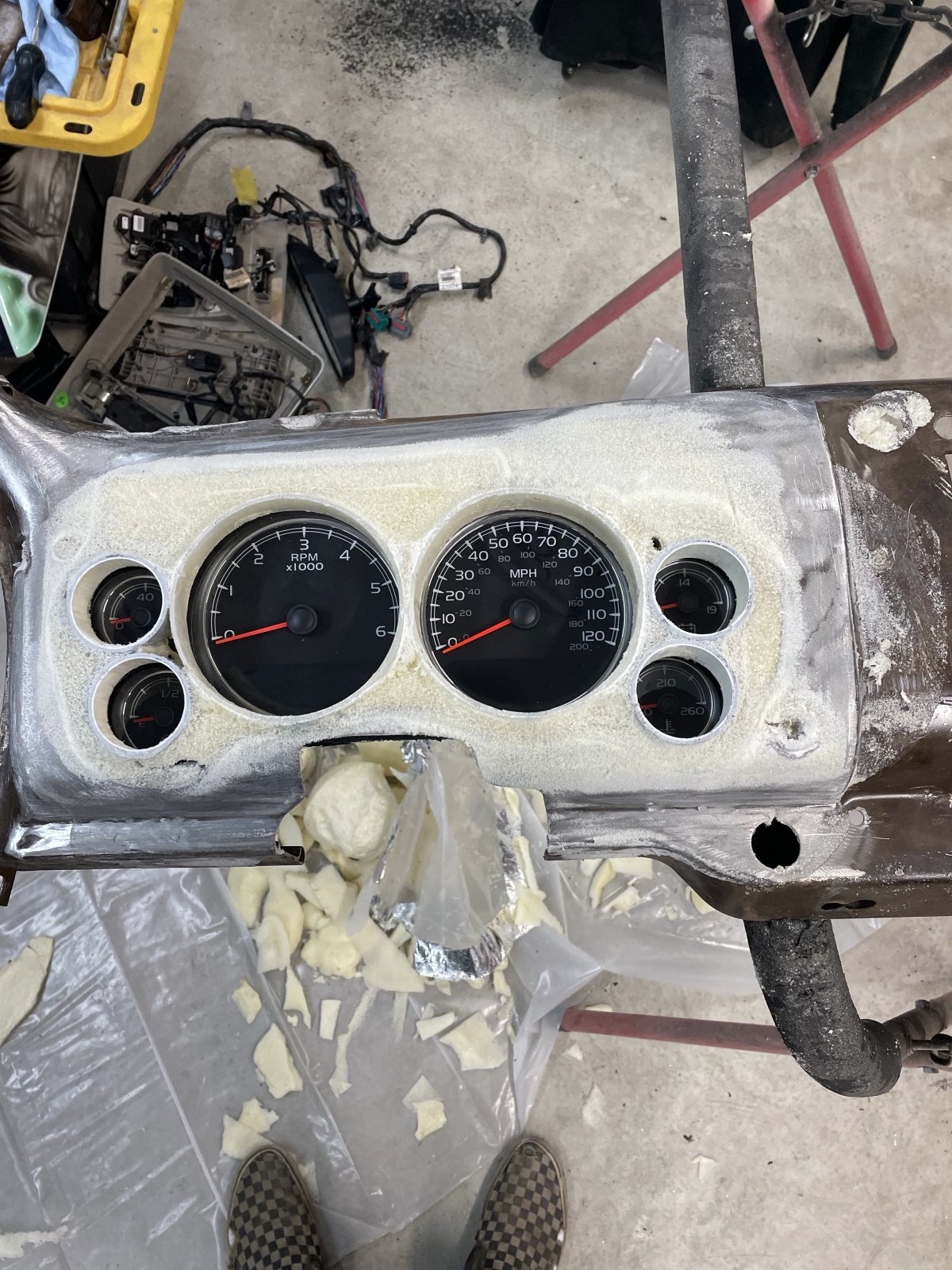

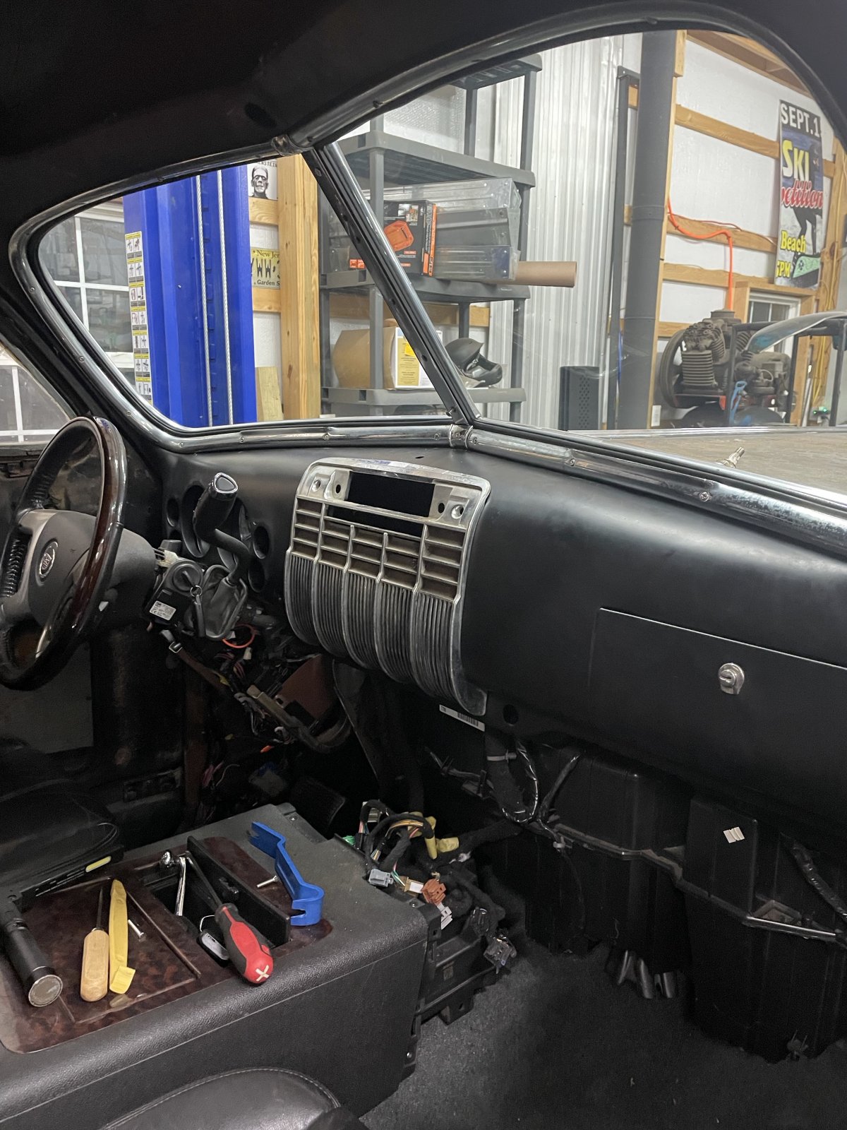

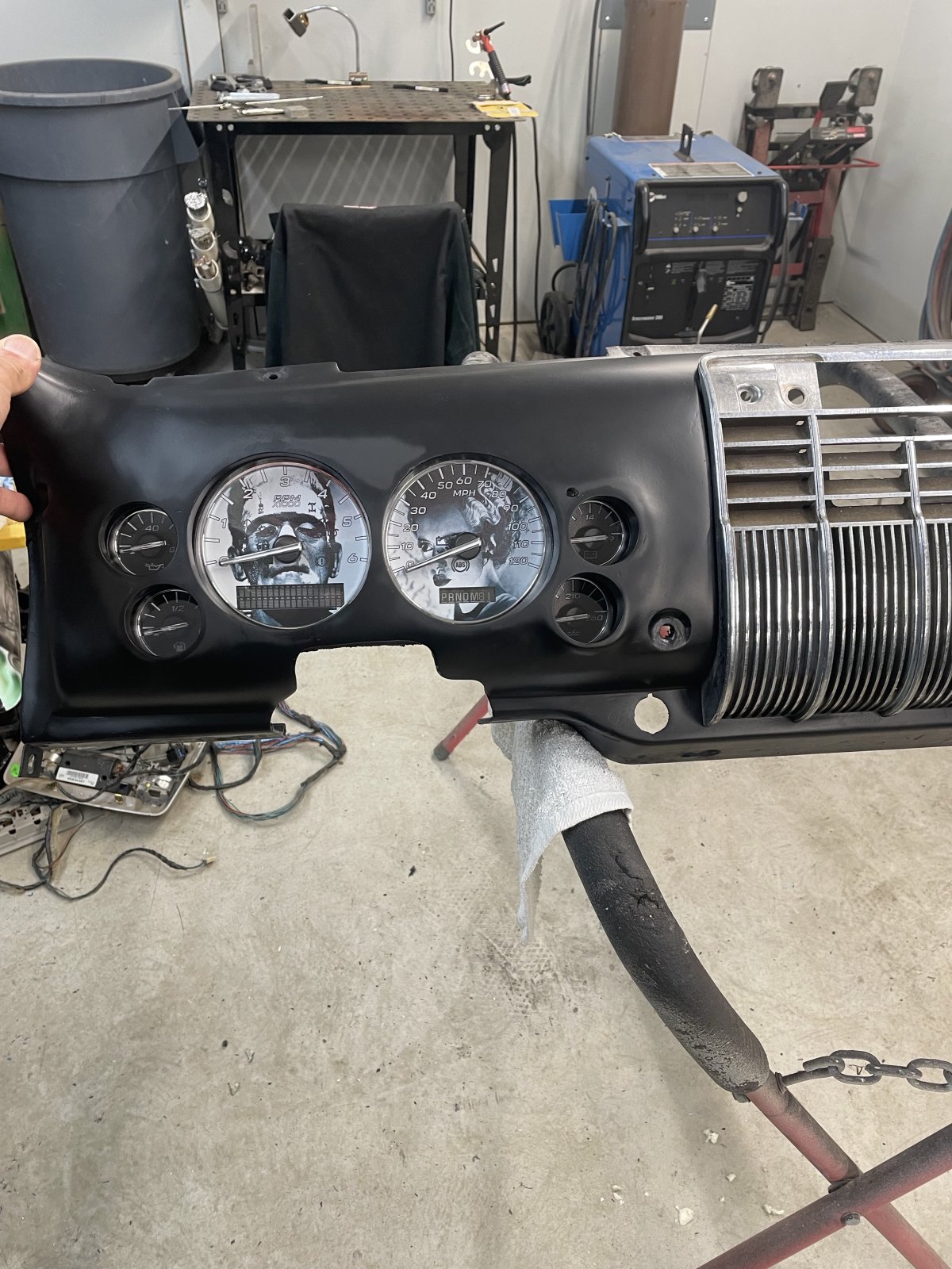

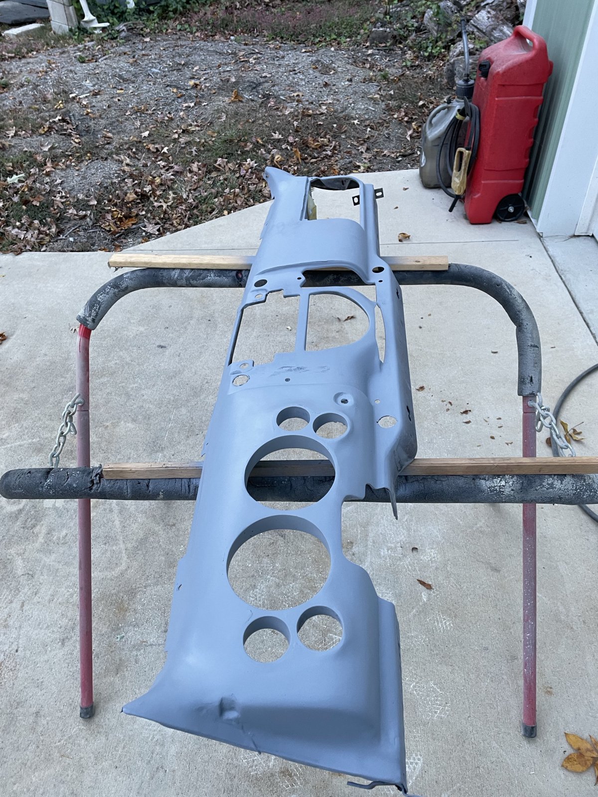

Modified the dash to make the Yukon gauges look like individual steam type gauges….oh, and added a little Frankenstein in the mix :)

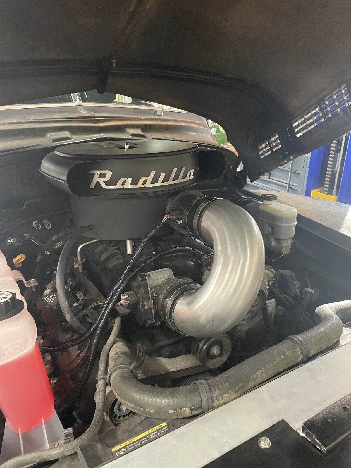

Here’s a Yukon intake you haven’t seen before ;)
I used a 50’s Cadillac “Batwing” style air cleaner and created a plenum below it to duct in the intake elbow. It’s sort of a statement piece for the engine compartment, and of course it had to get a laser cut stainless steel “Radillac” emblem.
