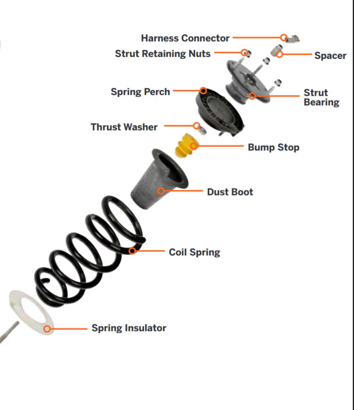

I’m pushing 180k+ on the original suspension in my 09 Esky. Here’s a list of parts you need to rebuild the z55 front struts w/ OEM, guaranteed for life GM struts and the ancillaries. It’s $1.2k.
If you want want to replace all the bushings and control arms with steel or aluminum, it’s another 2-$3h more.
Here’s the list of all the part #’s from RockAuto. You’d need z55 struts for the Denali. Z95 for the Esky are listed below
You’ve only got to do it once the right way with a lifetime guarantee on factory struts. Jerry-rigging parts and sensors for an economy ride means you’ll be doing it again & again and have your top speed limited to 88mph or override the stability system at your own risk.
