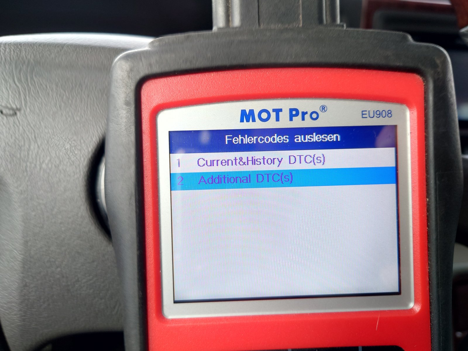

I use a Chinese device to read the OBDII codes. This device contains all cars of the world and is mostly very helpful. What is new at GM, which I never seen at another manufacture is, I have two sections where errors are stored, like you see on the attached pic.
One is "Current&History DTC(s)" where i have the error which comes from the EVAP system and which lights the motor lamp.
And another section, which is called "Additional DTC(s)", is where i have the rest of the errors.
My guess is, that the Chinese guy, who programmed the software, made a mistake in translation and these are historical errors, because if the Mass Air Sensor, the MAP and all Oxygen Sensors would not work proper, I should have a bad running engine and I could for sure, not pass the emission test last week. And as well, a non-working mass air sensor should result in a luminous engine lamp, but it doesn’t. And there is as well the error with the coolant temperature. Today I looked at that. The motor temp is after a few kilometers on 100° Celsius (about 212° Fahrenheit) which is middle of the gauge. So i think that should be ok..
