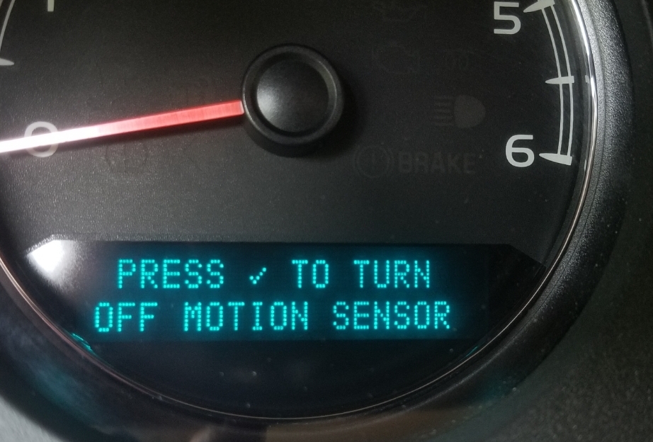

Unless I turn off the motion sensor when prompted upon shutting engine off, the alarm will go off not too long after I lock it up.

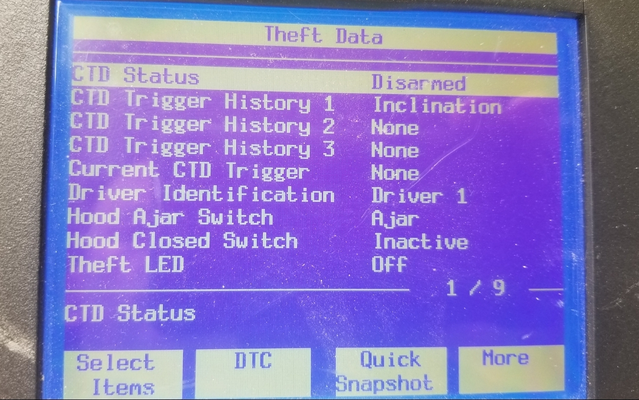

The Tech 2 also shows that the alarm is triggered by the "Inclination" , no other triggers.

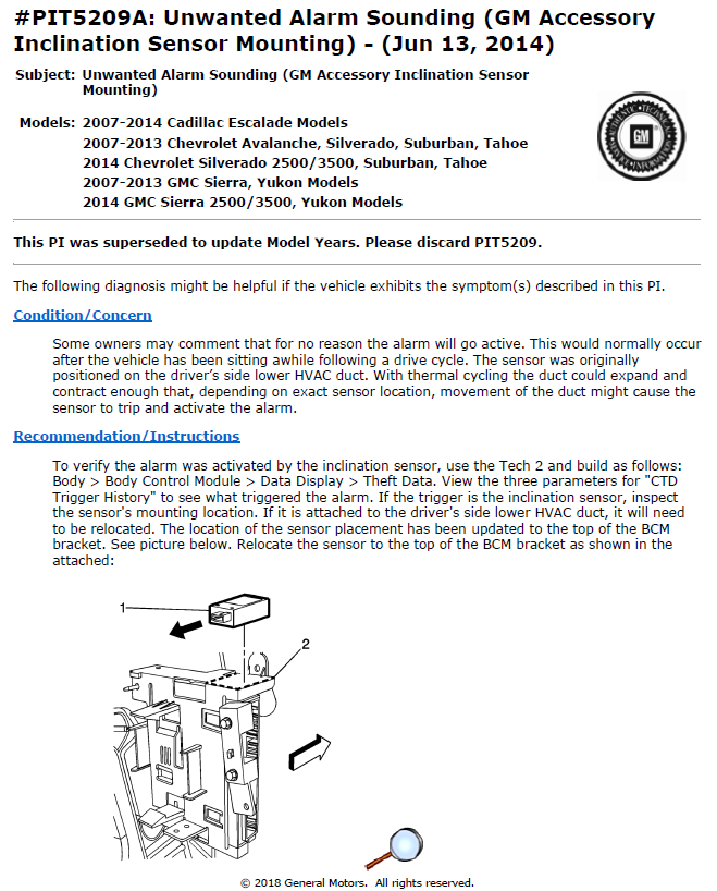

info from GM about that sensor. I just disconnected it. It is on top of the footwell airduct. thermal contraction/expansion can move it. The document says to relocate it on top of the BCM bracket. Image shows top-right side on bracket. No adjustment that I can see.. (Have it on my workbench, might pop it open and see...)

It could be your neighbor's remote control or something else. Did you install this or did the truck come with it? If it was an early installation the sensor was installed on an AC duct and it should be relocated to the top of the BCM. This is a GM Accessory, 22962507, not a factory installation, and had to be programmed to the truck.
This sensor does not have an adjustment on it. The "shock" sensor does. If you have that one, it is taped to the main wiring harness under the dash.

Tech 2 display:
Note, I did have my hood open when I took this pic.

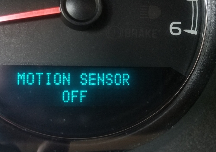

DIC message when turning key off:
So I do...:)

Ok, someone previously had at least the inclination (tilt) sensor installed. The hood sensor is factory. Let us know after you check tomorrow.

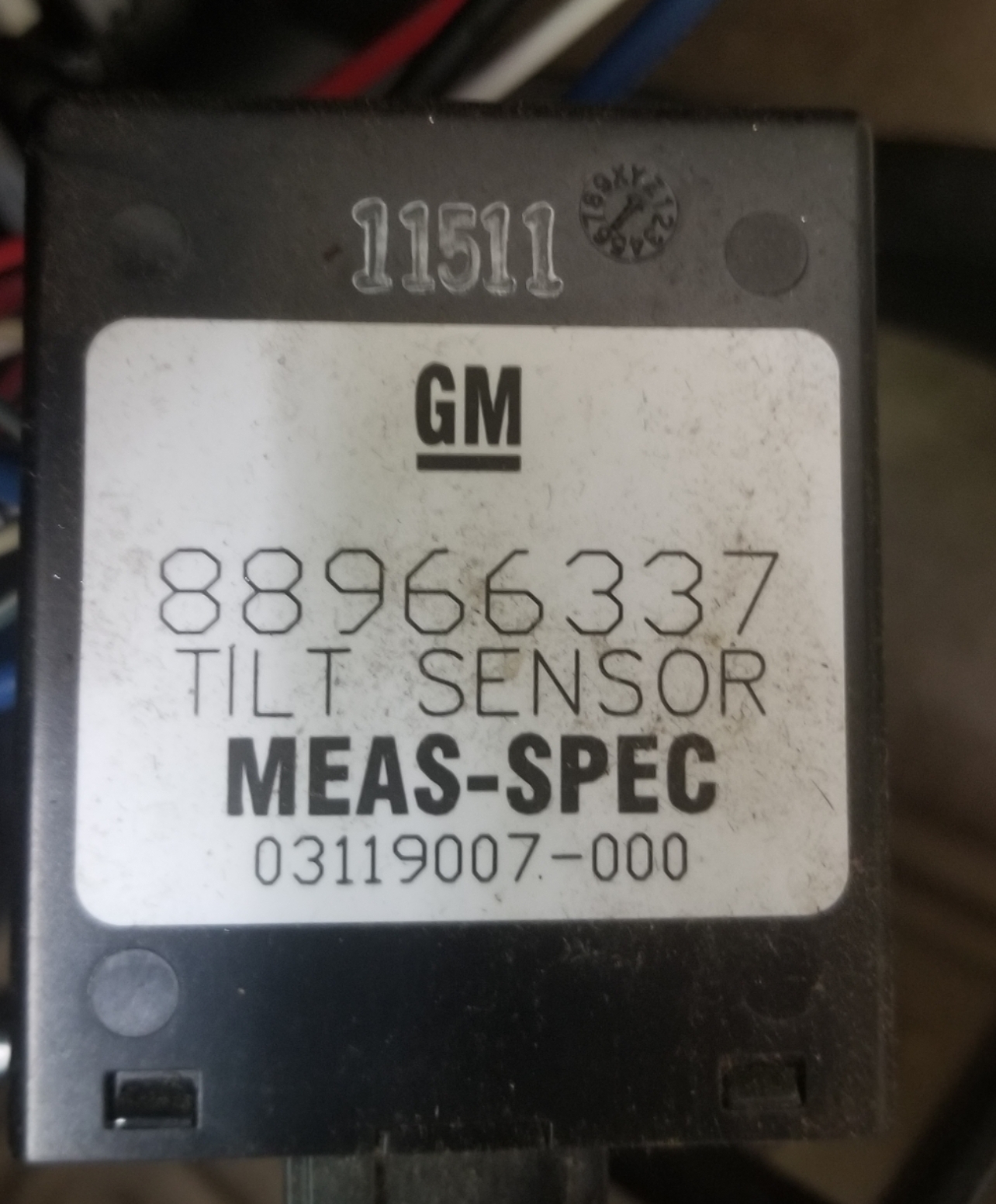

Sorry for the delay, I was thinking I had to pull panels down so I put it off due to extensive yardwork and some weather.
Low and behold, it's in plain view.. lol.
Yes, it is on top of the air duct, I have it removed now and will relocate.
It seems to have a liquid inside so I agree, temps could easily play a part with thermal dynamics.
