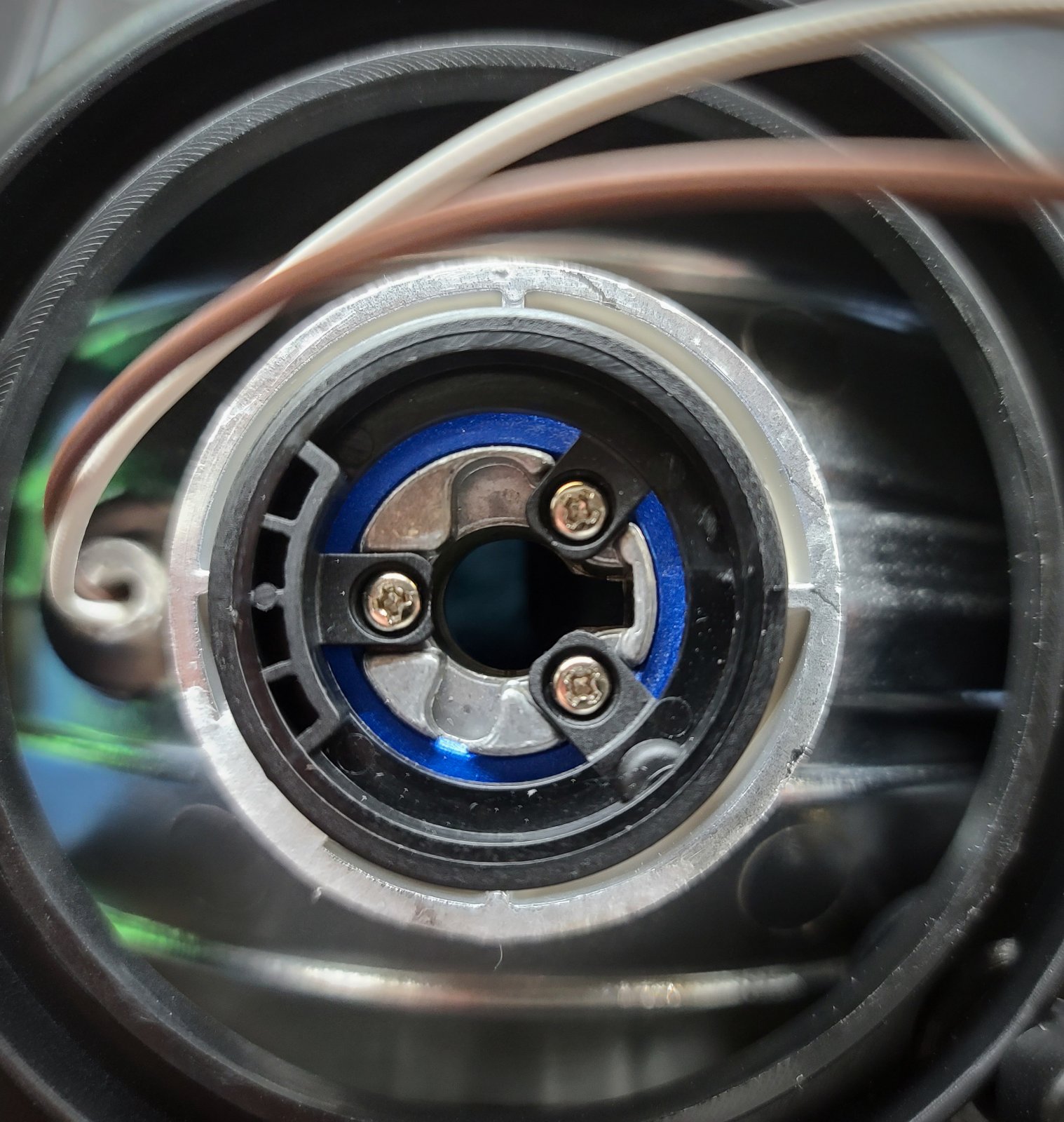

Before you are ready to proceed from here, you need to modify one more thing. That hole where the deflector was mounted, you should drill that out with about a 1/8" bit. You'll be feeding two 20ga wires through there for the solenoid to activate the armature for "high beam" activation later.

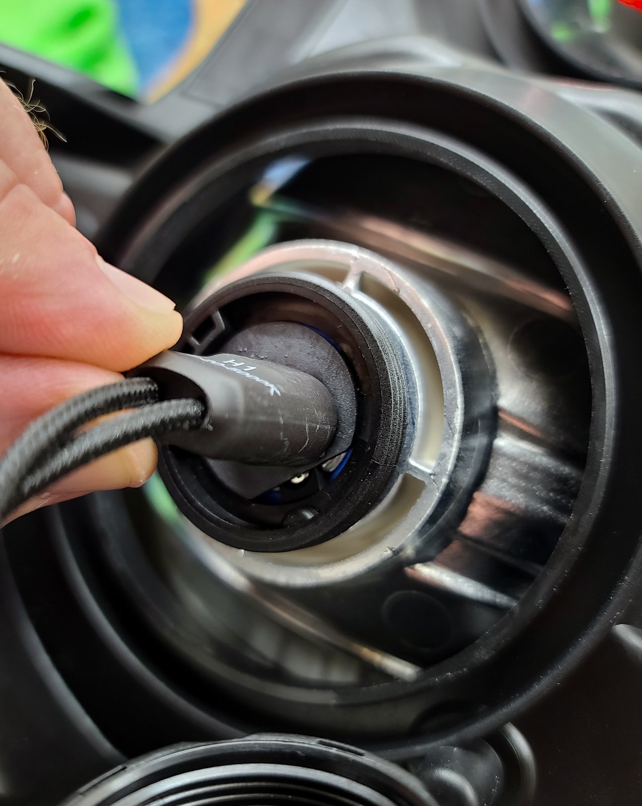

Here is the assembly of the later style projector. Once the projector is set and locked in (not too tight, so it can be rotated to level later), start the assembly. This black plastic ring allows for the newer style dust cap to be threaded on.
The bulb fits in....

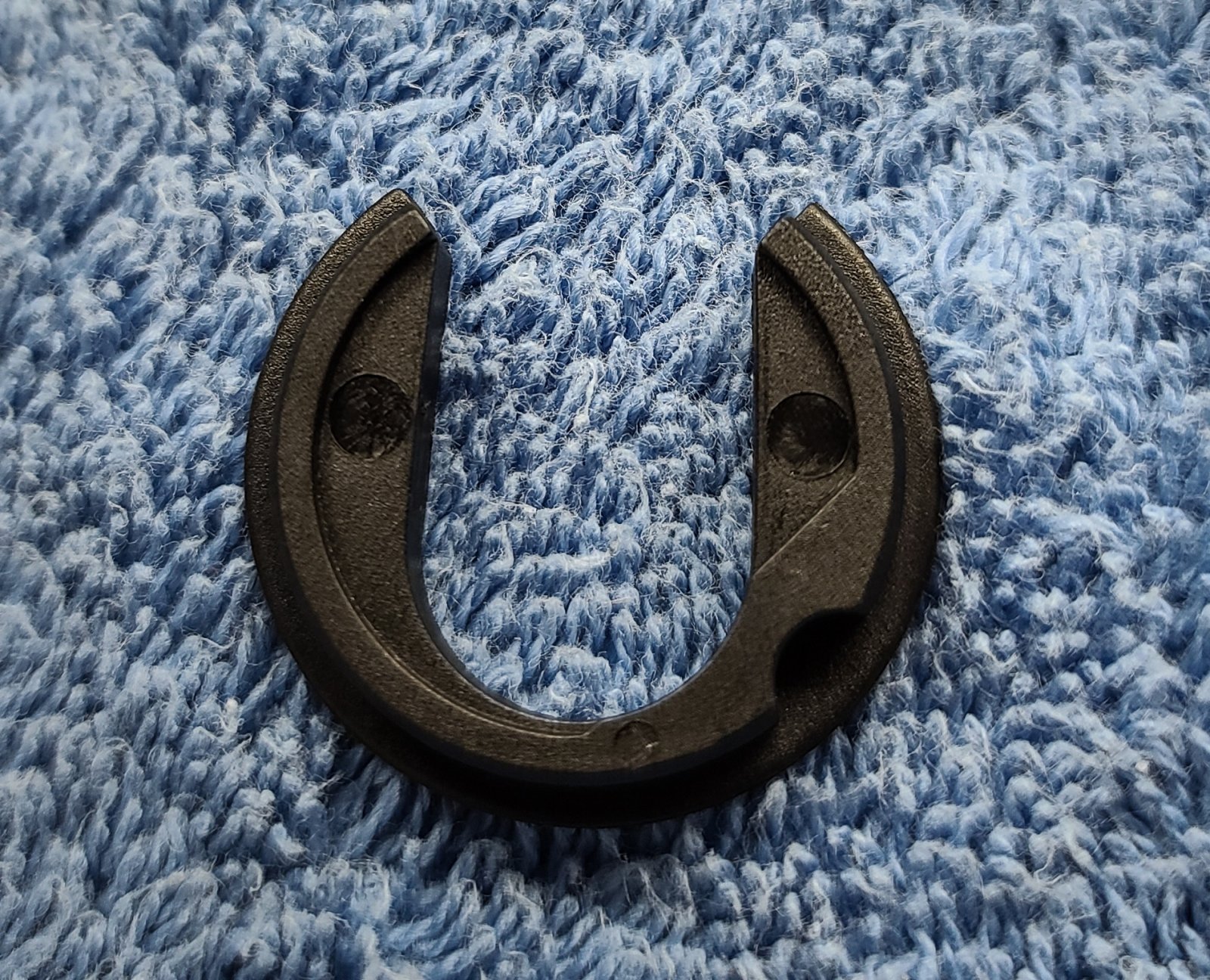

This horseshoe clip fits in and sits flush, it keeps the bulb in place. Pretty cool.

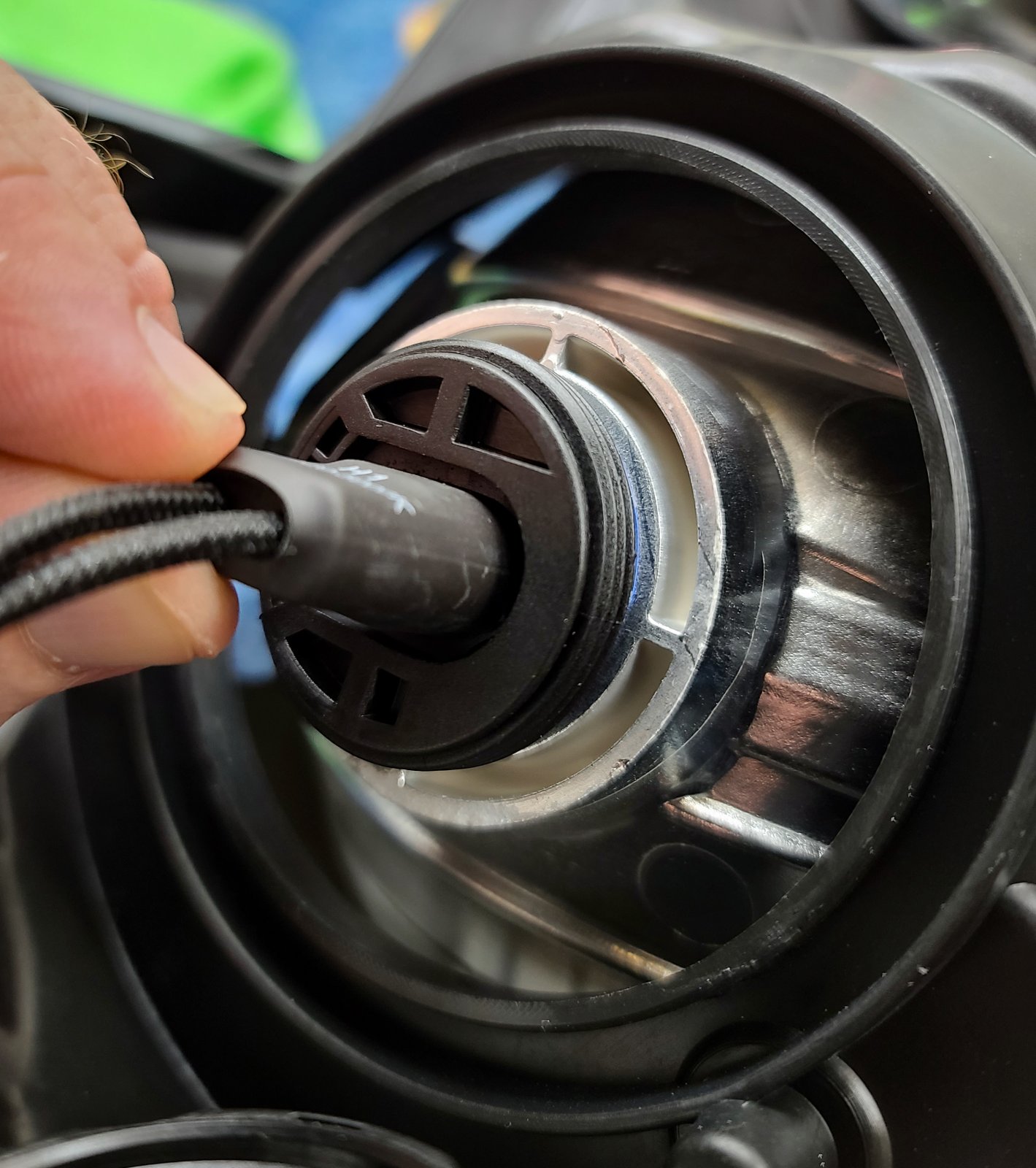

Clip installed....

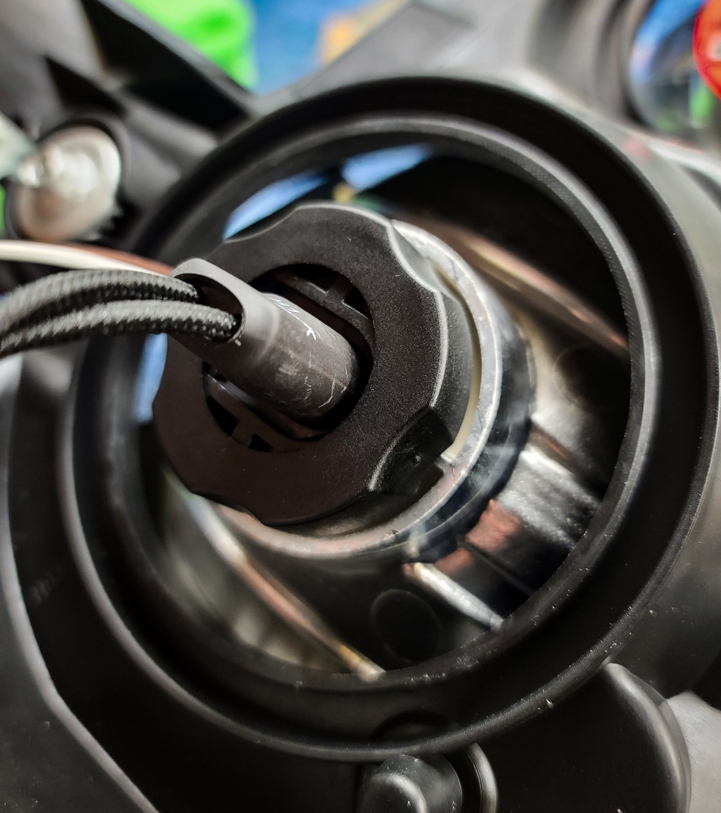

And final step, the dust cap installed.

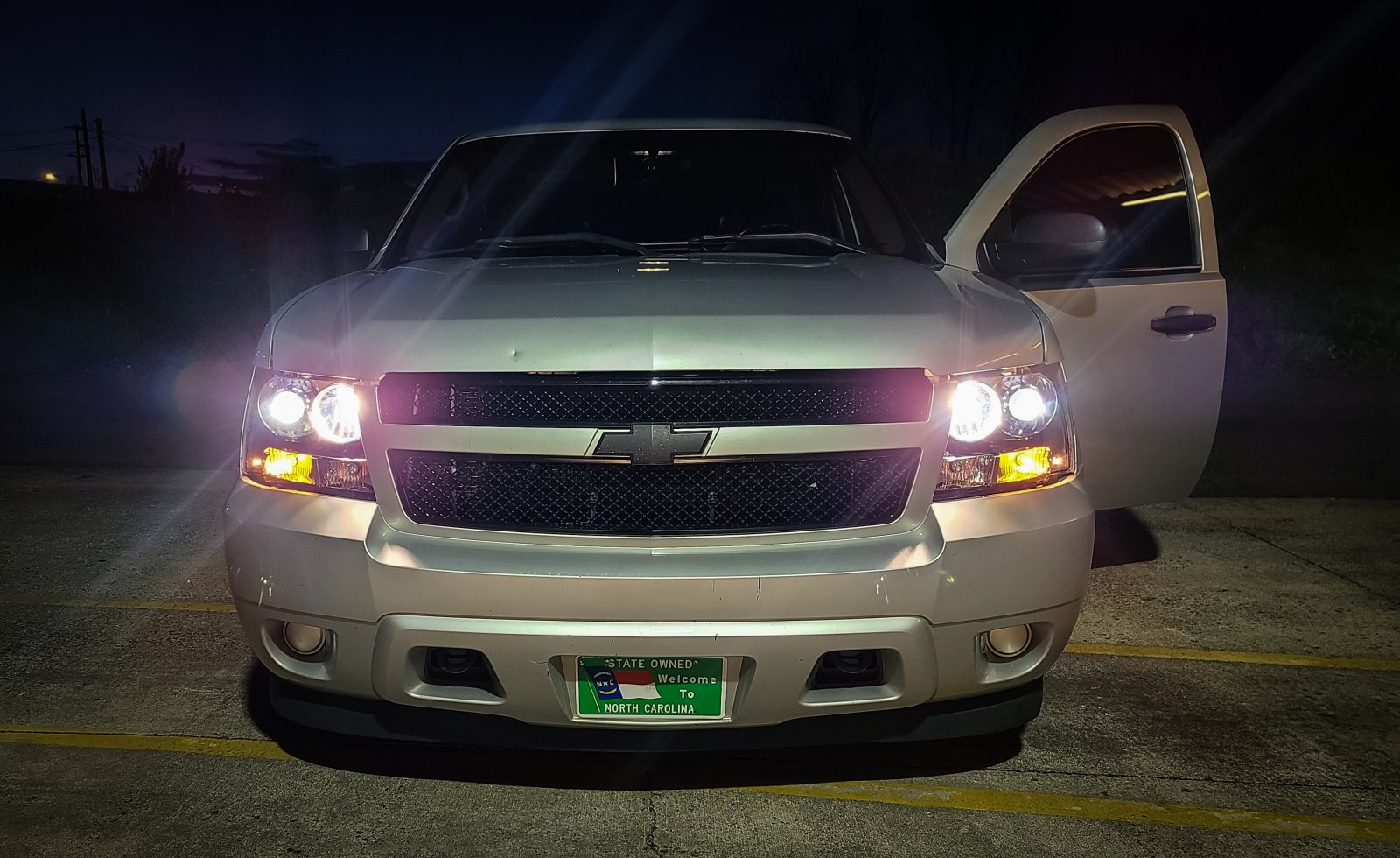

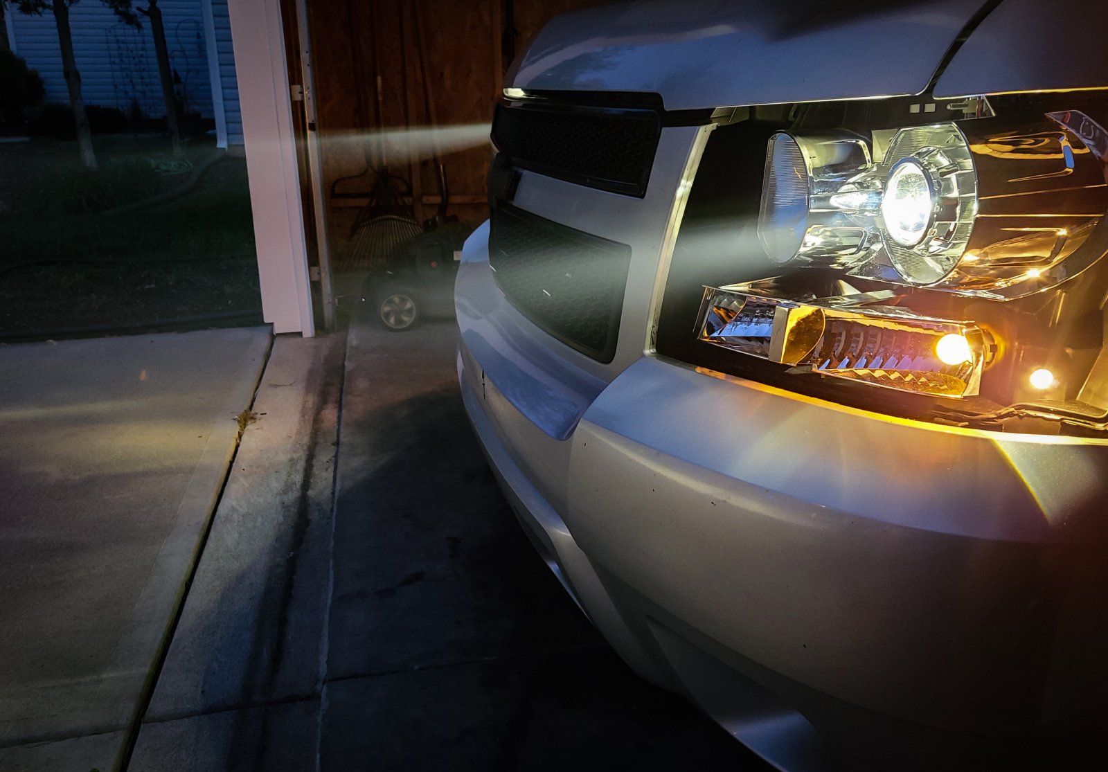

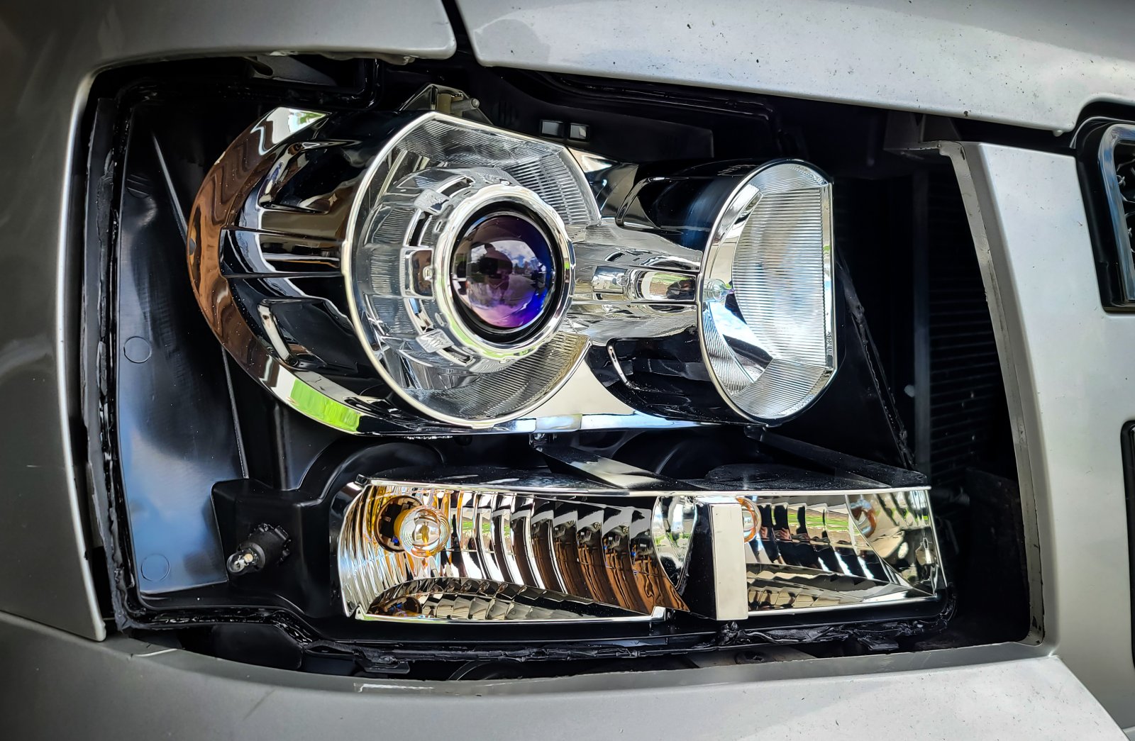

Here is the projector completed, and ready to take out and aim.

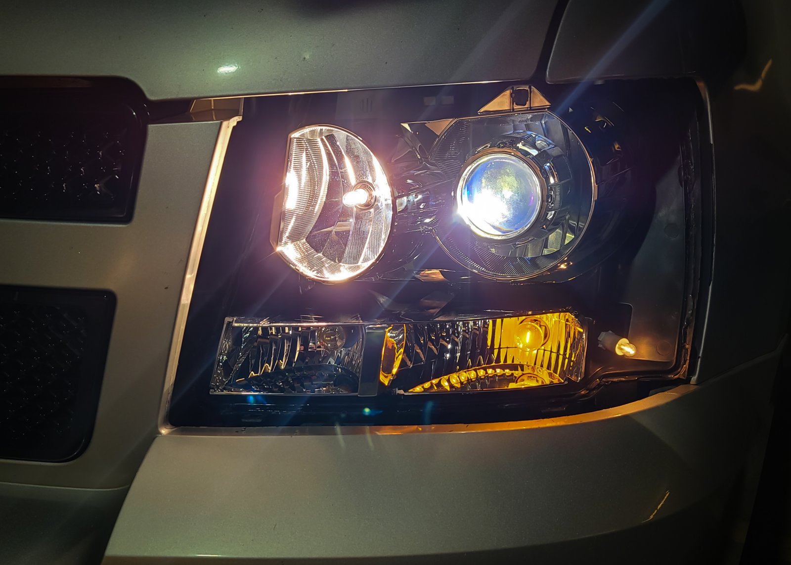

High beams, with splitters to retain the halogen high beams as well.
