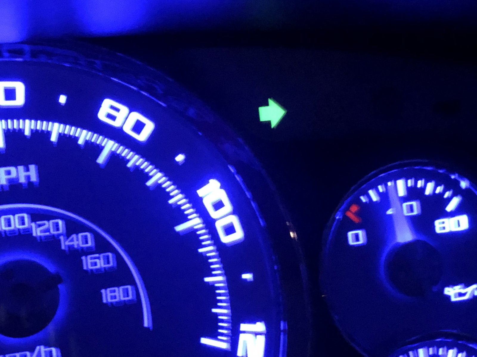

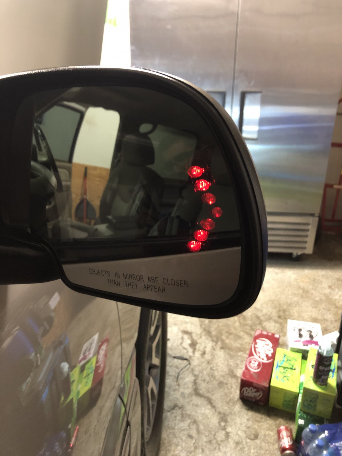

Anyways, super weird problem on my 2006 Yukon xl Denali, after doing a new headlight housing with a morimoto mini H1 8.0 bi-xenon projector housing upgrade and good quality HID bulbs in said projector. So I realized when I finally started up the truck, that the passenger side turn signal is stuck on, though when it’s happening, it’s the LED turn arrow in the mirror and the green flasher in the cluster staying on. And the front and rear turns aren’t staying on. But when I engage the turn signal, at first, it would click once and then just stay partially illuminated. I’m not sure why it’s happening and none of the turn signal wiring got messed with. My HID setup was straight plug and play though with the heavy duty wiring harnesses included in the kit. Everything in the headlights function as intended, and the truck was DEFINITELY NOT doing this turn signal thing before the headlight change over. I even went so far as to take the new headlight housings out and unplug the HIDs and set it back up the way it was before, but that made no change.... :banghead:
I’ll post some pics and include a short video I took after I get it on my YouTube account so I can link it.... I’ve NEVER seen this happen before and now can’t get it to function correctly. Also add in that I checked ALL fuses related to turn signals and none were blown.
34D9573F-B470-4856-AE60-B73030F8CC7F.jpeg 01AB8D72-47D9-415B-9FC3-76685BC7B3A2.jpeg
I will also add that when the LED turn arrow is lit but not flashing as a turn signal, it’s not fully illuminated. The center LEDS are pretty dim, almost not lit at all.
