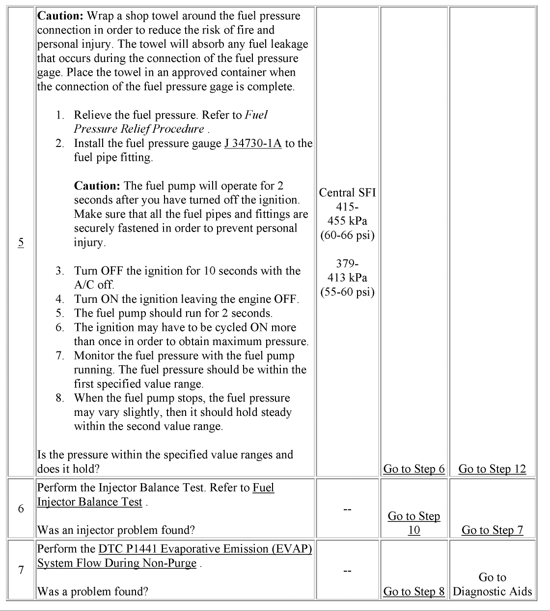

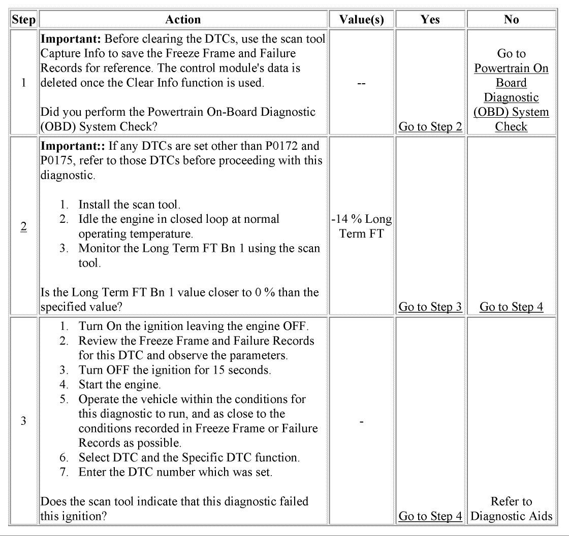

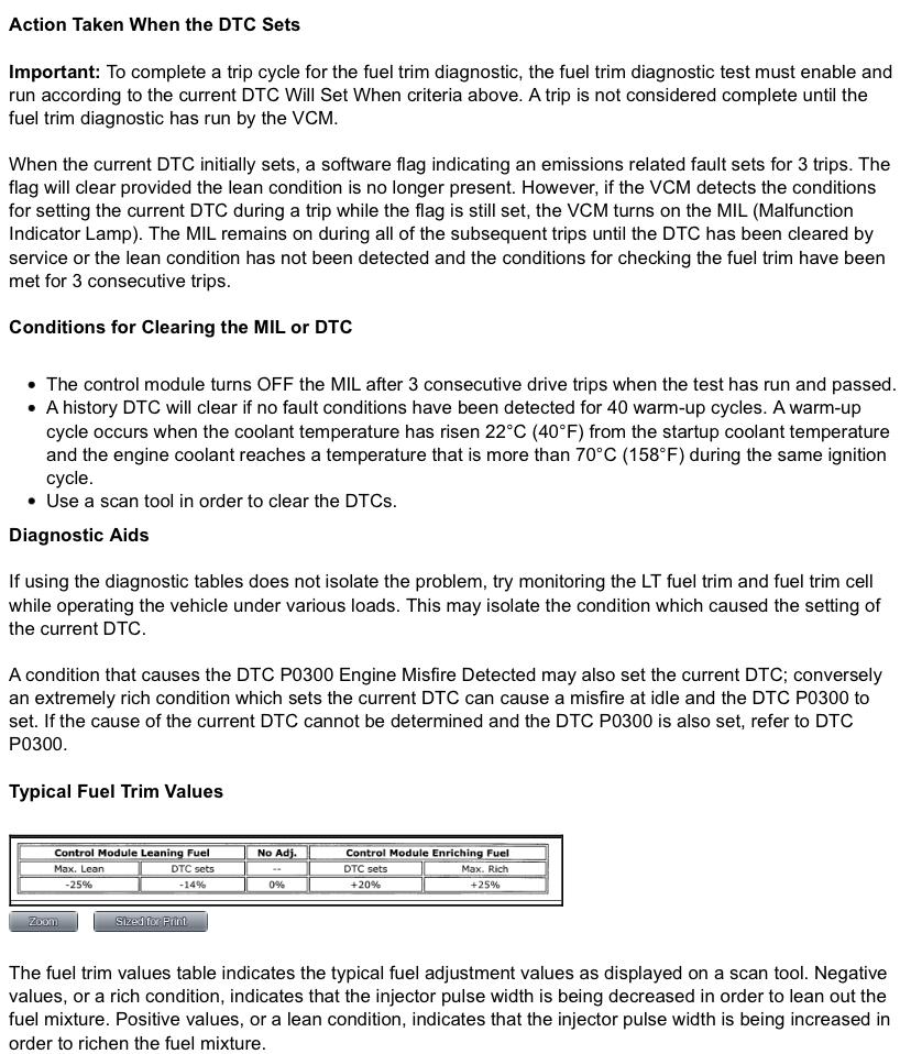

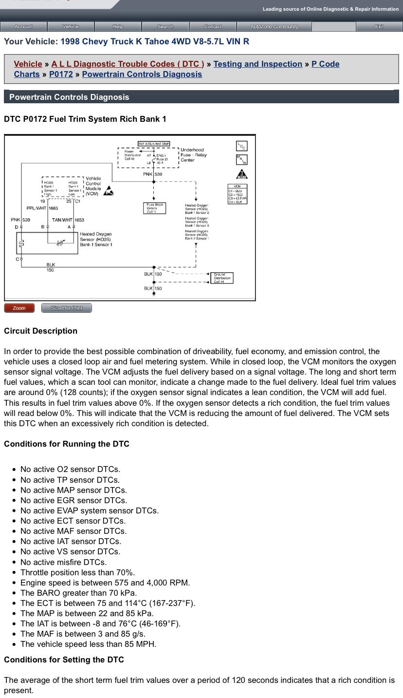

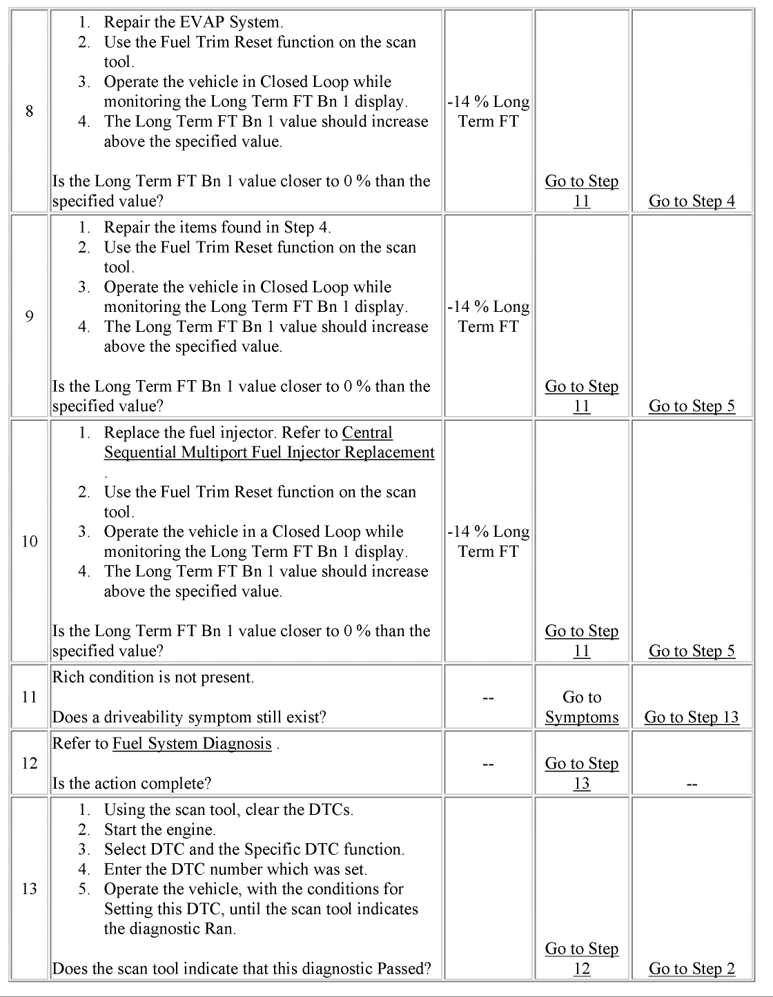

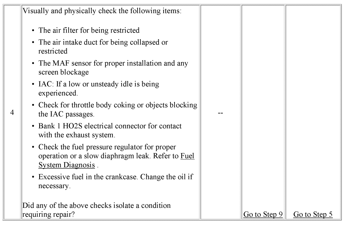

I’d get a subscription to alldatadiy, it’s about $30 per year. Here is the diagnostic for P0172 for a 1998. Maybe it will help. I didn’t go through it all, but do see a regulator leak as a possible cause.
I agree, your fuel pressure decline does point to either an injector, regulator or pump check valve leak. It should hold spec pressure of 60-66 psi for a while - longer than twenty seconds, that’s for sure.
To officially diagnose, you’d need to install isolation valves in place of the fuel filter to see if it’s at the pump or injector assembly. Alldata has the GM procedure for it, but I’d guess an injector/regulator leak. It’s easiest to just replace the whole thing (regulator and injector upgrade to MPFI is very common).

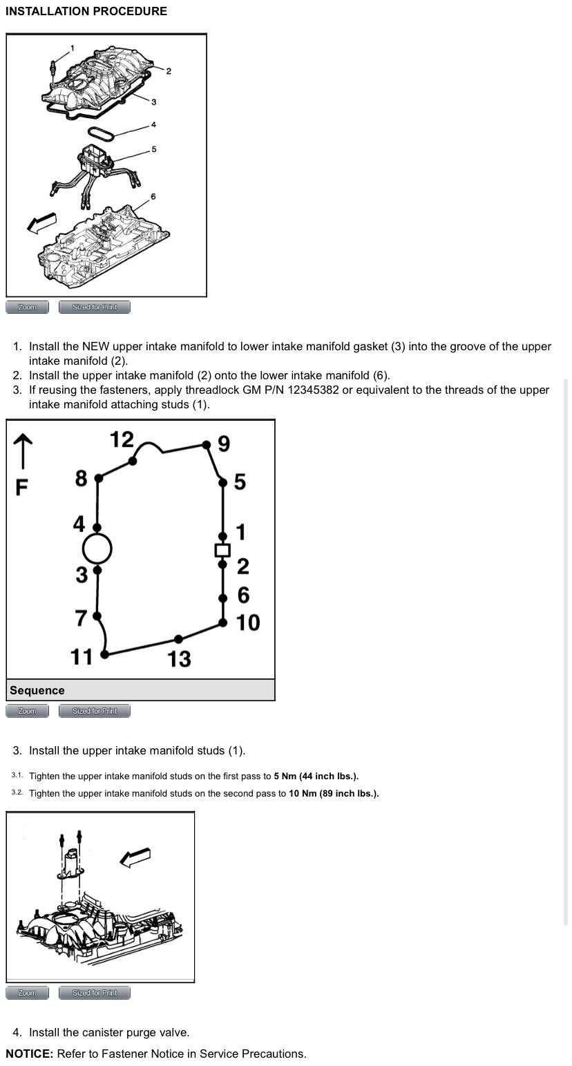

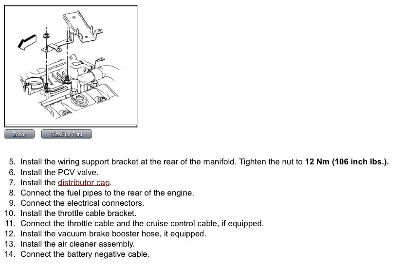

Anybody know the proper torque, now that I know it's plastic I have become a bit more wary.
