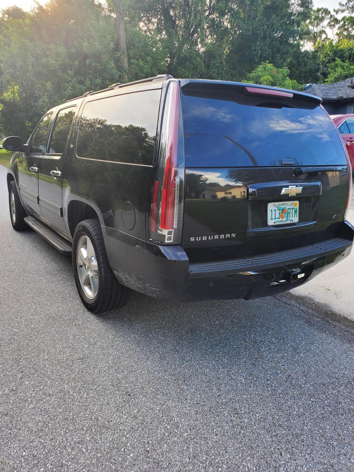

Right now it is a mostly stock 2013 Suburban LT 2WD 5.3L. I have owned the truck for a few years but unfortunately my now ex wife was driving it for most of that time. I got it back yesterday and am ready to get to work!
So far all I have done is put the Escalade tail lights on. What a big difference they make!

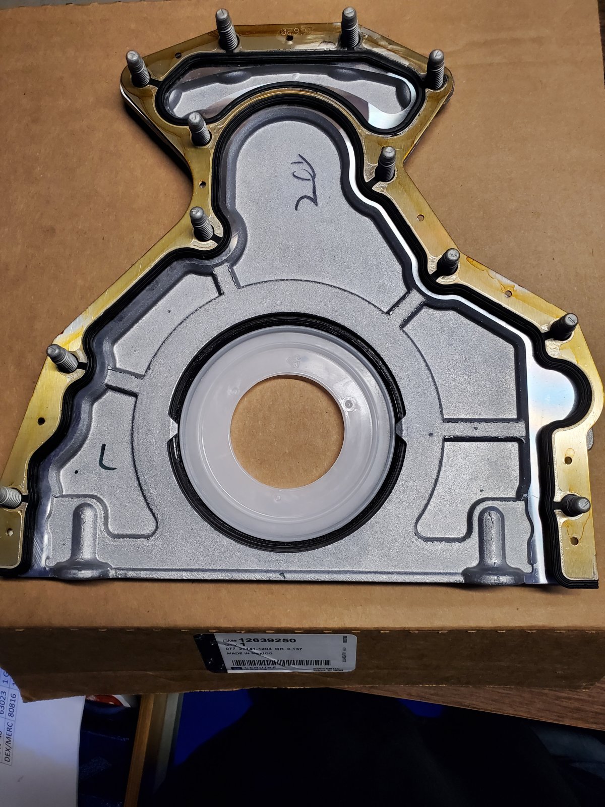

Tomorrow the truck gets dropped off to get the rear main seal/plate changed along with a transmission and differential service.
The rear main seals through GM were on national backorder for a long time but they just got a shipment in of them just to let everyone know.

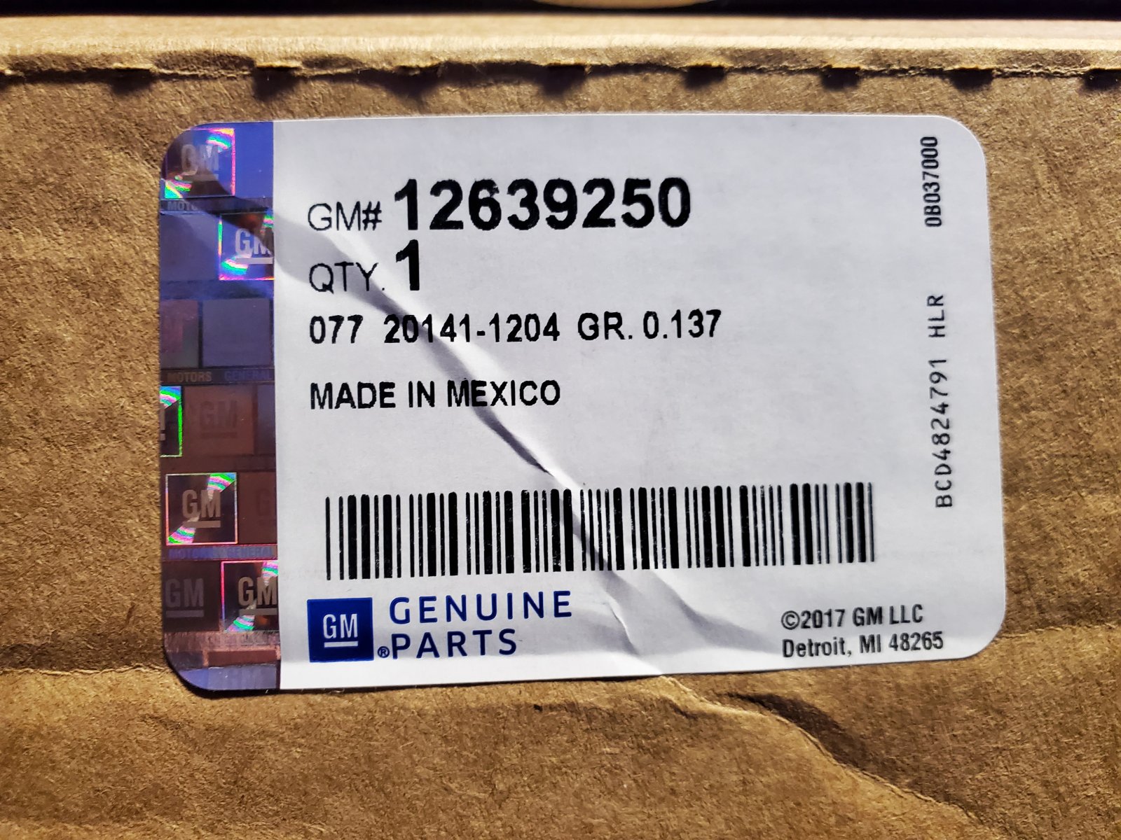

Here is the picture of the plate and the part number if anyone needs to get one.

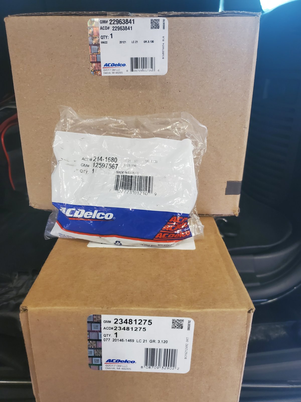

A few days ago the MIL light came on while I was driving around. When I scanned the truck it had a P0455-00 gross evap leak code. I checked my new Delco gas cap to make sure it was on right and cleared the code. I didn't even make it 10 miles away and the MIL was back on. My 60 mile round trip cost me a quarter of a tank of gas.
So I decided to change all three major pieces of the evaporative emissions system because they are all original.
These are the part numbers for the pieces.
Not a bad job to do but whoever designs the connectors that go on these pieces should be flogged. Each "quick" connect fitting is different. How unnecessary!
I drove it 30 miles and it hasn't reset like it did last time. My gas mileage seems to be back in check so I am very satisfied.

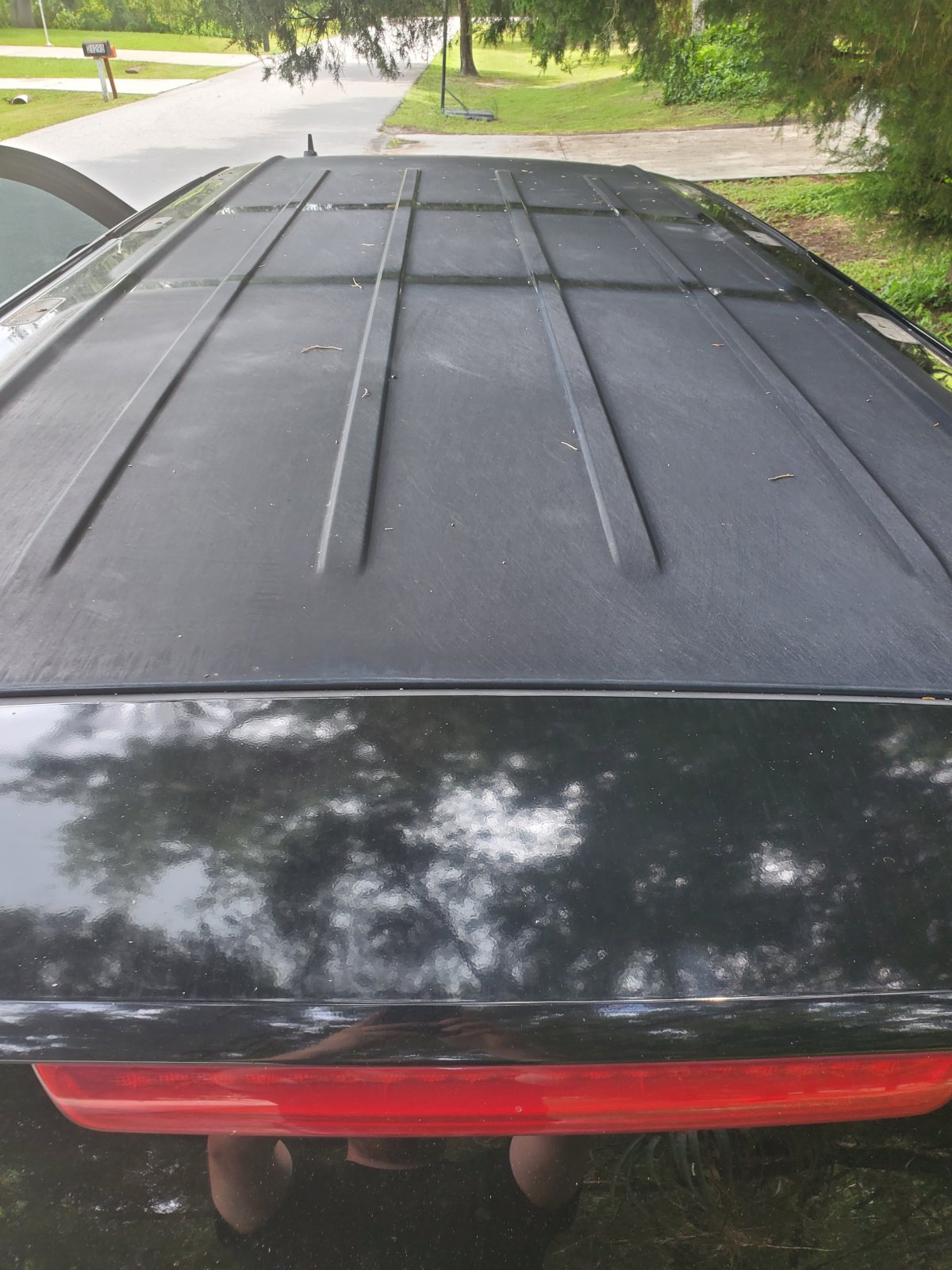

I removed the roof rack just now. The roof is in terrible shape due to this Florida sun. The only good parts were under the cross bars. Painting the roof will be the next project I do.

Have you tried to compound it with a buffer? Doesn't look damaged just super dull.
No I haven't. The surface has very deep scratch-like marks on it. A good friend of mine is a paint and body guy so I am going to have him look at it and make a determination. Thank you for the advice, Tony!
