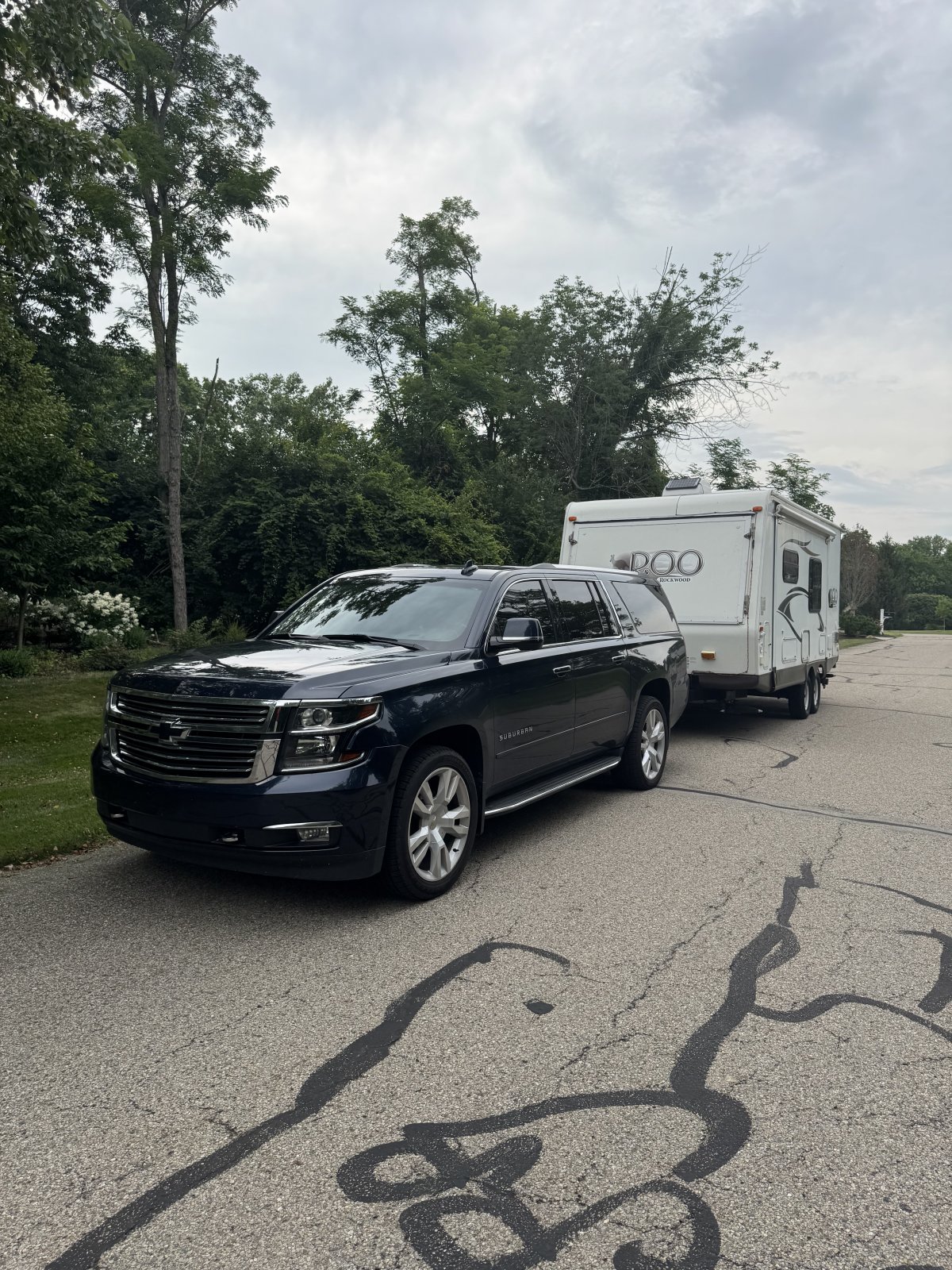

So I towed 200miles today in fourth. The 2019 likes to stay around 72-75 mph with my foot where it is. My previous 2011 liked to stay around 65.
My trans temps were around 185F with 82 Ambient, but did get into the 190’s in traffic. Because we didn’t leave until Cincy rush hour even though we knew 6months ago we were leaving at 2PM but someone procrastinates. ;)
I did install the lower temp thermostat. RPMs were 3K. So I am good.
Oh I did try 3rd for a while which brought me into the high 4KRPMs, but no issues.
I like to experiment with these things.
