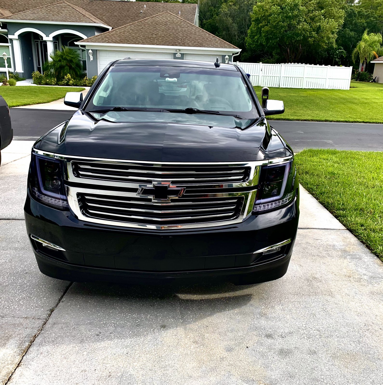

I’ve got a 2018 Tahoe Premier that has the max trailer package. I bought it about a year and a half ago and got a decent deal on it and I’m thinking it’s because of the suspension. This thing is so stiff stuff actually flies around in the back if you hit a bump in the road. I was originally ok with it as I had a car as my other vehicle. I have since gotten a truck for work and am looking to soften the suspension up on the Tahoe. Looking for input on what softer suspension parts are compatible.

Pics of the truck, please.
The first step that I would take is to bring it to a reputable dealer or repair shop, familiar with this truck and its suspension systems, to inspect it and determine if all of the components are operating correctly. I would not shoot the parts cannon at it, or devise any other potential remedies, until this is done. I don't think that the situation that you describe (This thing is so stiff stuff actually flies around in the back if you hit a bump in the road.) is normal for any stock truck in proper operating condition.

Does it soak up bumps properly over whoops in the road? The air suspension should provide a nice landing without being harsh. I also see that you have 22 inch wheels, how's the pressure? Have you tried putting more weight on the back (couple people standing on the bumper will work) and listen to the compressor pump up and then release air after the weight is gone?

Nice ride. Like the interior. I can tell by the way it is setting the suspension is stuck up. You diffidently have an issue with it. Would have to take it to the dealership to scan for codes. Unless you have a scanner that you can emulate the shocks to see if they can move freely and operate correctly. Had a similar issue with my Navigator. Same suspension, the air ride module was bad. Then the shocks went. Sold the car...Cost way more to fix than the car was worth. One shock was $900. But they do make a conversion kit where you can get rid of the air ride.
