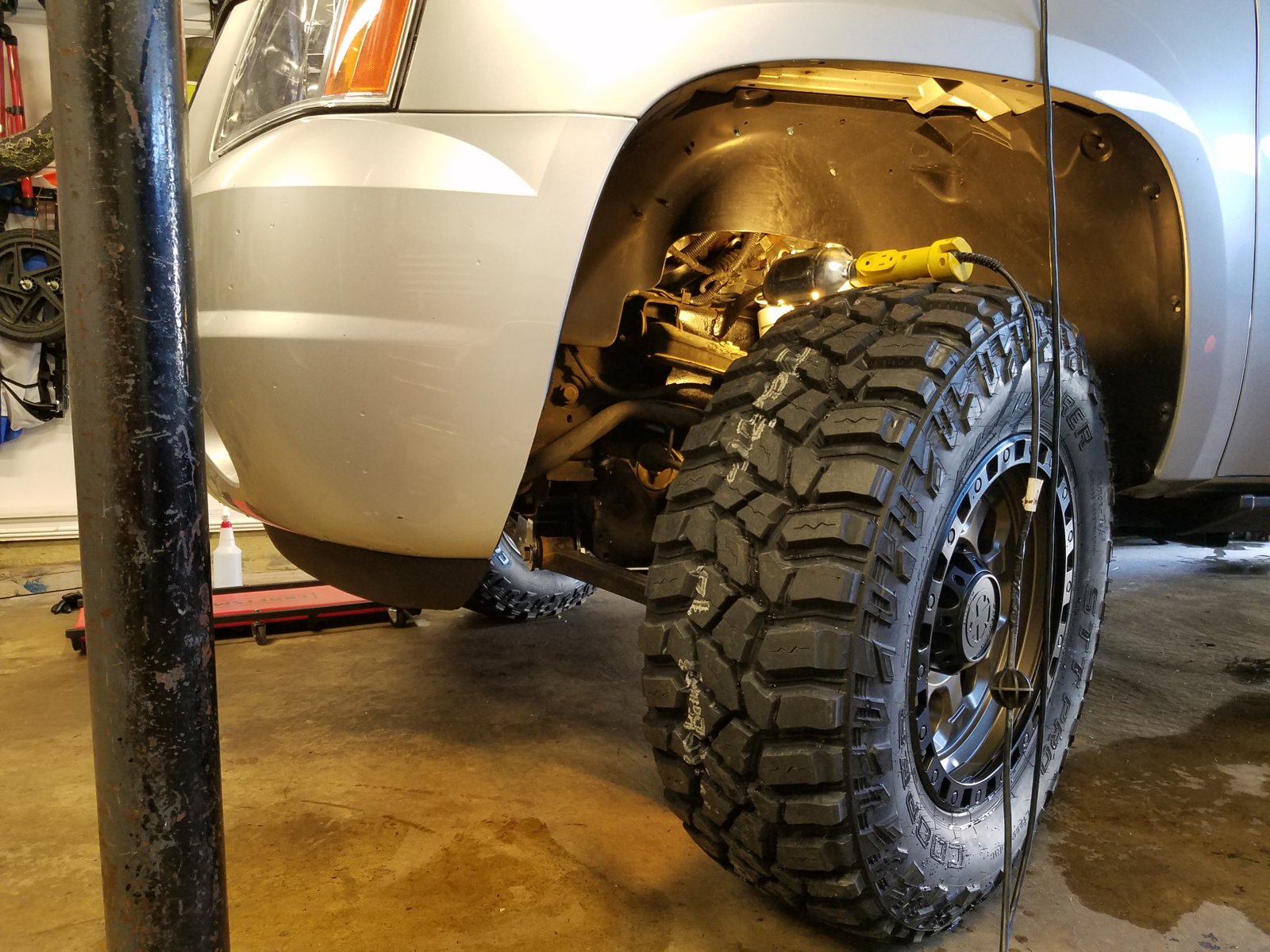

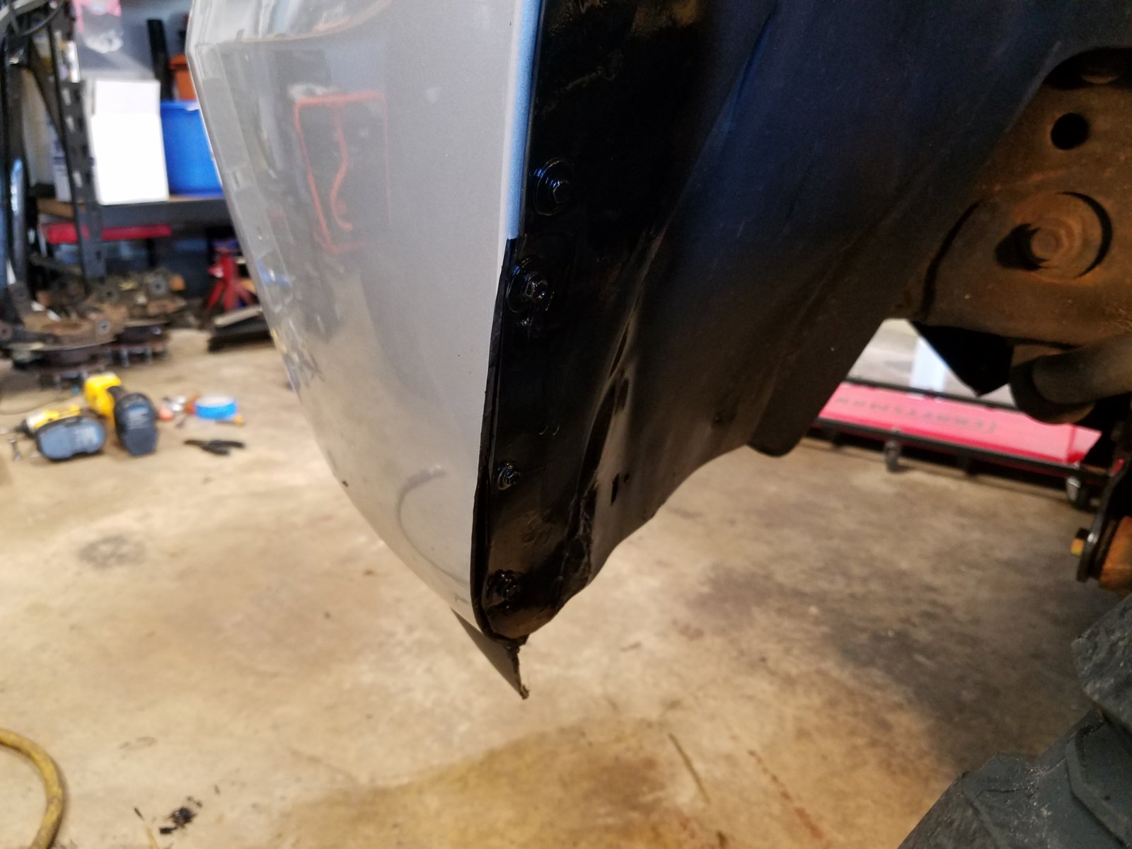

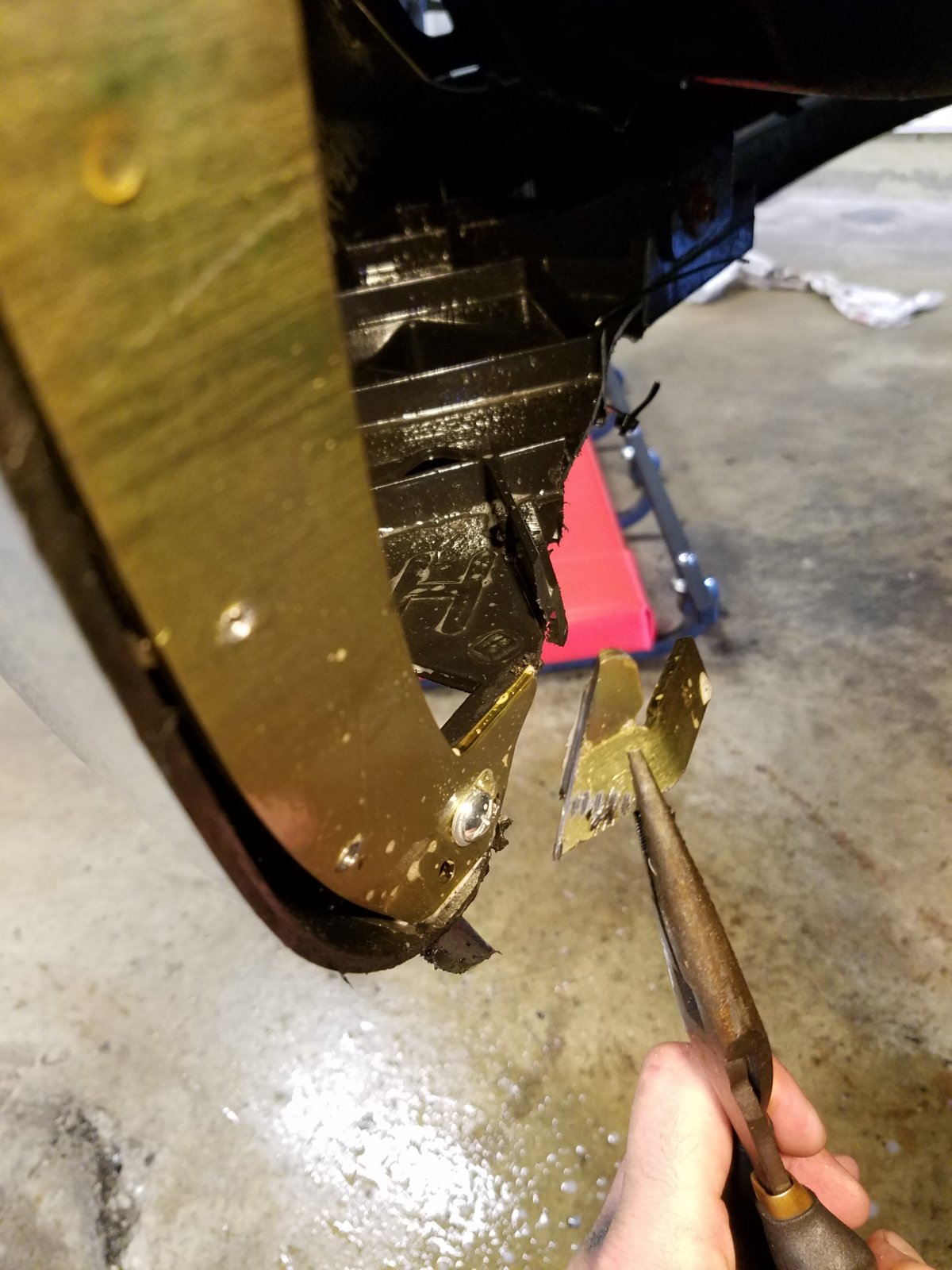

Here's an update to the trimming.
Pro Comp Brackets 90-3575 and 90-3576 had to be modified to eliminate rubbing. Not a big deal, I just cut off all excess material and mounted with one upper & one lower bolt. Then some trimming and heating/forming of the liner.... not too bad. These brackets were definitely a life saver!!
Really.... for taking 1.5" off the bumper I think it came out pretty damn good. Only ones that'll notice are other GM owners who have been through our hell of trying to fit bigger tires lol
