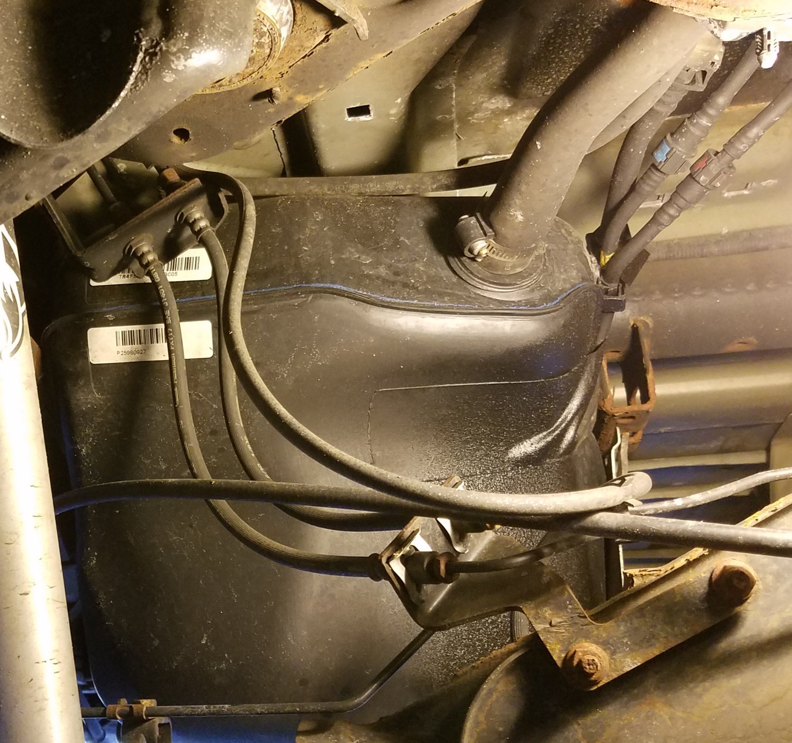

Oh the glorious life of a 2500 series SUV owner....
I asked Crown Performance for the correct part number before I ordered, knowing these vehicles are finicky, especially 2011+ since the trucks changed but the SUV's didnt.
Looks like my brake line and air spring install is going to be postponed a few more weeks
View attachment 194828 View attachment 194829
Shes a no fit... shes a lil big....lol

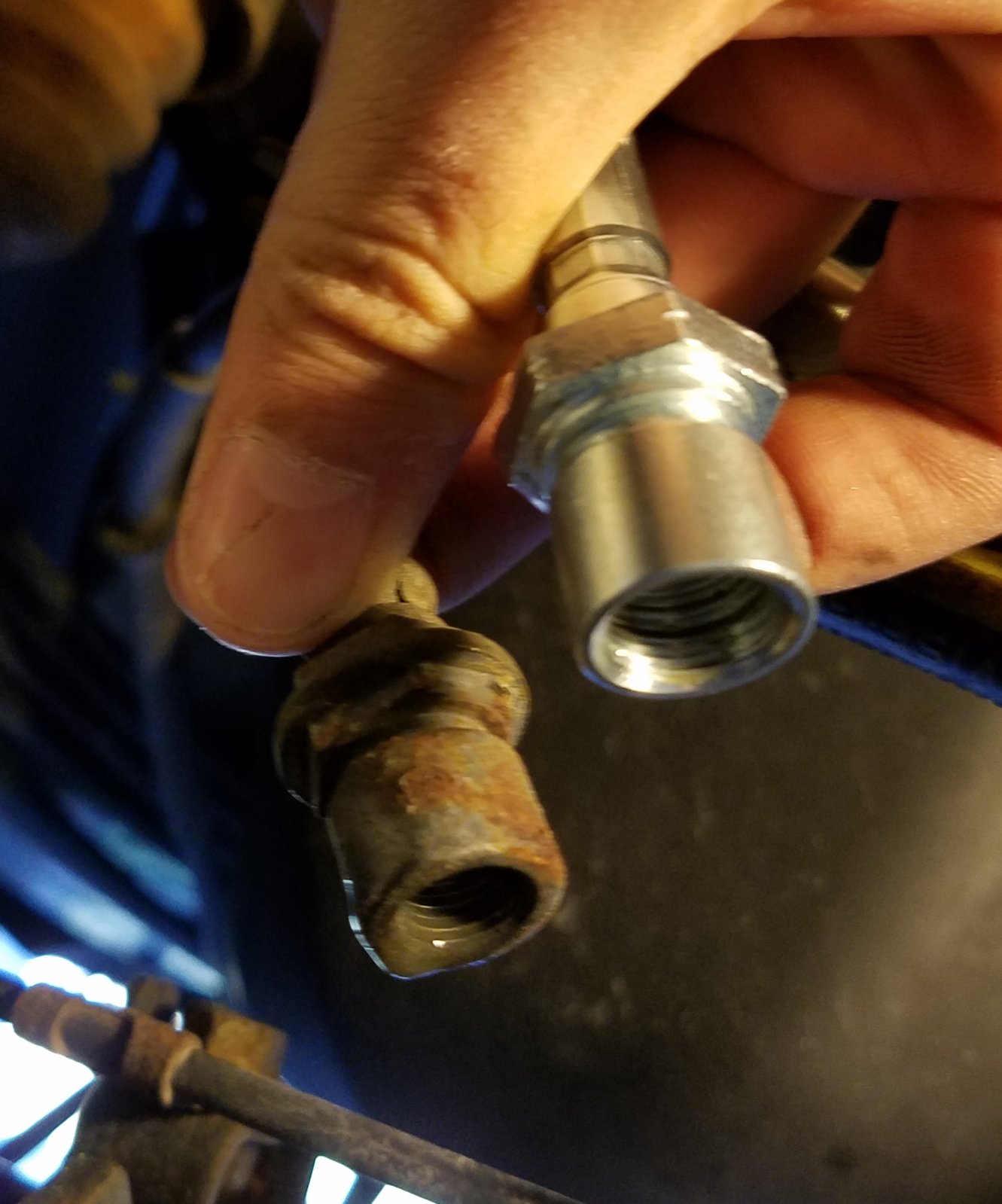

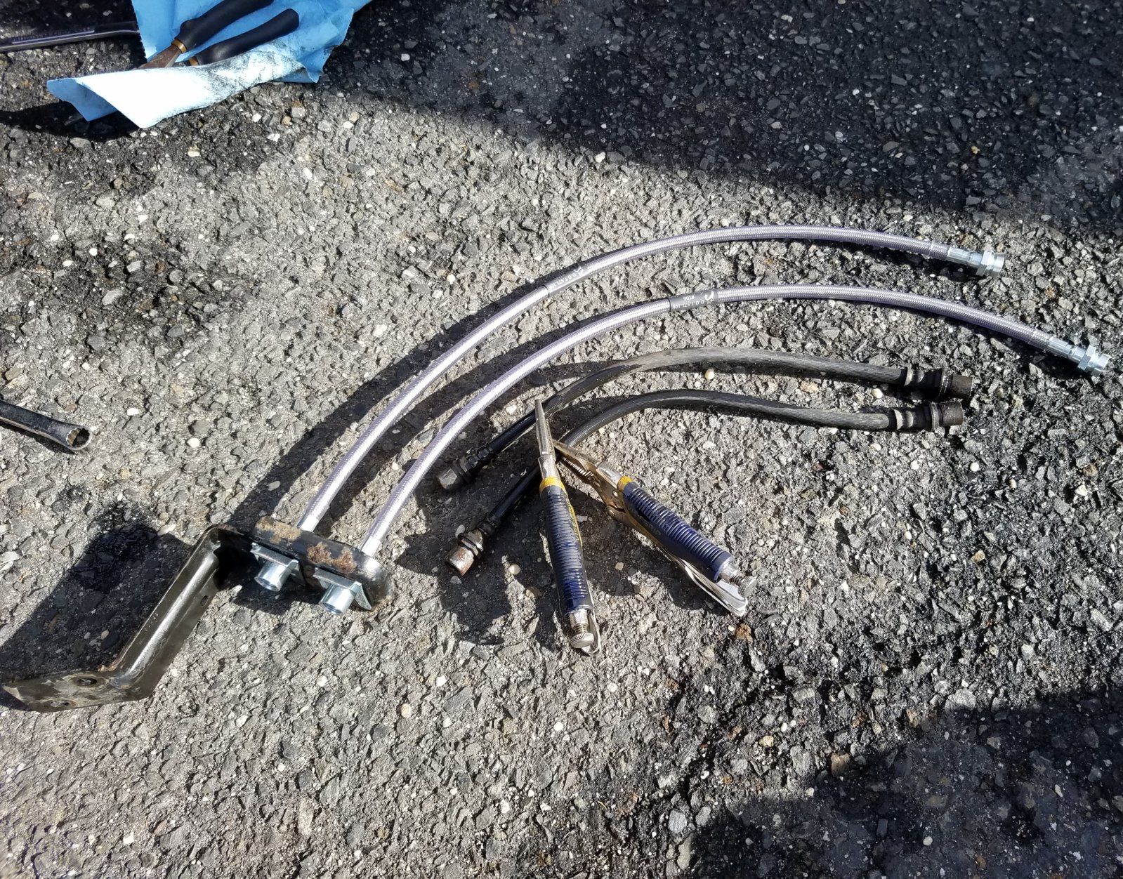

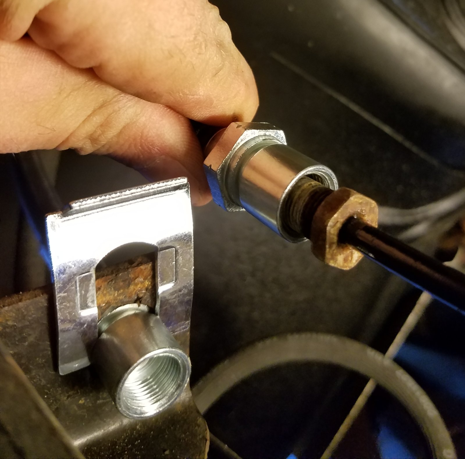

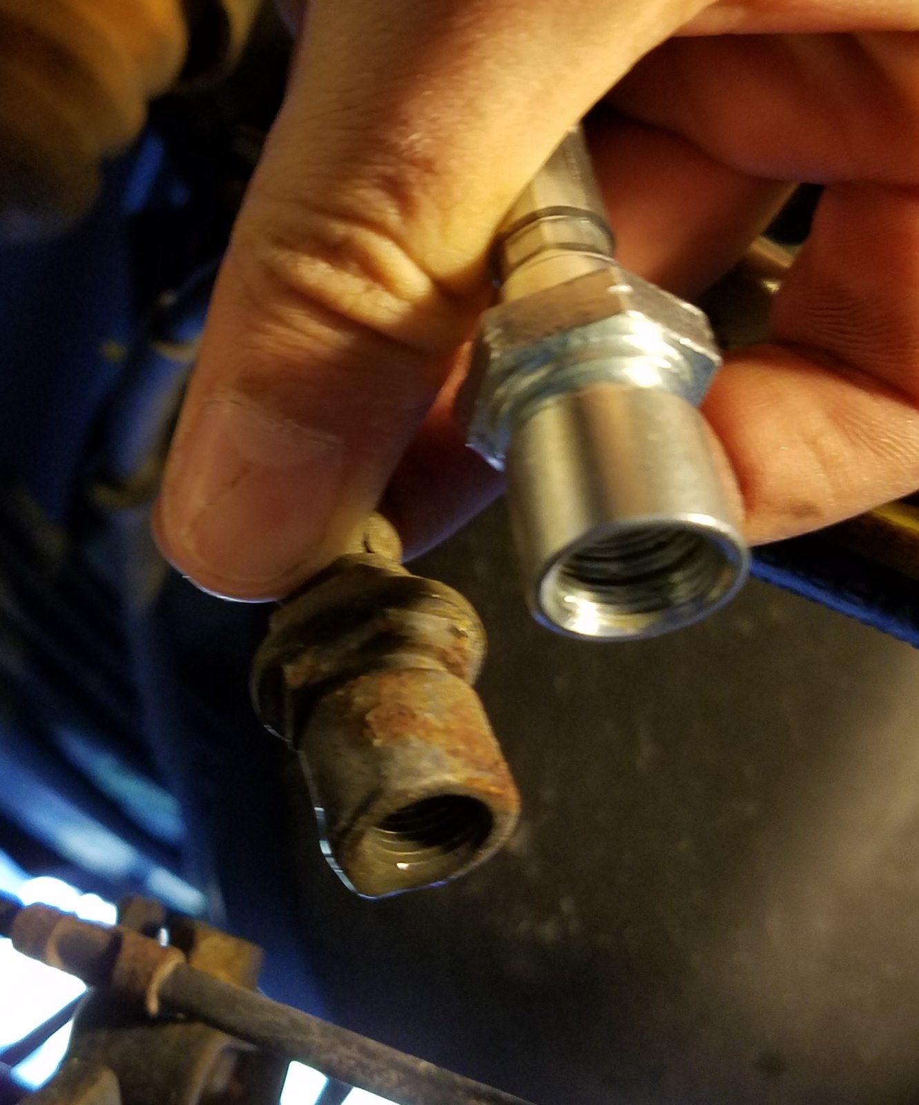

Ok so this is definitely NOT one of my proudest moments.... Every once in a while we're humbled by a lapse in critical thinking and reminded that we're human.
I could try to ignore this happened, but it wouldnt be right. So here I am putting my pride aside.
Remember those brake lines that didn't fit?
Before install I cracked all 4 fittings... all 4 used a 13mm line wrench.
The new hoses have the same diameter barrels (see where this is going yet).
I picked up the first line, put it in place... didnt fit.
I picked up the 2nd line, not choosing which side to hold up, and took the picture showing the mismatch.
So i'm on the phone with Crown Performance yesterday (cool peeps to talk to on the phone BTW) and the tech is looking up all different GM vehicle specs. Then, with a slight hesitation, he says "youuuuu didn't happen to try flipping the line around did you?" ... I thought he was nuts for a split second, thinking back to using the same wrench to crack the fittings, and the outer diameter of the new lines being the same. It was a complete paradigm shift to think the lines WERENT symmetric, and that both instances during the install I had a 50/50 chance and randomly chose the wrong side of the lines both times.
I walked downstairs, picked up one of the lines and looked at the threads [insert facepalm]. Had a good laugh with the dude on the phone. He tried to make me feel better and said "it happens all the time" which I replied with "I sure hope not!" lol

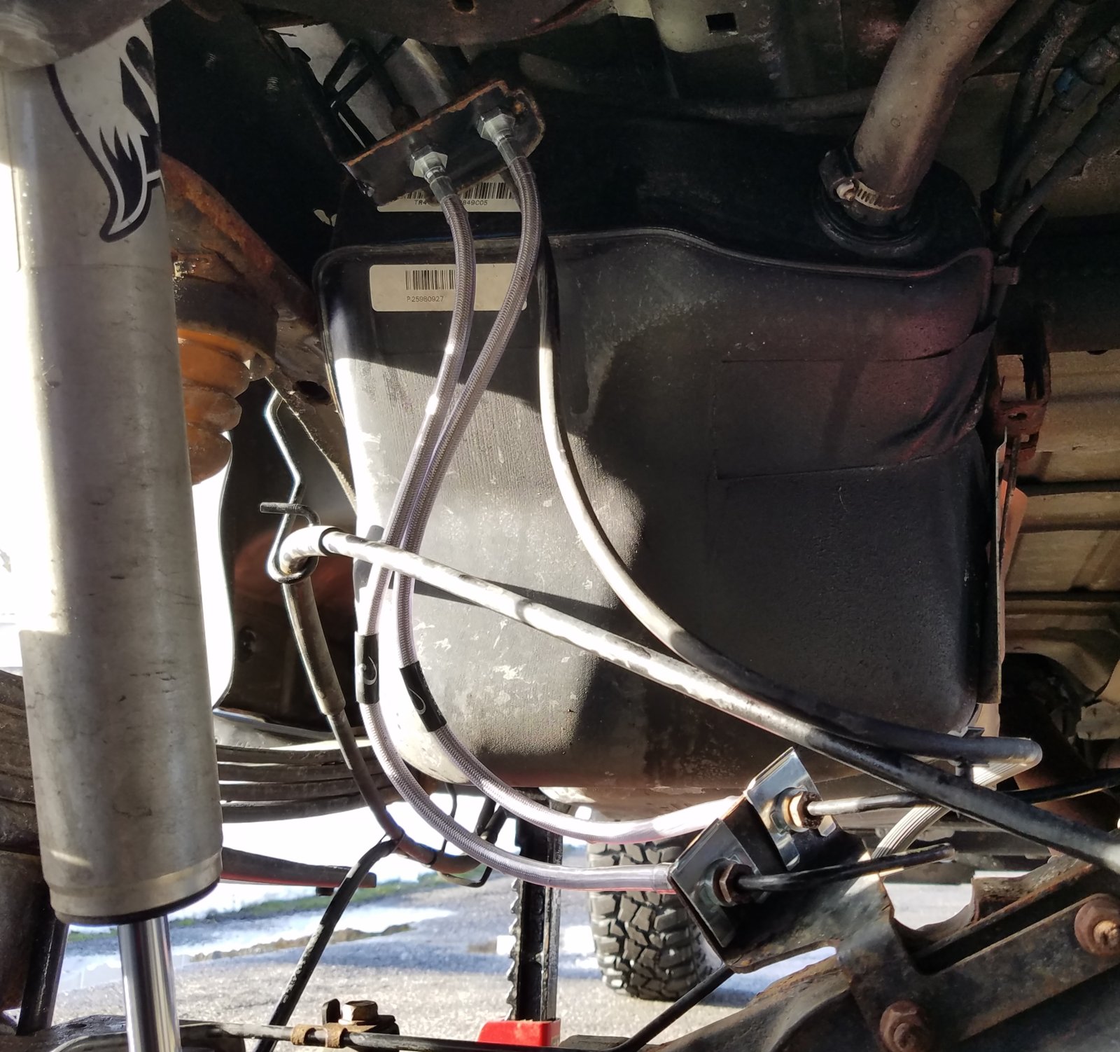

So yeah.... new lines installed! Next warm day i'll put the Airlift bags on and hopefully don't screw that up, like trying to inflate them with a vacuum or something :nolol:
