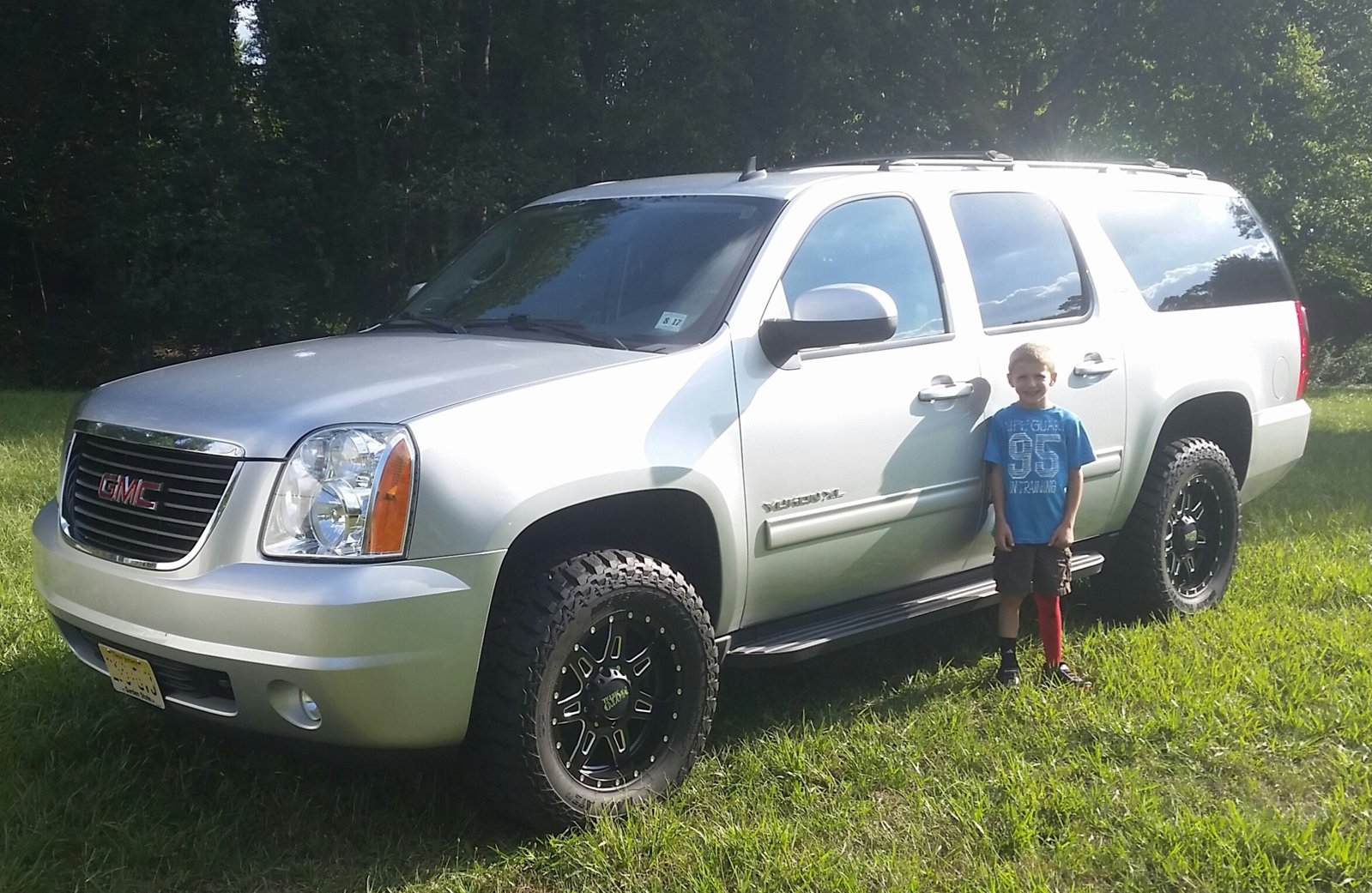

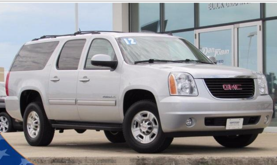

So here's my Unicorn, on the dealer lot and then in my driveway (pic taken the next morning as I left for work... because I only took 1 day off)

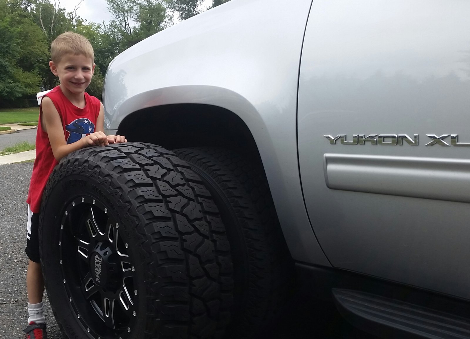

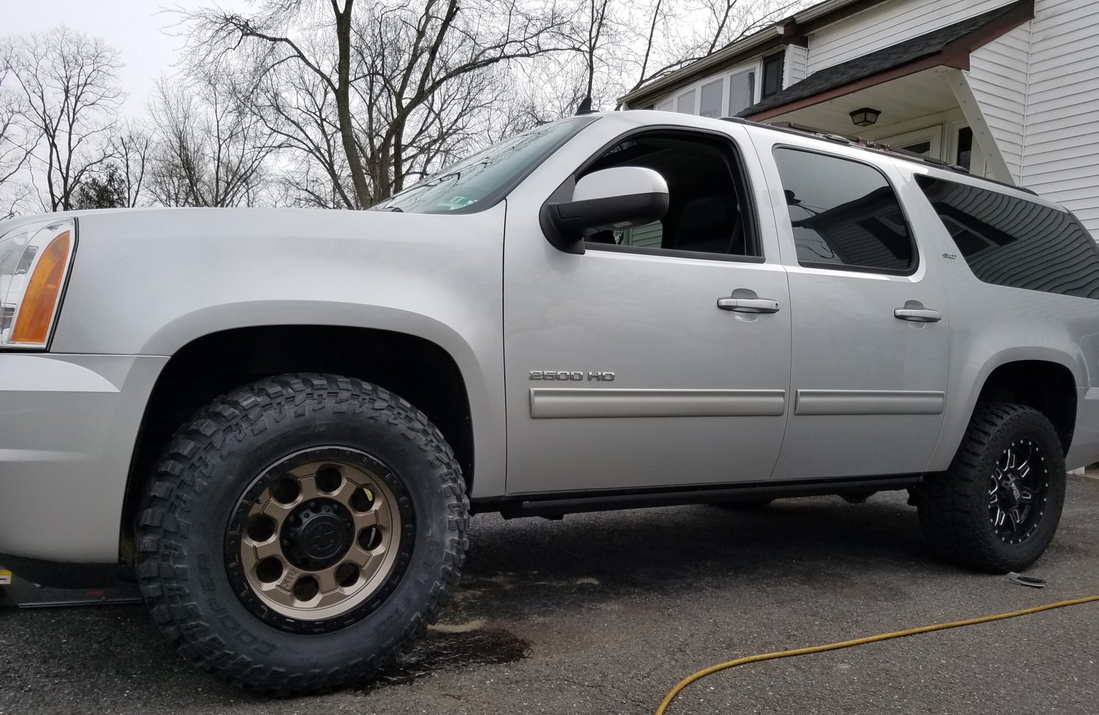

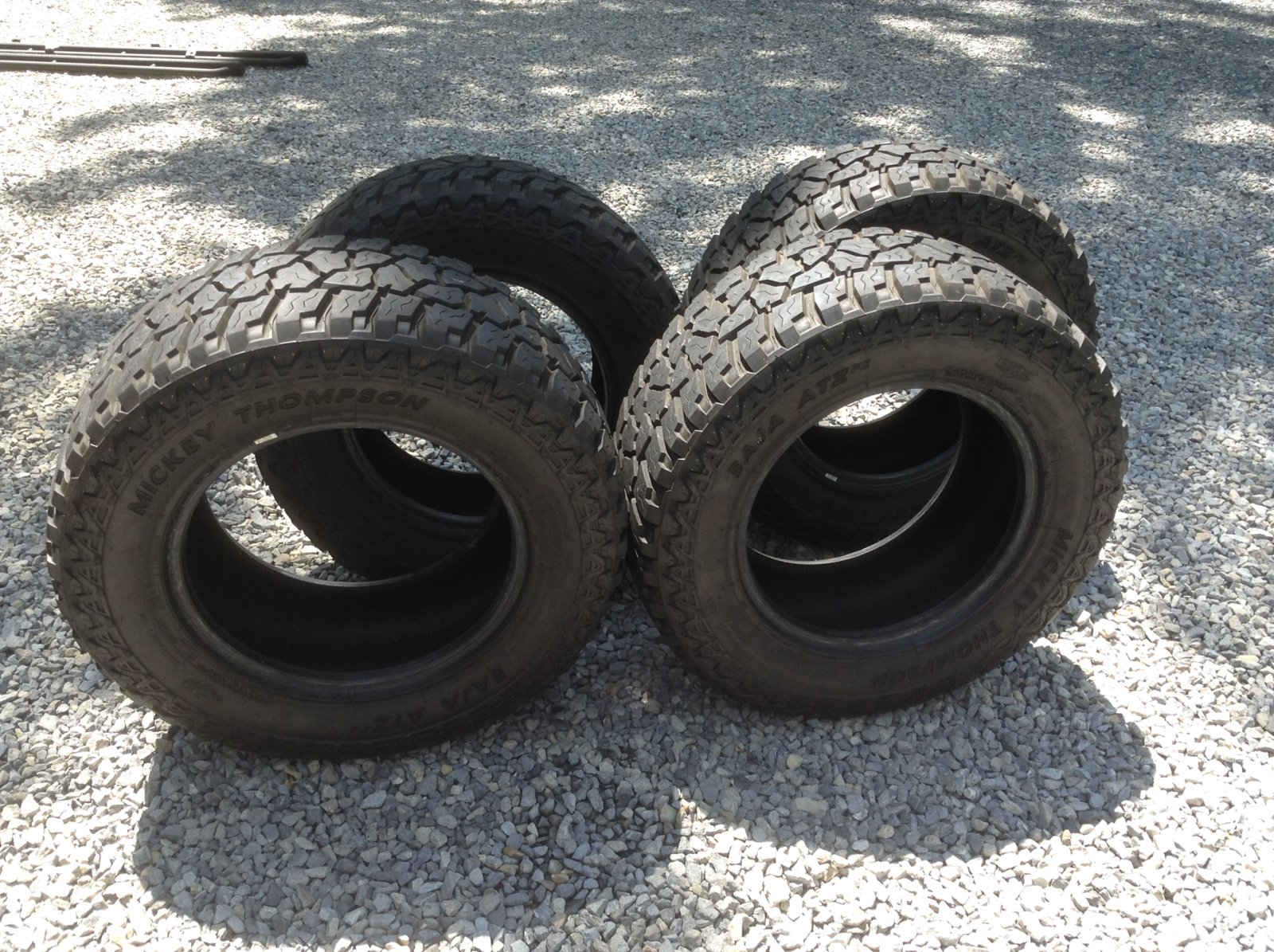

The base for the build was always going to be a ~4" lift and i figured 33" tires would do it. Naturally I kept my eye on used tires, hoping to find that sucker that was talked into 33s by his wife for his Jeep, but then threw a 2" lift on and needed to go up to 35s.... and that's pretty much exactly what found. A set of almost new 305/60/18 Mickey Thompson ATZ P3's for a great deal.
So now I had these big tires, and I only had my truck for a month or so.... I wasn't ready to lift it yet. Well I "was", but I needed to sell my Commander first, but wanted to use my Commander through the winter, sell in the Spring,then transfer DD duties to the XL2500.
My buddy hooked me up with a nice set of wheels at a great price... the next question was how to fit them! Having owned a few trucks with similar suspension, and having run every type of lift imaginable, cranking the torsion bars were out of the question!

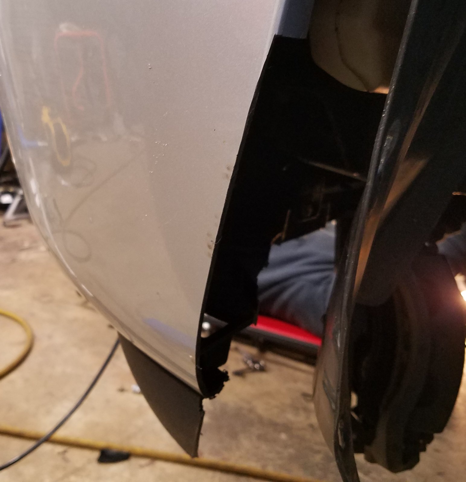

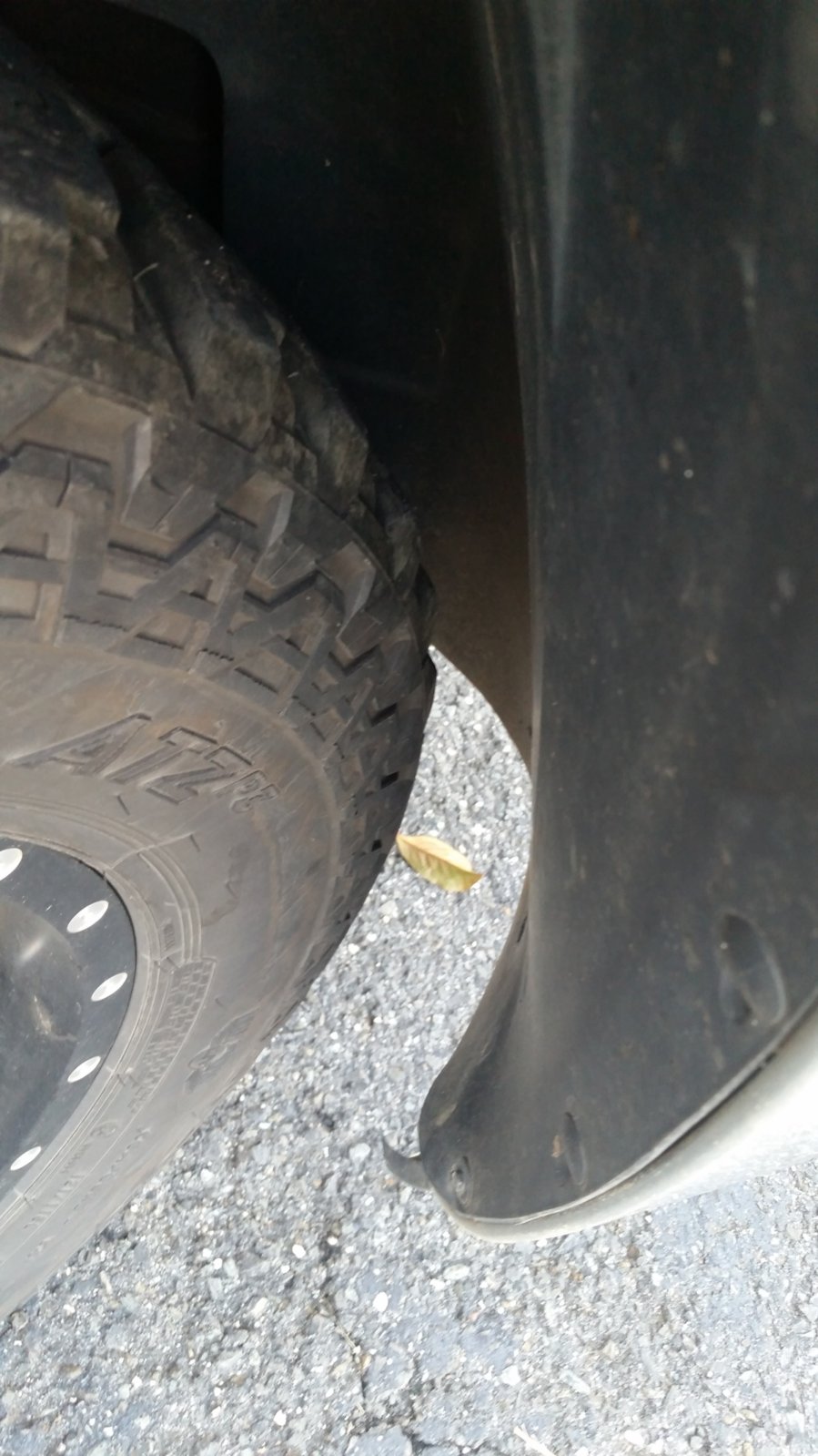

No suspension lift, No cranking the torsion bars.... but being my 3rd GM truck I'm an expert at trimming!
Modified the front bumper brackets, cut and reshaped the sheet metal in the back of the fender, then used a heat gun to reform the plastic liner.... crossed my fingers and to my surprise (really), they fit without rubbing!

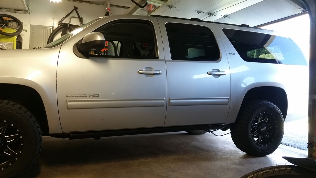

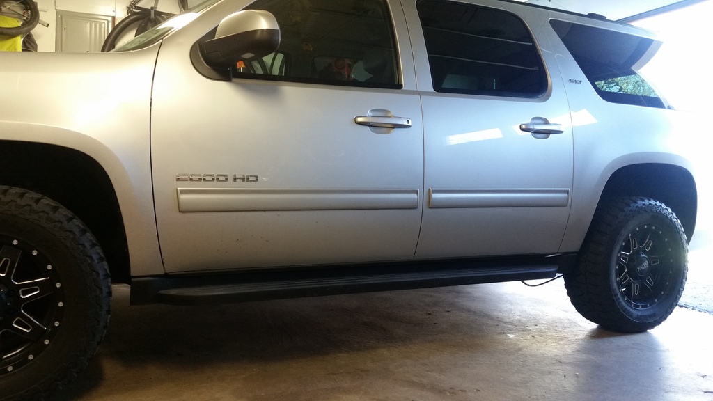

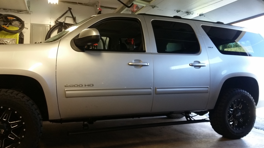

After I sold my Jeep last year I used some of the money to upgrade from the factory running boards to AMP Research Powersteps. Probably not the most practical mod as they catch less (like none at all) road debris, more moving parts, etc etc, BUT they come down lower when extended which helps the kids get in, which I guess is my way to justify these as more than a purely cosmetic upgrade :ylsmoke:
One thing they do well is make the GSU look like its lifted. I've had multiple incidents of people asking about the lift, most famously was at the scummy dealership service department when they tried to circumvent a warranty claim but using my "lift" as an excuse not to cover the repair. They sure felt like idiots when I told them to go take another look at the truck and call me back when they tell me which lift kit is installed. Tthe next call i got from them was "repairs are done" :rolleyes:... and yes, i verified they were done before leaving lol
On to the pictures..
Stock Running Boards
AMP's retracted
AMP's Extended

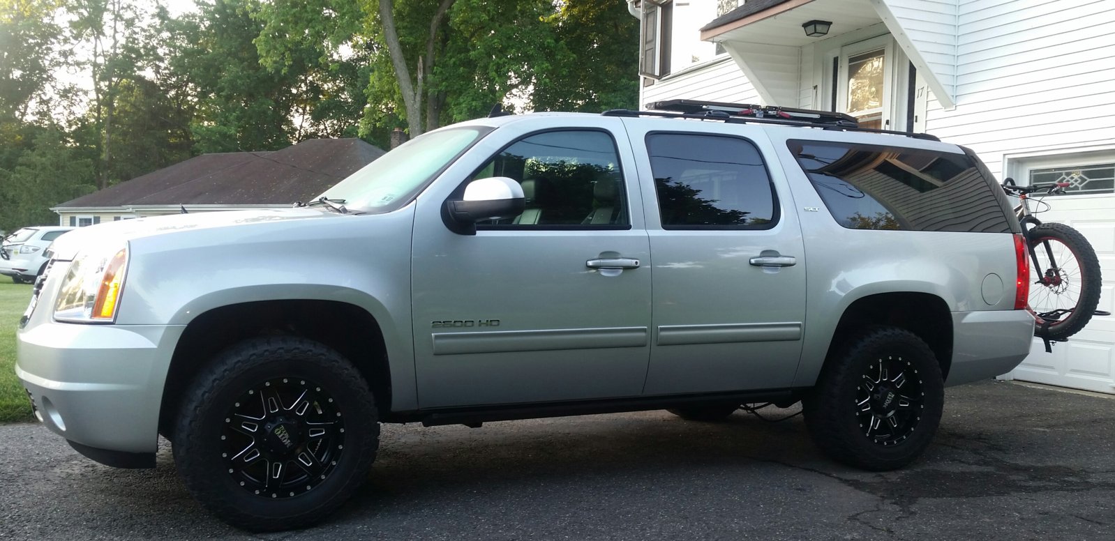

How she was sitting as of yesterday.... well, yesterday afternoon anyways....completely different by 9PM :crazy:

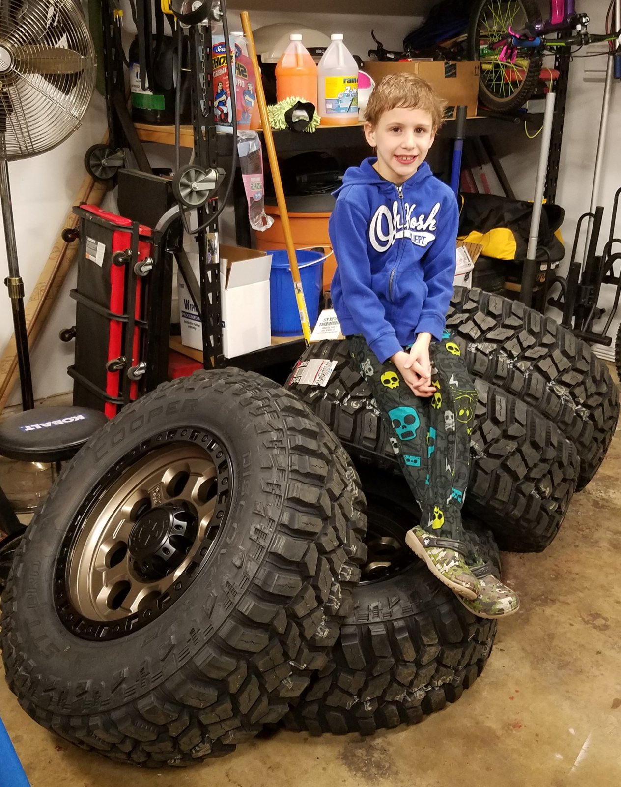

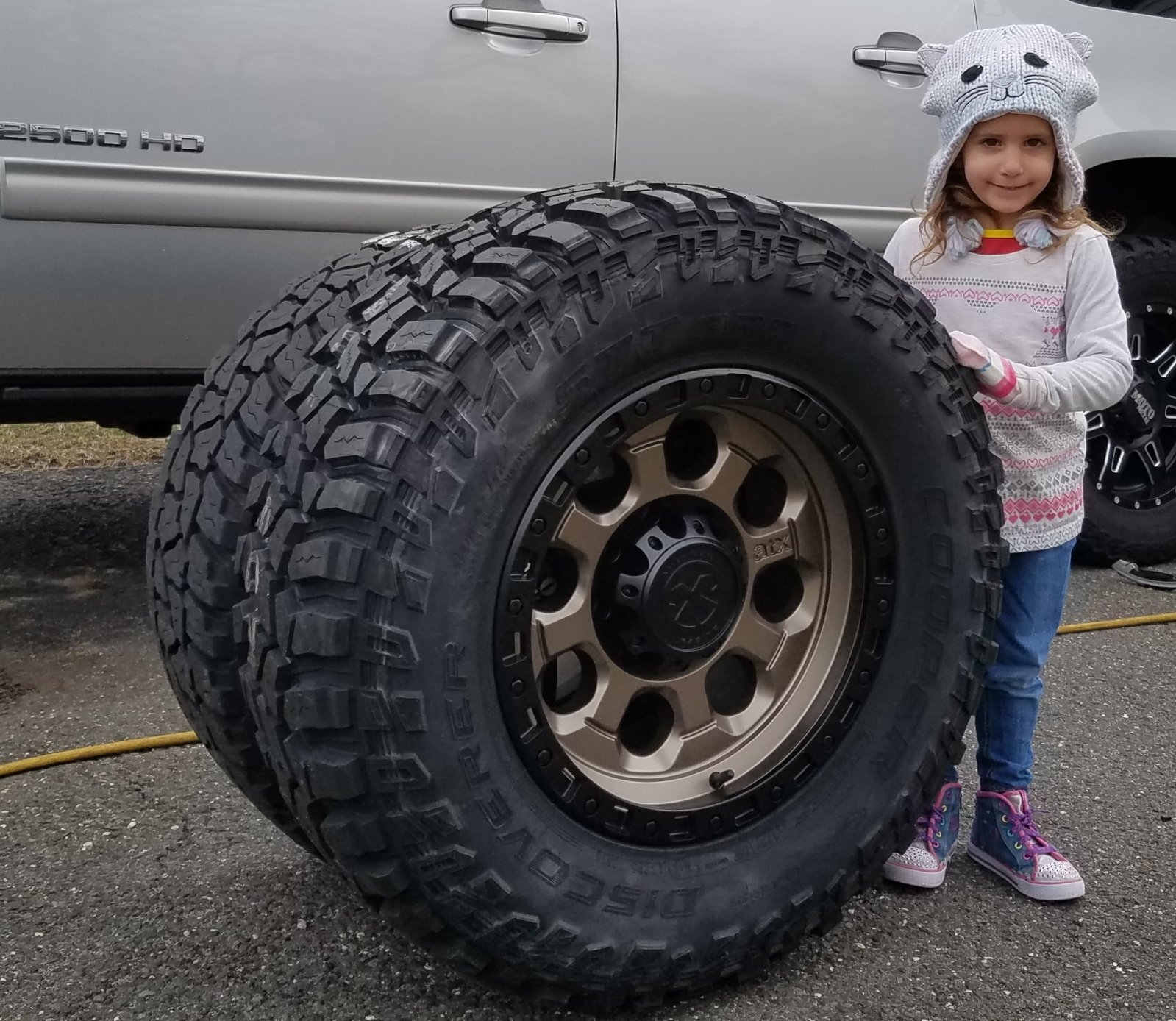

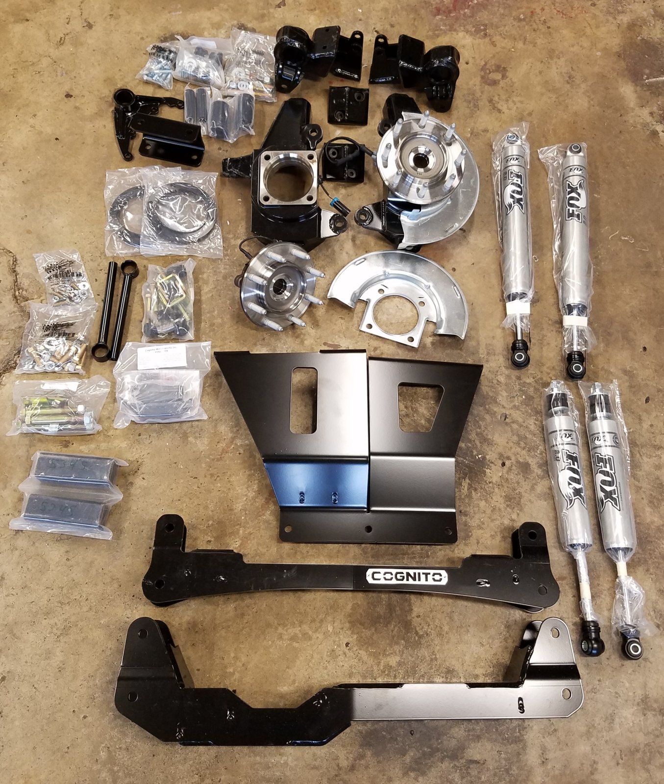

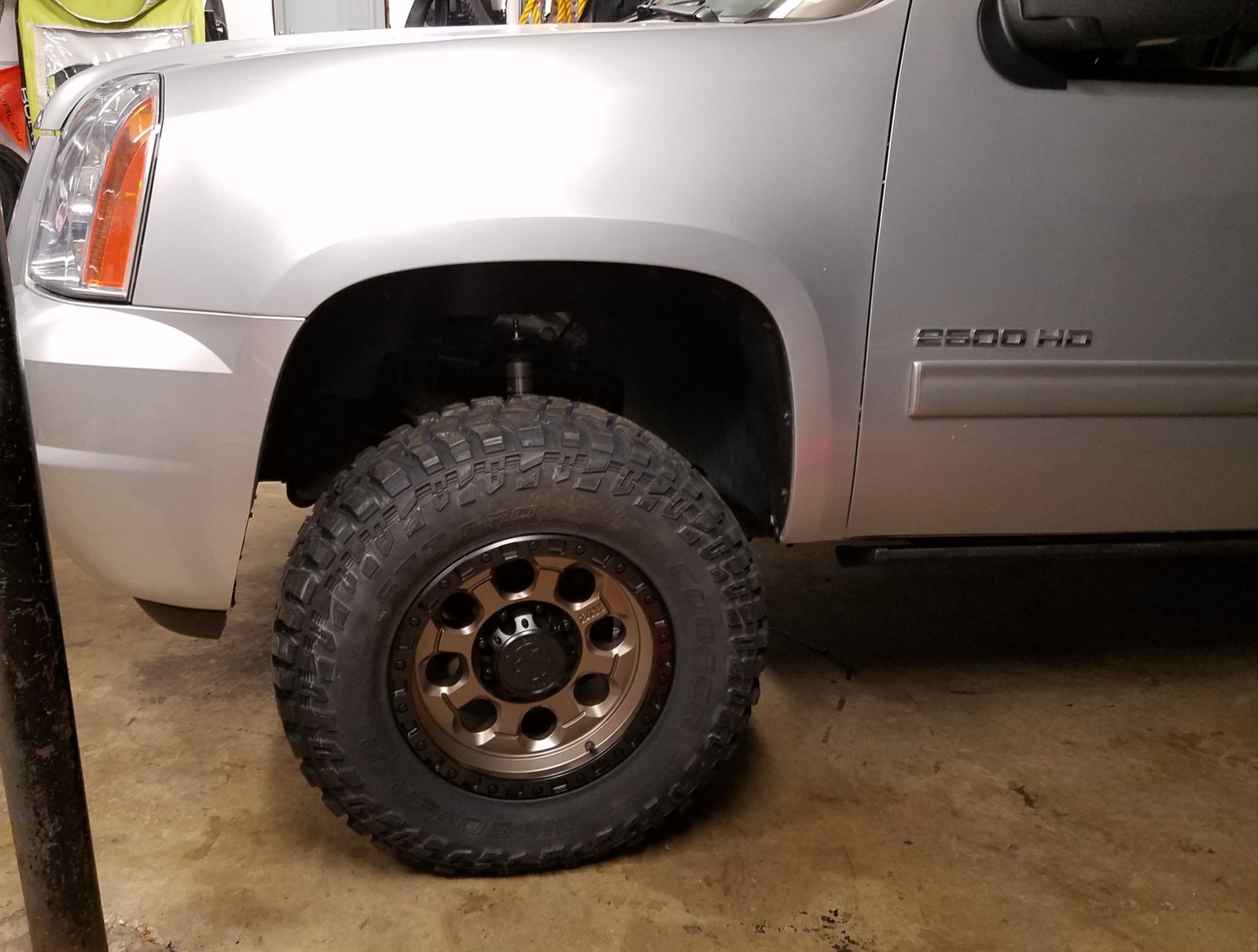

Decided to really embrace a mid life crisis and get the parts ordering started back in December. Ordered the Lift kit, so no turning back, and recently ordered the wheels/tires when I realized my 5.7" backspaced wheels would have an issue with the upper control arms on the Cognito kit.
If you saw my other thread, you already know I decided to go a different direction than most. I was tired of the GSU looking like its out of an old black & white movie, but i've never been a chrome or polished wheel person, but I'm not a fan of most black/machined wheels. I wanted more of a heavy duty, overland type of look for this rig.... not a show truck.
So fingers crossed, but I think this is going to look pretty good once complete! :headbang:

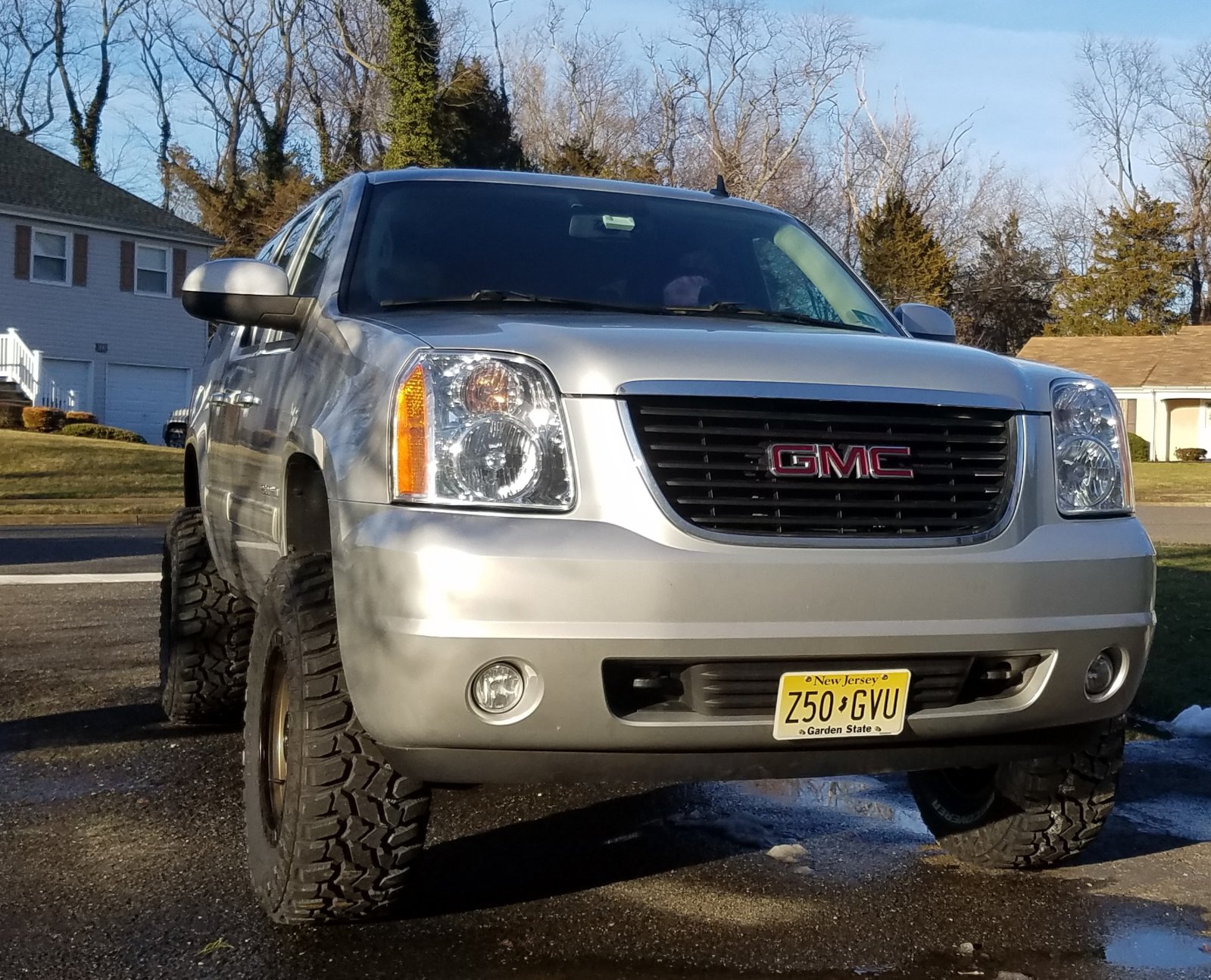

The Pro Comp bumper trimming brackets were clutch. Kinda made my own install method since I had already trimming the bumper support. Still need to take a bit more off and then clean up the edges, but it won't look much different than now.
FYI a buddy who's a car fanatic stopped by and had no clue the bumper was modified until someone pointed it out, and I didn't even give it my OCD touch yet.

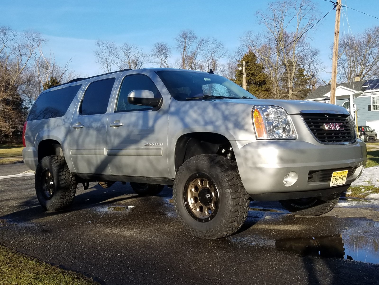

Thanks everyone! Was a busy day but the fronts pretty much done. Just need to put the splash shield back on and touch up the trimming.... Still rubs a bit, damn square wheel wells!!
Have it set around 4.5" lift and would prefer not to go higher if I don't have to.

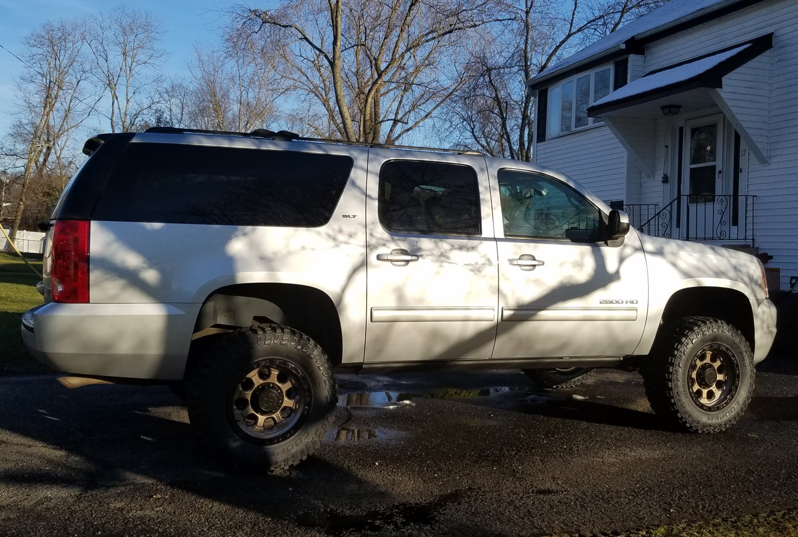

Well she's done! Will post the in process pictures later tonight, but psyched having a lifted truck again!
Heading to my buddies shop for an alignment in the morning, then I just need to wash her and wait for some better lighting for nice pictures :cool:
