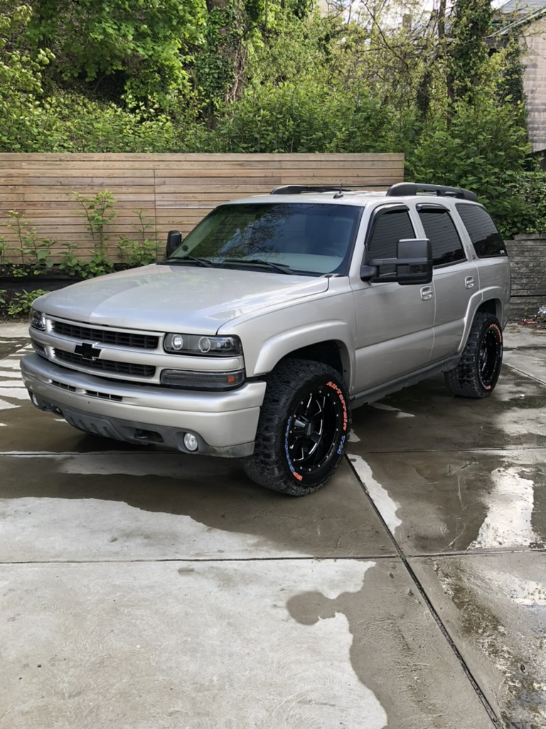

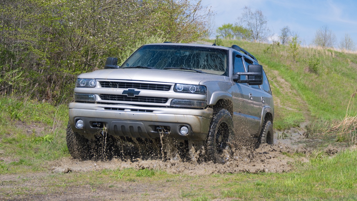

Hey y'all,
New forum member and long time Tahoe owner here. I've owned my 04 Z71 since 2012 (just cracked 200k miles) and in that time have learned quite a few things about it that I'd like to improve. I've spent a lot of time trying to freshen it up but for the life of me cannot solve these issues. I'm sure a lot of these are common and I'd like to learn what other owners have done to solve these problems. Hoping this thread can help others as well.
1. The steering is AWFUL. It's genuinely the worst I've experienced in any vehicle. When I'm driving down a straight highway holding the wheel straight, the wheels will just change direction on their own even though I haven't moved the wheel an inch. I constantly have to correct the steering every time I drive and it's been this way since I bought it. I've replaced the steering box with a RedHead unit and done new pitman/idler arms and tie rods, but none of that solved the problem. Is there a fix for this? I've looked into Cognito PISK and heard of other brands that claim to fix "steering slop", but want to find out if there's a well researched solution. What do you all do to build a nice comfortable steering system? Is there a secret NBS parts list that you can buy to create a wonderful truck to drive?
2. Going over bumps in the road is miserable. In most vehicles, you get a nice *thump thump* when you go over a bump or an expansion joint, and the noise stays outside the vehicle and you almost can't hear it. However in mine it sounds like the entire truck is crashing around me, even for small bumps. The noise very much gets inside the car- the doors, the dash, everything. I've tried multiple different shocks and even went as far as doing Atomic Fab's coilover conversion in the front. Currently running the Viking dual adjustable shocks up front and Bilstein 5160 shocks in the rear, but the problem remains. Have any of you found a solution for this? I figured doing new shocks would give it the nice quiet *thump* over a bump, but it's very stiff and bumps intrude into the cabin. Don't even talk to me about railroad crossings. Not sure if there are any bushings that need replaced - maybe the bushings that mount the body to the truck? I know it's an older vehicle, but it shouldn't be this stiff and jarring, especially with top of the line suspension.
I've been trying to solve these for ten years now and I'm at my wit's end. Frankly, these make it miserable to drive daily and take on road trips because they're major parts of the driving experience. I love my Tahoe and want to keep it for the long haul. Any advice y'all can offer is appreciated. Thanks.

How about the steering sector shaft replacement? What are the before and after alignment readings? What kind of tires have you been running? Original UCA's and LCA's with original ball joints? Live in a salt roads state? Yes, check the body mount bushings.

What are those tires - ply rating / load rating- and how much air. Meaty wide tires contribute to a harsh ride also.

If everything is tight and it does this just buy looking at your pics.I would start with your load rated d tires do you have 80 psi in those.-2nd i would re adjust my gear box i hope you have already did this takes about 60 seconds.If all that checks out for the wandering i would install a front stabilizer shock.It fixed most of my highway driving problems.So much better with it on.Kyb is what i put on their but dont like their bushings-went with poly shock bushings all good now.If replacing shocks many times has made no change and you have had the same tires on i would suggest first lowering your pressure alot take for drive and then tell us what you think.Tires and front steering stabilizer and your good to go if everything else is good.

I think the truck should track straight, but the wheels / tires you have installed may make it tough. I know when I used performance tires on other vehicles, they would really move around a lot, just due to ruts in the road, and the very stiff sidewalls, so tires alone can make a huge difference. If you have any friends with stock wheels / tires from a 2000-late model full size, maybe pop those on all four for a day or two, to see how it drives.? Keep us informed, and don’t give up on your truck. She looks very nice. :)
