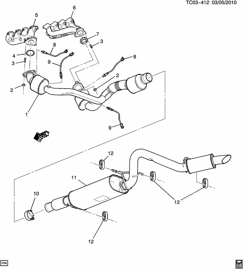

Stock 5.3L 2011 Muffler: 20882403
Stock 5.3L 2011 Cats/Ypipe: 20854453/20854454 (one looks be California emmisions or something, same size piping though)
Stock 5.3L 2011 Clamp y-pipe to muffler: 25940557
Stock 6.2L 2011 Muffler: 15896609
Stock 6.2L 2011 Cats/Ypipe: 15905949/15896591 (2nd calif emissions...etc)
Stock 6.2L 2011 Clamp y-pipe to muffler: 20779890
Since the clamps have different part numbers (number 10) on the y-pipe to muffler on the 5.3 and 6.2's leads me to believe that the pipe is smaller coming from the Y-pipe on the 5.3 than the 6.2. That being said, if you got the stock 6.2 muffler system, an exhaust shop can make an adapter to make it fit. It is so easy for them to make that fit, you could do it and it shouldn't affect the warranty. No one would ever notice that anyway.

I want to replace the cats and y pipe with the stock 6.2 cats and y pipe!
I'm trying to be clear I'm obviously failing.
Thank you for finding those part numbers did you happen to notice if the exhaust manifolds had different part numbers going from 2011 hoe to 2011 escalade.
I'm really serious about this mod I just need to clear up the fittest questions.
I'll try to state it again.
The only thing I dont won't to replace is the manifolds. I want to have the Gm parts with now aftermarket welding or parts.
I just need to know if it's a bolt on.

Yes, the 5.3 definitely has different manifolds than the 6.2. I get what you're saying and I understand what it is you want to do. But, since I do not have personal experience with the new exhaust fitting, I do not know for sure.
I am pretty sure how this works though...coming out of your y-pipe should be a 2.75" pipe or something very close to that. That will connect to a very similar size pipe. If you get the exhaust, from AFTER the y-pipe and back...you will have a 3.5" pipe. So, what I am trying to get at here...you'll basically be trying to connect a 2.75" pipe into a 3.5" pipe. Will it bolt up exactly like factory at this connection pint? NO.
Can it be made to work with ease? Yes...
You aren't messing with anything that has sensors or anything, so I wouldn't worry about it. It is not going to void your warranty.

So I can't put the 6.2 part number 1 in the diagram on the 5.3?

I just realized I typed way more than I need to. So, you basically want to add parts 1, 10 and 11?

If part #1 is 3.5in, then the flange will probably not fit the 5.3 exhaust manifold. I would look for you, but the wife has the truck.

And well I'm pretty sure the flange size above the cats is the same but if you could check for me when you the car that would be fantastic!

The manifolds between the 5.3 and 6.2 are different. Pretty sure it won't bolt up, 5.3 has 2.75" tubing behind y-pipe, 6.2 has 3.5".
Just have a shop weld in a flo-pro big oval muffler that is slightly louder than "stock sound"muffler. PN 2510 is a 3.5" in and out, used on NNBS 6.0 and 6.2 trucks. A muffler shop should be able to make adaptors to go from 2.75" to 3.5", plus it will be TONS cheaper than what sounds like you are working on

Yes, the manifolds are different, but the connection at the manifolds is the same on the 5.3 and 6.2.
