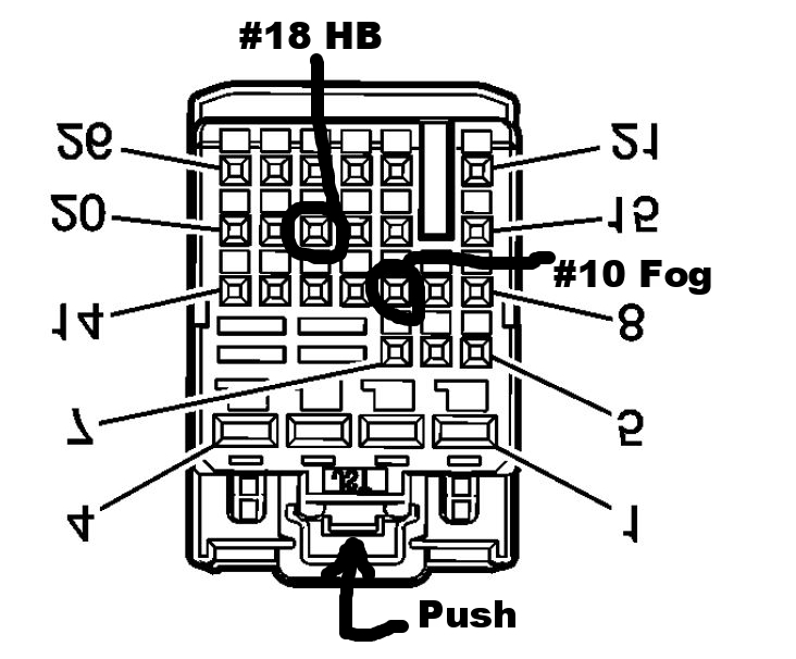

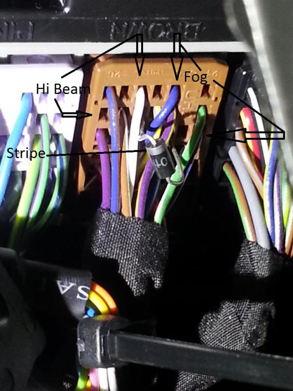

dbbd1
May 12, 2017
924
357
There are a few threads on here about this but here's a couple of pic's...

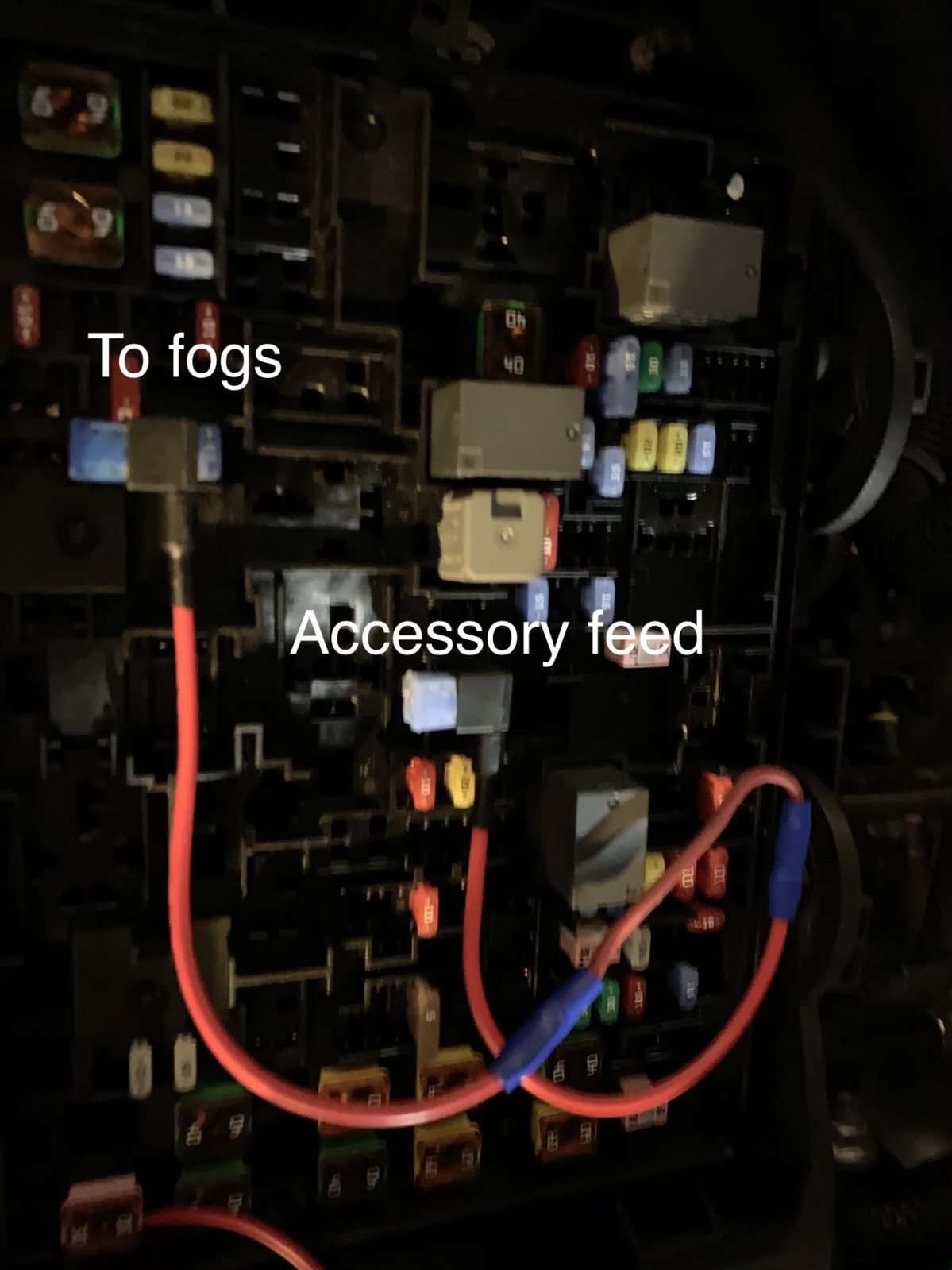

Anyone ever figure this out? I never could figure it out.
I’ll post my pics later. I did it with a fused jumper from a accessory source to the fog lamp fuse slot. Headlight auto feature works now with fogs on all the time.
RST Dana
EMT/First Responder Firefighter Supporting Member
Jan 15, 2018
1,982
1,863
OH
You can locate the accessory post with a volt meter.
