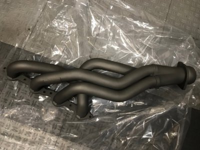

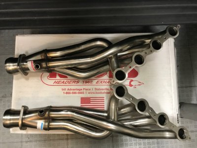

Got my headers back from ceramic coating.

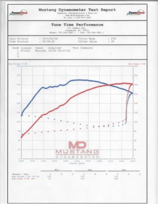

@Tonyrodz, Wanted to put my truck on the dyno today, to see where am I at number wise, so went to Wicked Motorsports down on Route 37 but they couldn't fit the truck in the shop because of the setup they have raised dyno and low overhead doors. Tried Procom Racing across the street but they do it by appointment only and it was at the time of their lunch break. Not my day or people not in the business to make fast money. Will try Tune Time Performance in Lakewood tomorrow.
Where are they in Lakewood? I'm around there occassionally, I was there today.
