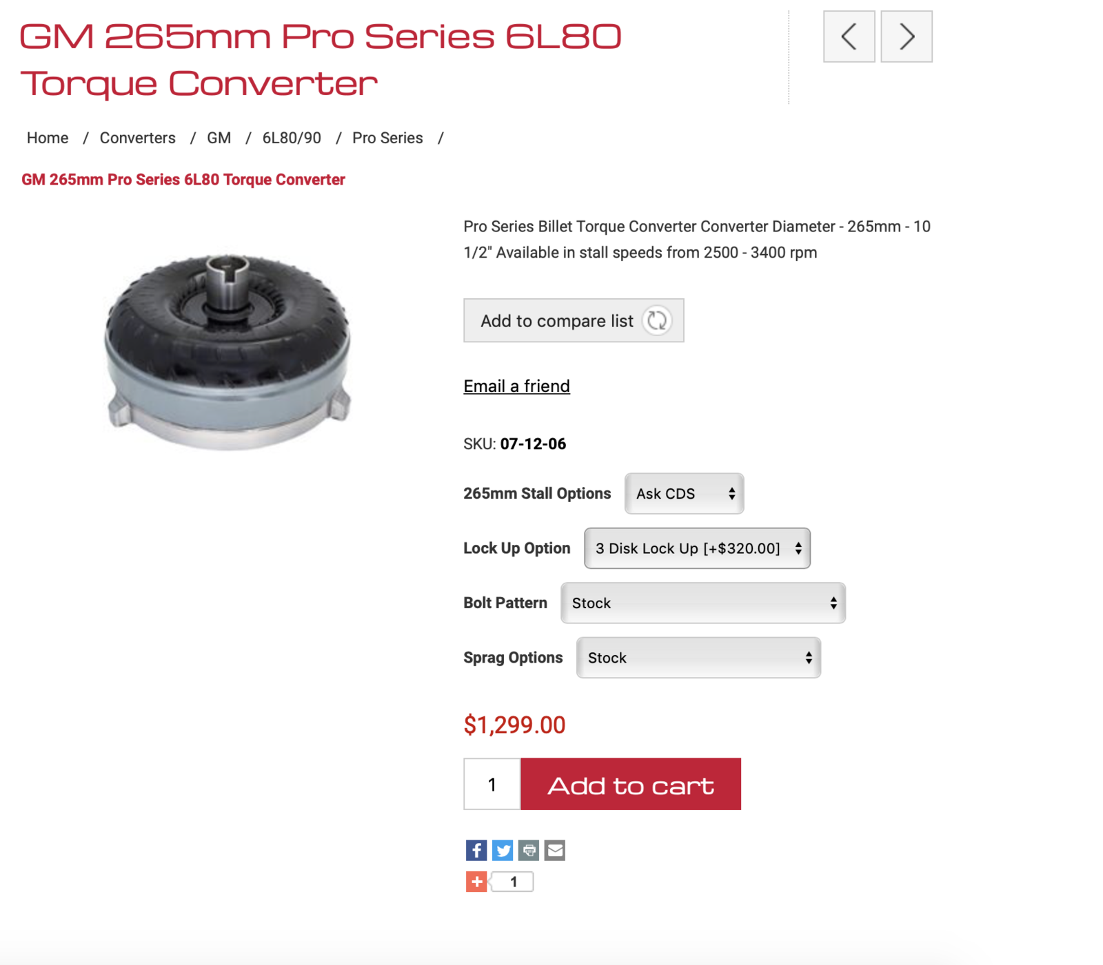

is that the one you guys are talking about 265mm triple disk lock up?

how do I know that is a 265mm not 258mm or other? sorry if it a dumb question
Not a stupid question.... Get ahold of Chris or Glenn @ Circle D and see what they suggest. I got the 265mm Pro Series Triple Disc. 2,800 stall in the 1A Stator combo (for a tight stall in a heavy truck). I got mine from GWATNEY Performance for $1175 shipped direct from Circle D. They do one free stall change or repair if you blow it as many of the high end companies do. I considered others, always came back to Circle D. Nothing but great things and service from them.

I didn't know about the 1 free stall change or the free repair. Do they also only do that once? I bought mine through the garage that did my mods.

now why would I need to replace the stall?
They do one for free if you break it or simply want it tighter or looser
Just in case you break it or decide you want a looser (higher) or tighter (lower) stall. You want it as tight as possible with these blowers since they make so much torque down low.
