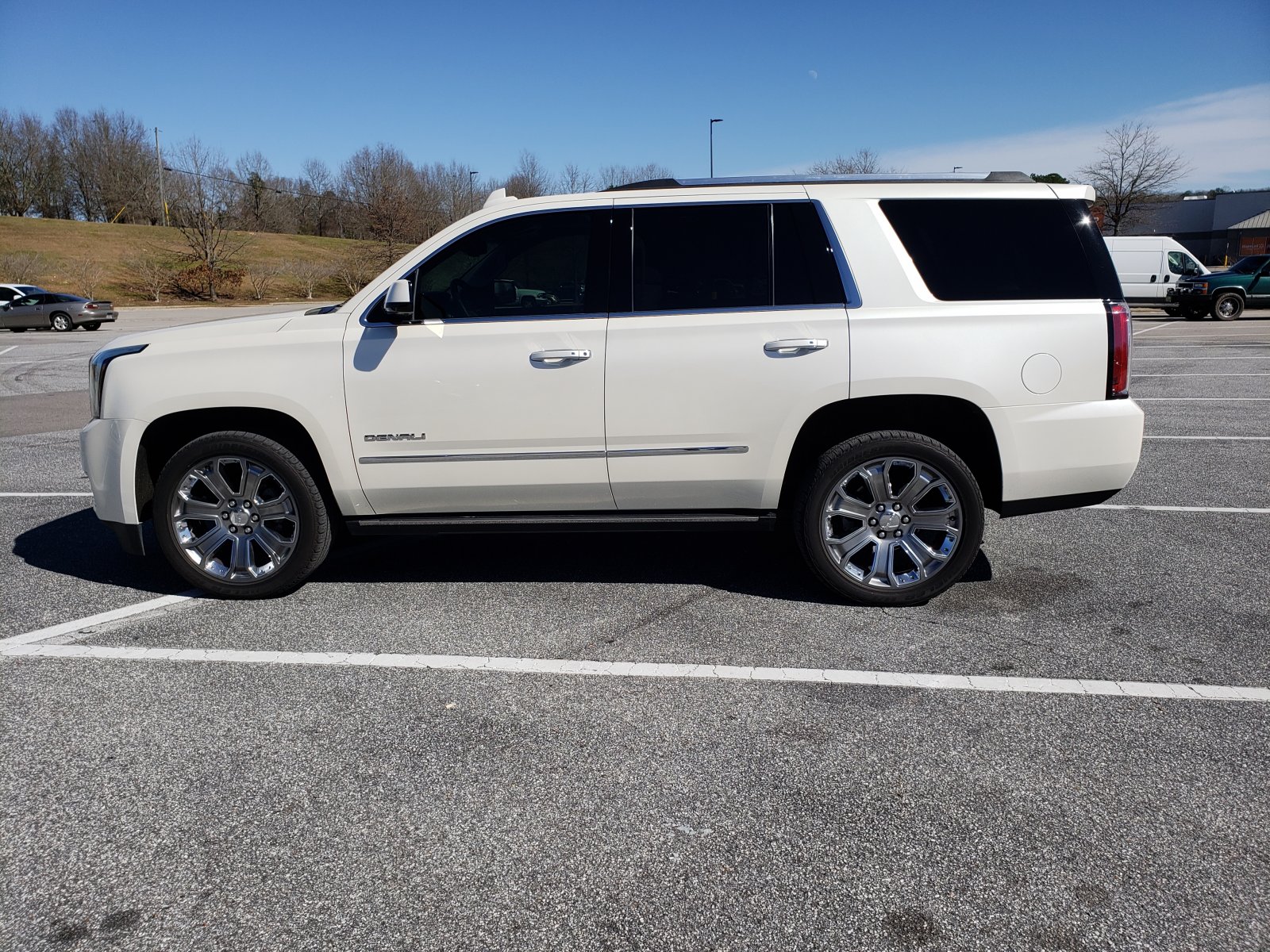

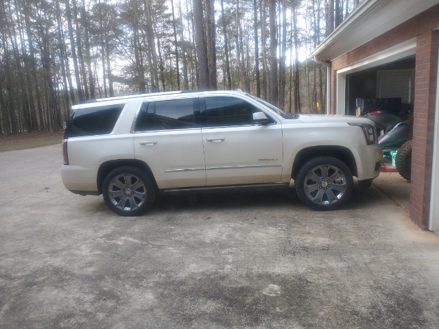

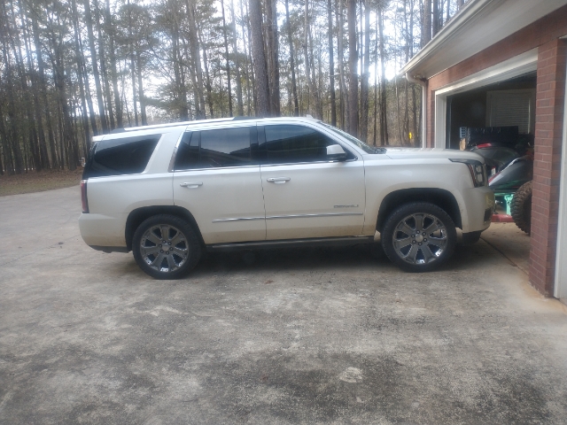

here's a pic I just took. as you'll see, the front is super low
Wow yea that is much lower than factory. There really is no way for them to be installed incorrectly…bolt em to the top with the 3 bolts and then at the bottom with the two bolts…so not sure what you could change with the current units. If you want it back to the stock height you could add leveling kit to it i suppose. Or if you have the original units still, maybe the coil springs could be swapped onto the new struts? Me personally, i would put a lowering kit in the rear haaaaaa and call it a day.

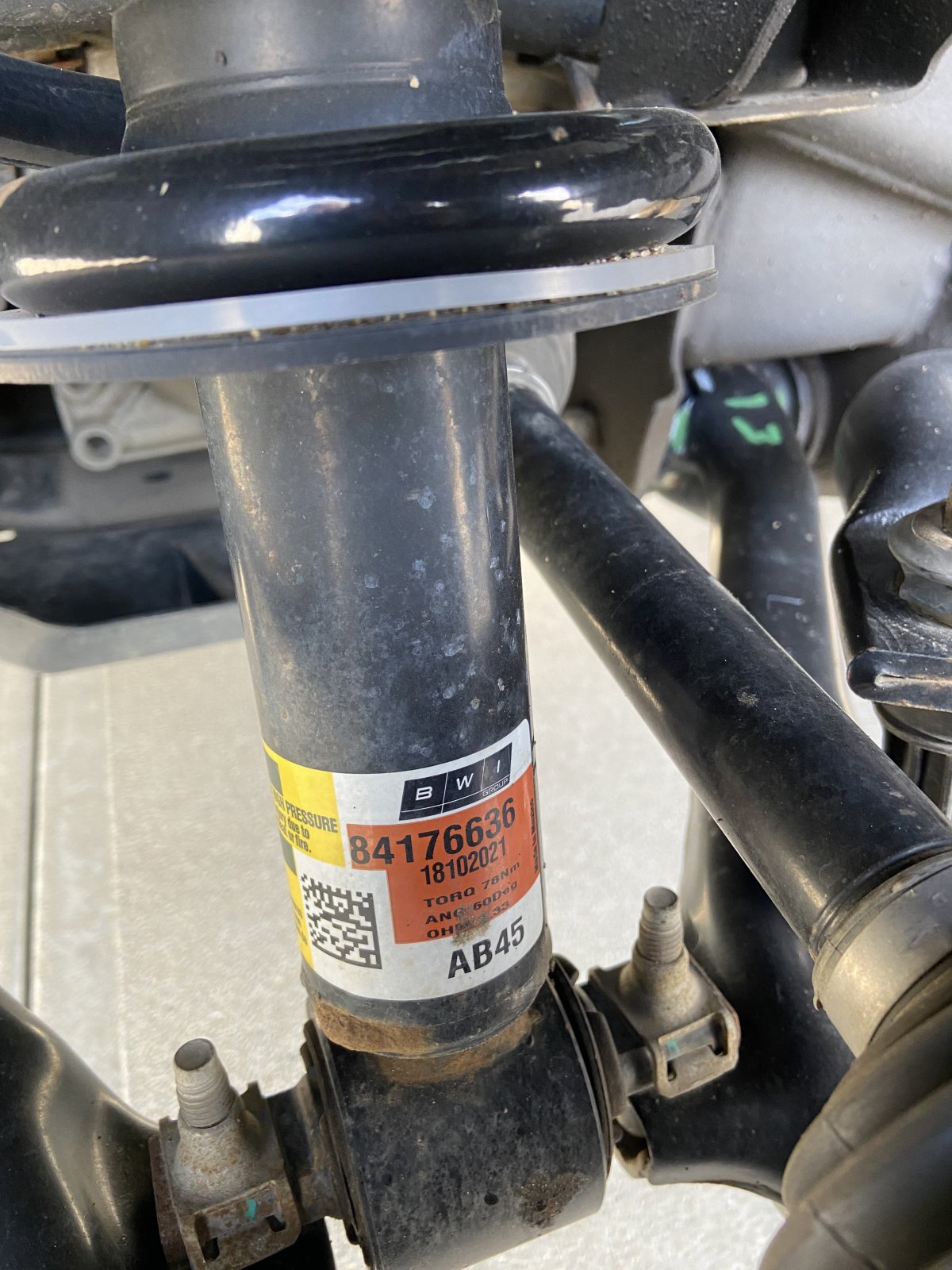

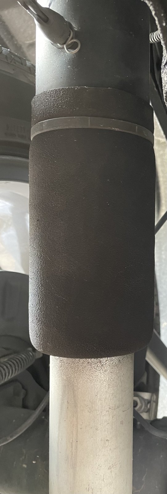

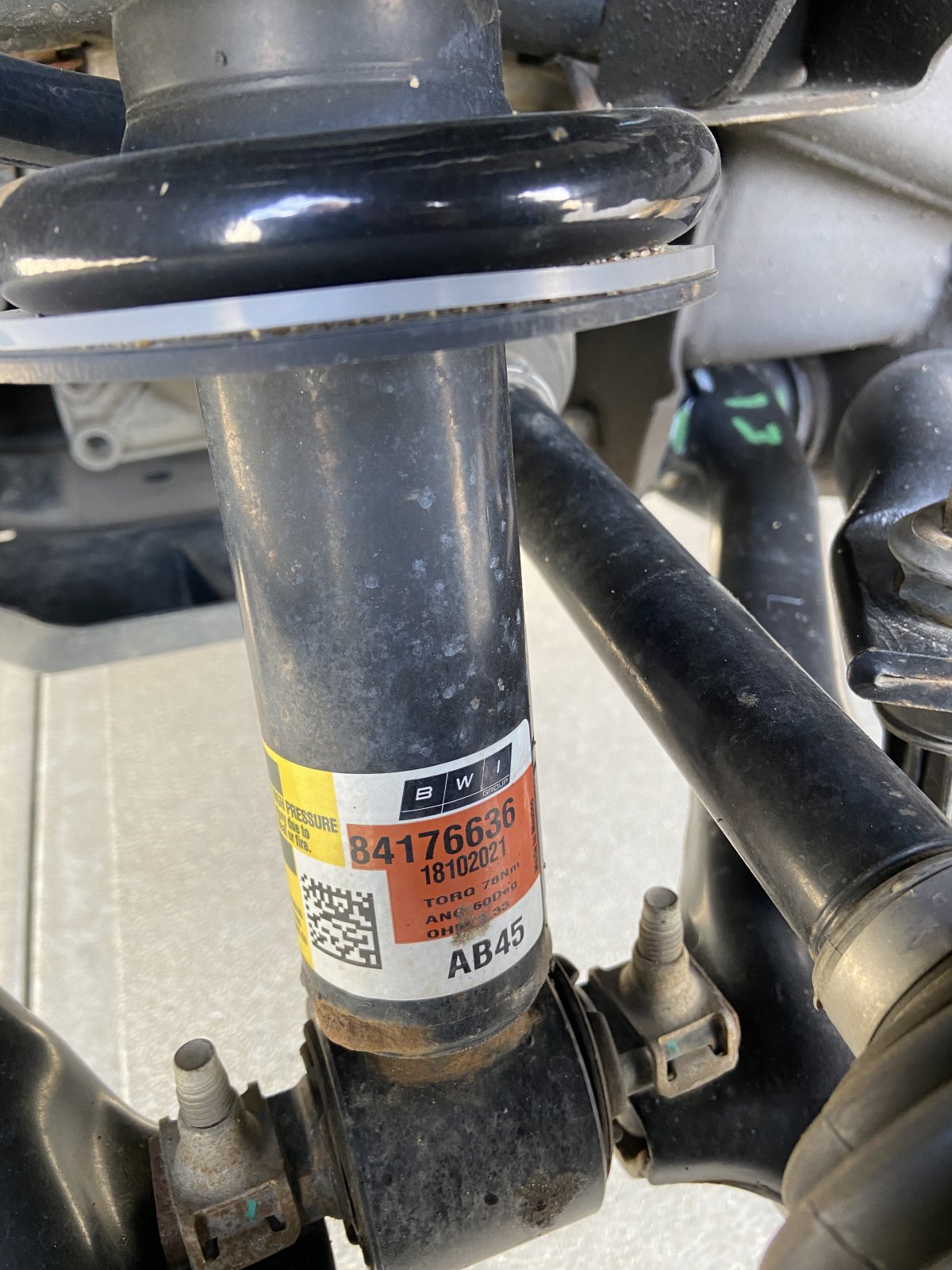

What is the best way to tell if my Magnetic shocks are going? I am at about 55K miles on a 2018 Yukon Denali, and the ride is extra bouncy and seems to pickup all road imperfections. I would not call it overly harsh. Had not really noticed it getting bad over time, but now that we have a new BMW SUV, the rough Yukon ride really stands out. Attached is a picture of one of the rears.

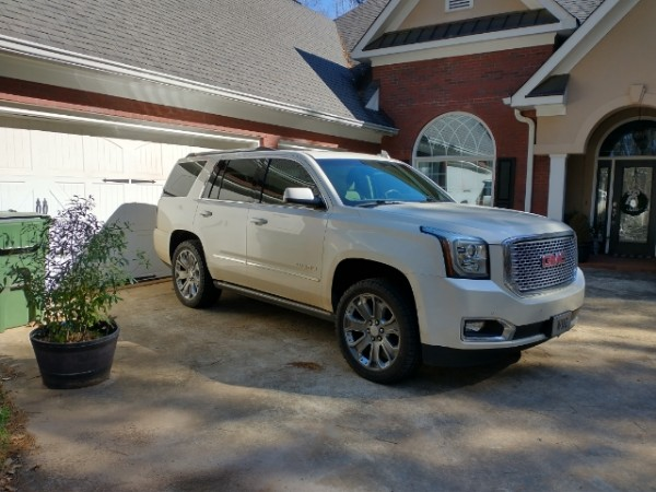

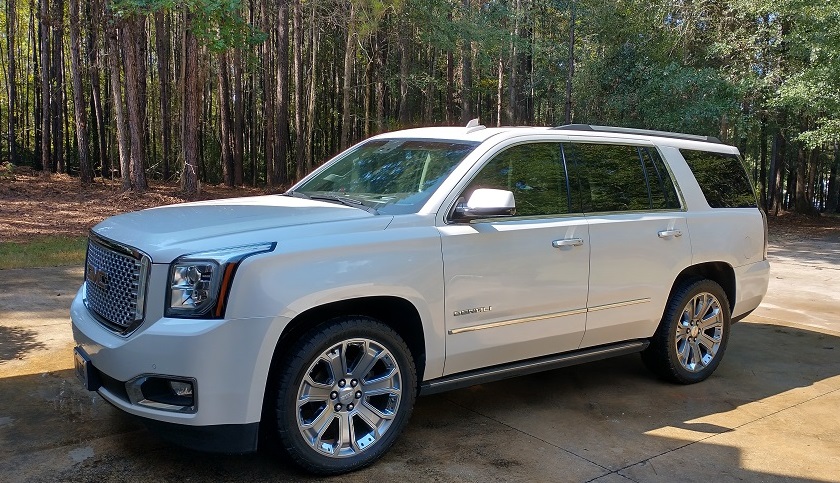

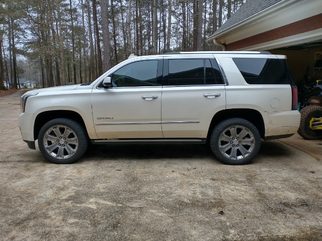

Whatever the case is, here's my story -- late-2015 Denali 2wd, factory 22", mag ride stuff replaced under warranty at 62k miles. I also lowered the rear using McGaughy's 30014 because I didn't like the huge rake.

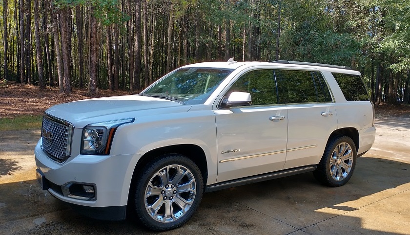

Stock, about 2k miles after full OEM MRC replacement front and rear:

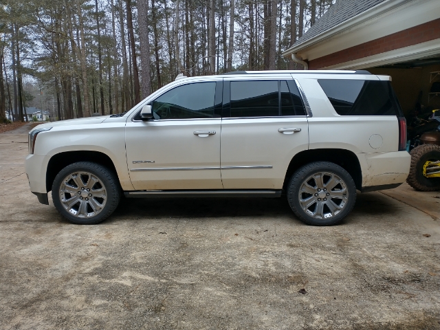

Lowered with the McGaughy's 30014 -- It was perfect to my eyes like this:
Now at 123k it was riding like crap. I did the recommended Monroe quick struts on the front, 139104 plus the AC Delco 540-1675, using the OBD-SS to make the computer stay happy. Rode great, but, uhhh - that nose was WAY up there.
So I drove it around for a week or so to let the new front springs get settled and broken in, also goofed around with rod lengths on the back to see if I could get the air to help bring the back up a bit to match. It got better, but still looked like shit.
So, reluctantly I put the stock rear springs back in. Basically I ended up back level, but by raising the front with these Monroes that were supposed to be stock height. They are easily 2" taller than what came out now that they've settled. I really didn't want a lift, but it is what it is I guess. At least it rides great now. I wish it sat lower, but not so much that I'm going to do spindles or anything.

Looks great both ways imo, once leveled! I fought my wife for a little bit to get the lowered stance, but she eventually one (and it was her rig) so i raised the front instead of lower the back. I prefer the slightly lower stance, however. Your rig looks great!
