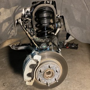

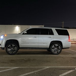

I have the Z95 suspension on my Denali and did the Arnott replacements. Way better than stock and air leveling still works. I recommend it even if the Maganride hasn't gone bad yet.
Does yours sit level with the new Arnotts without a leveling kit? Mine does and according to the person I talked to at Arnott, it should sit exactly the way it did with the AC Delco Z95s without a leveling kit, however that is not the case.
^^old vs new Arnott SK3354
^^driver side
^^passenger side
^^how it sat with new struts with leveling kit installed
^^how it sat after removing leveling kit
Not that I'm complaining that it sits level with the new struts without a leveling kit, but just wondered if anyone else has this issue or if mine are somehow installed incorrectly? Although I'm not sure how they could be installed incorrectly...
Fifty
Jun 26, 2015
844
239
When I first put my Arnotts on the front rode high. As if I had a level kit on. And at about 100 miles it settled back to stock height.
I really want a level kit now.

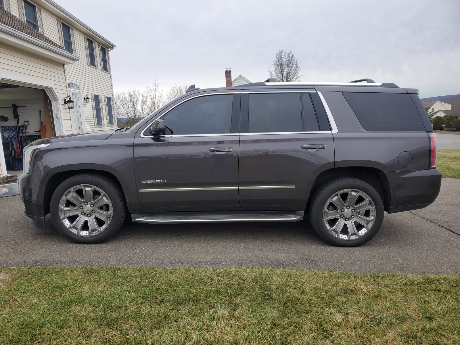

BigPete
Jan 3, 2022
Hi everyone. I just joined the forum and have been reading through this thread (and the whole suspension section) trying to learn what I can about the mag-ride set up, but I still have a few questions.
I have a 2015 Yukon Denali with roughly 80k miles on it. The ride got terribly hash, so I knew it was time to do the suspension
I replaced both the front and rear suspension last week and 2 things are happening. First, I got the "service suspension system" message on the dash, so I'm going to check the front wire connections to see if something is wrong. But more importantly, the front end is VERY low - only 2-3 inches of wheel well gap, whereas I am used to seeing 4-6 inches. I'm going to the dealer to have the mag ride recalibrated, but could this even be the cause for the truck to sit so low? The rear also seems to be somewhat higher than expected, but it may just be because the front is so low.
I bought these parts and am assuming they are correct, but there is always the chance I screwed that up...
https://www.amazon.com/dp/B07WD36VY7?psc=1&ref=ppx_yo2_dt_b_product_details
Overall, the truck rides 100x better, but there is definitely something wrong with the front and how it sits.
Please let me know what you think may be going on, and if I can give any more info, let me know
thanks

Yes those look like the correct units. The front ride height is determined by the springs, nothing to do with the mrc shock, so a reflash will not change ride height. How about some side pics of the current ride height…
BigPete
Jan 3, 2022
here's a pic I just took. as you'll see, the front is super low
