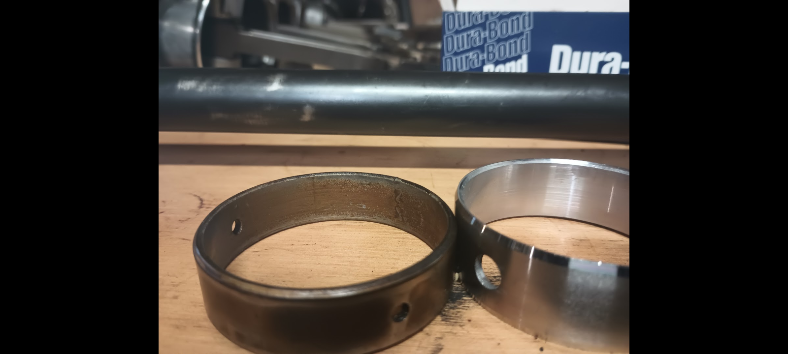

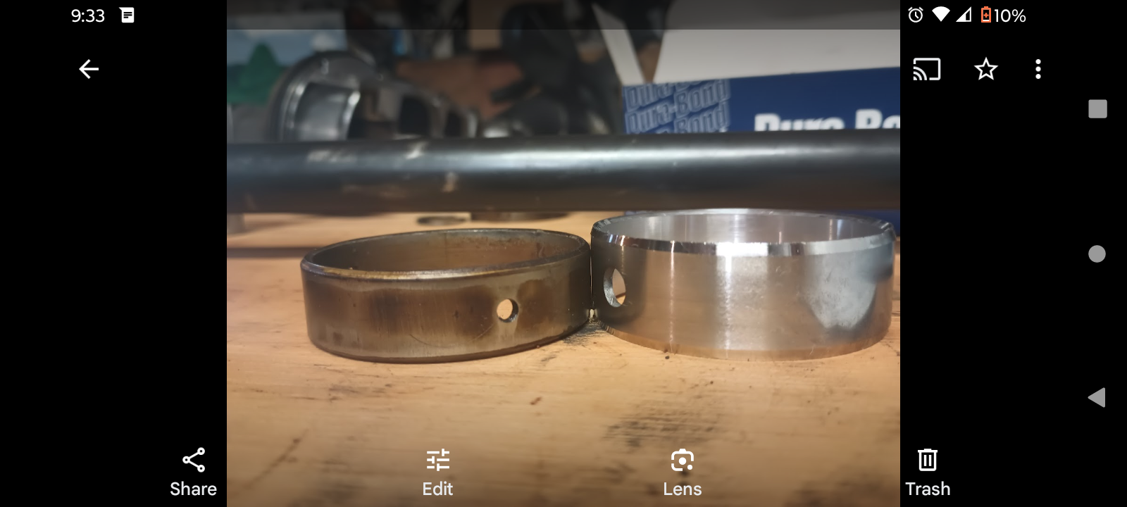

Yup, I've installed those Durabond CH-25 bearings on the few Gen III LS engines I've rebuilt. Although I didn't have to ream the cam holes edges.
I bought the dedicated Summit Racing cam bearing installer. Works very well. First time took about 45 minutes, but second time took maybe 15 minutes at the most. Just put a sharpie mark on the edge of the bearing to make sure they are "clocked" correctly for the oil passage slot on the block. Easy peasy.
Those were the cam bearings from my 06 Suburban LQ4 @ 260k FWIW.

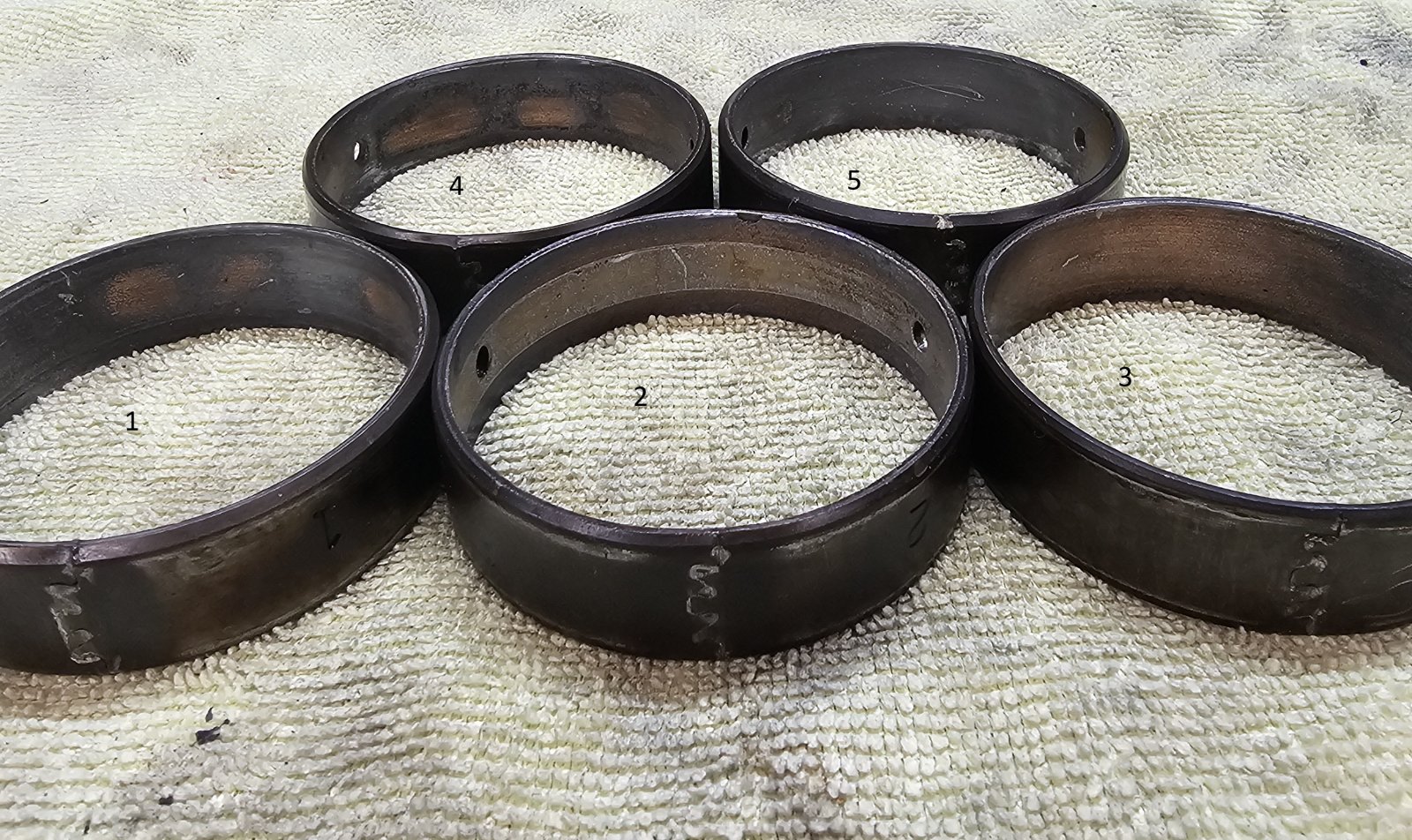

Here is a shot of my bearings. The #2 was horrible. Probably had a .010 ridge between where the cam runs and the center section.
You can also see where the bearing is joined and causes the gouge. Wonder if GM did that on purpose to help stop them from spinning?
Engine has 175K if i remember right.
