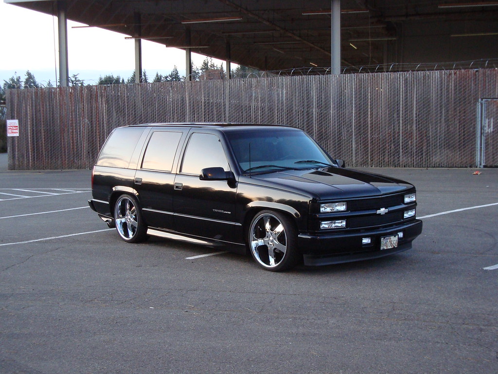

I have a 2/4 drop
Wow Roadrage your ride looks sick as hell!
Roadrage
Sep 11, 2009
15
Bremerton, WA
Thanks.. It's OK for a daily driver that just turned over 100K. I could use a sparkly new paint job though. I like yours too are those 24's because I was thinking about sqeezing 24's on mine.

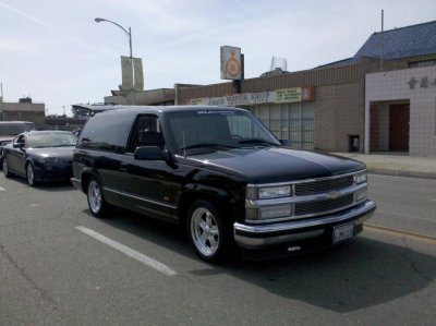

I agree you will prob be happier with the 4/6 drop if your not wanting to sacrafice ride,and I do believe Belltech has a 4/6 cause thats what I have

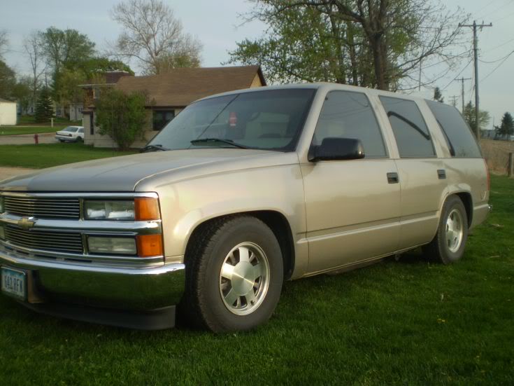

Roadrage your hoe is freaking kick ass thats what i am looking for after i trade or sell my 4wd hoe to get a 2wd hoe
