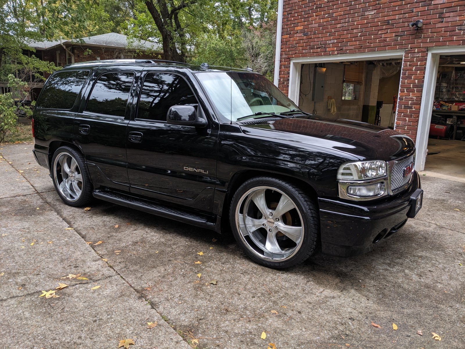

willinnashville
Jun 2, 2013
320
454
Nashville
I love the looks of mine a couple inches lower front and rear. It's a Denali with AWD so it was never gonna be a serious off roader anyway.
I have belltech spindles up front that I got used and a rear belltech 3/4" kit for the rear
