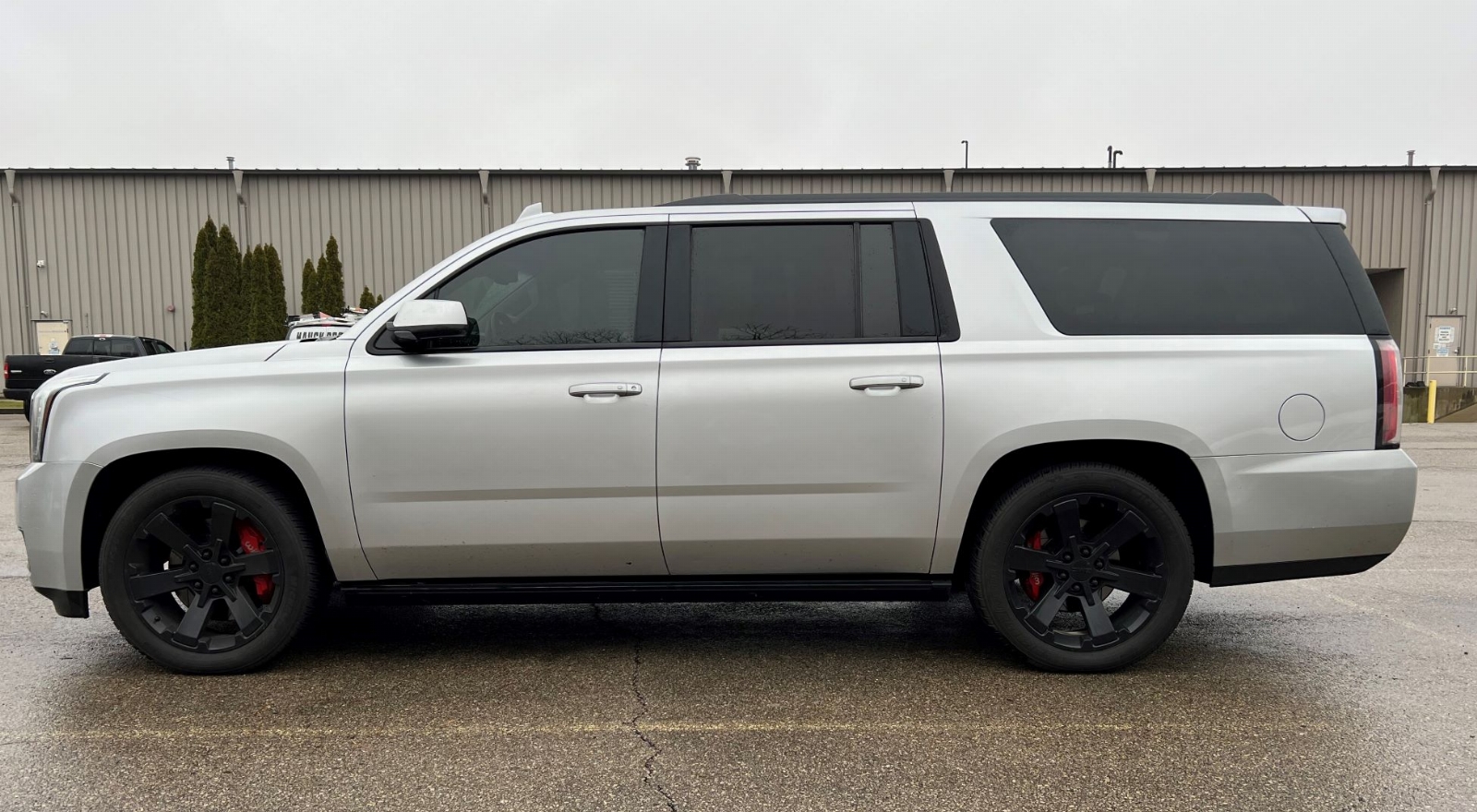

Here are my before and after measurements:
*With OEM 22" wheels and 285/45/22 tires Front ride height measureing from ground to fender lip measuring vertical up through center of wheel (center cap)
STOCK FRONT = 35-1/4"
LOWERED FRONT = 34"
I only got 1-1/4" drop up front out of the Belltech 2" Drop Spindles.
STOCK REAR = 37-1/4"
LOWERED REAR = 34-5/8"
Dropped the rear 2-5/8" resulting in a 5/8" rake from front to rear.
It's a cold crappy rainy day here in Ohio, so excuse the filthy truck but here's a pic of what that ride height looks like right now:

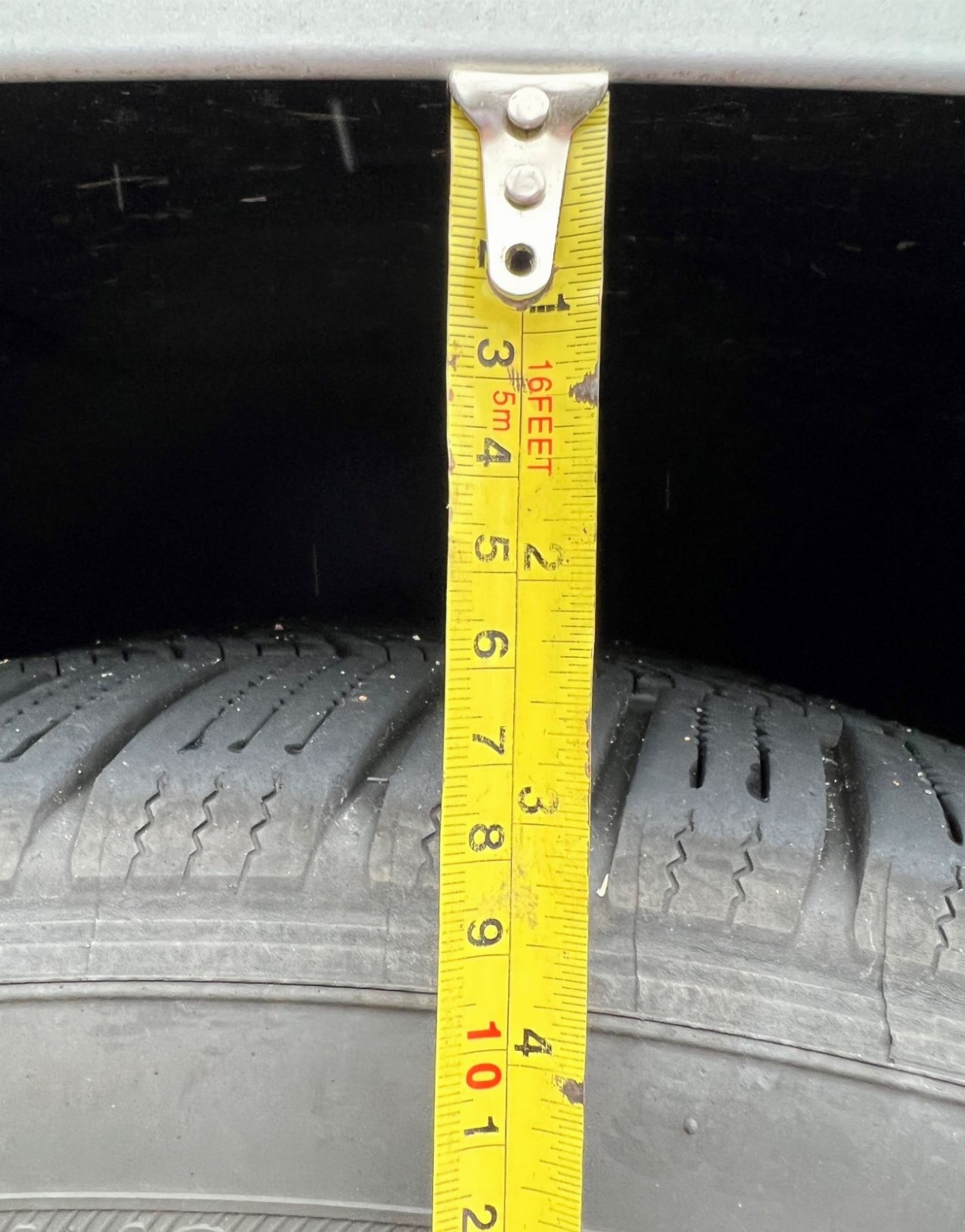

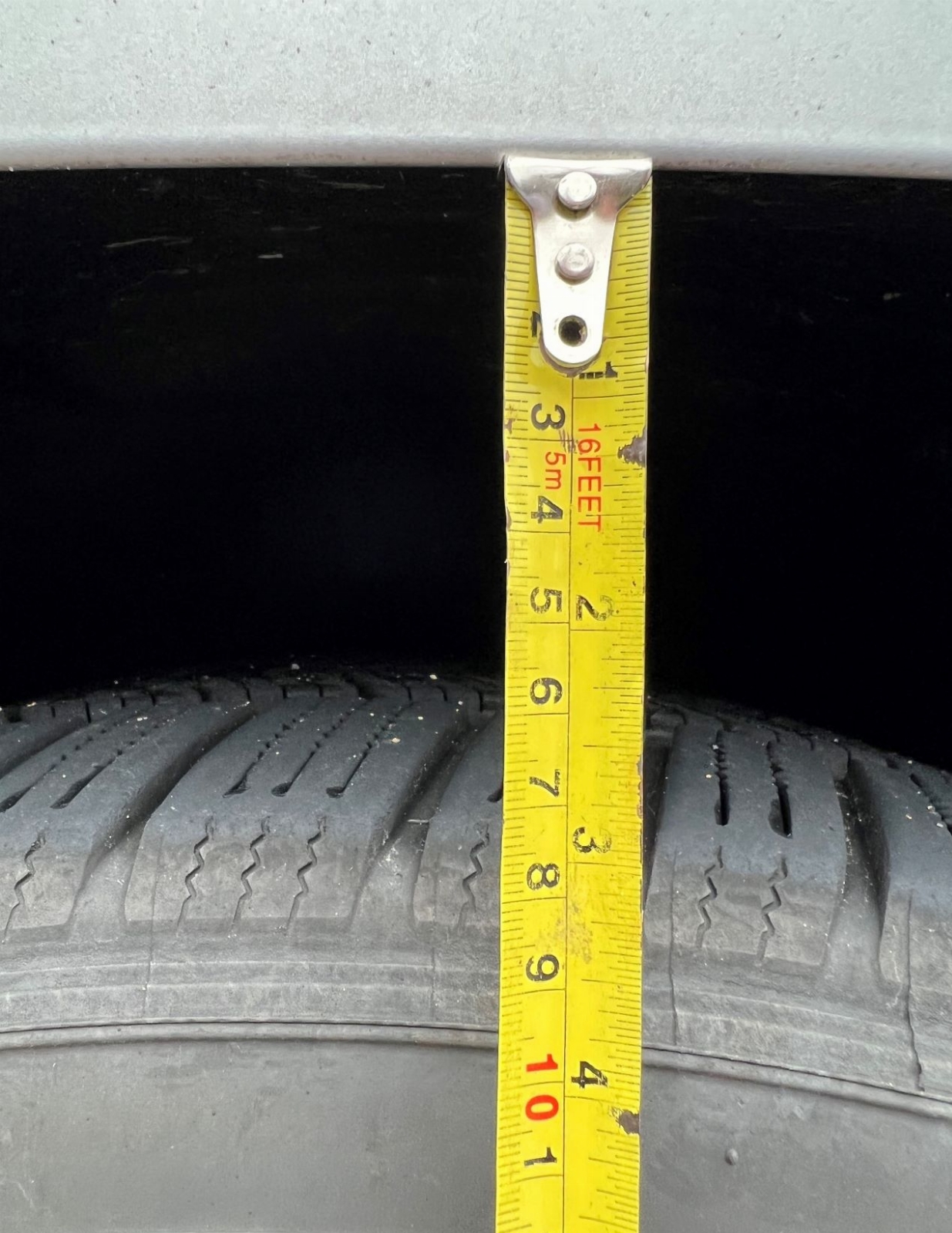

I also measured my wheel gap since that was what you're after or using as a point of reference for how much you wanted to drop your Tahoe and I have about a 3" wheel gap (+/- 1/8") both front and rear.
Front Wheel Gap:
Rear Wheel Gap:

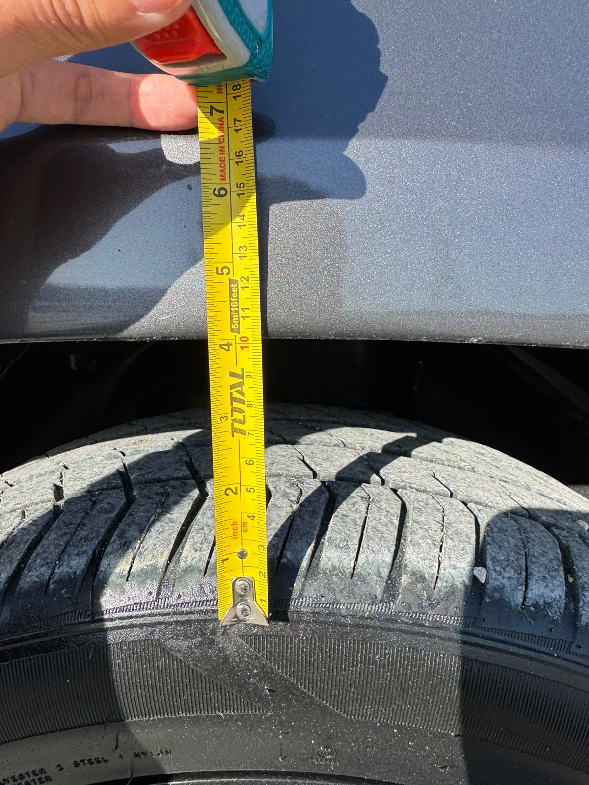

Hey, I was quite interested in joining the forum, since I have been reading and analyzing all this for several days. I have a lot of questions about this and I think you are the right person to help me.I know everything written here is a little old, but I hope you are still present.
tahoeltz2011
Nov 27, 2024
At that moment when you lowered your car, you had to change the oem bump stop?

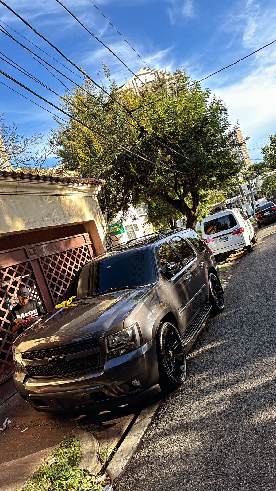

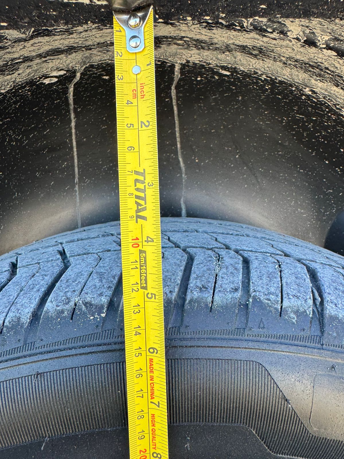

I am from the Dominican Republic and this is my truck with 22 rims. A few days ago I changed the rear shock absorbers that were dead and along with the change my truck went up significantly and I was reading on this page that it is advisable to trim the level sensor. How much do you recommend it?
tahoeltz2011
Nov 27, 2024
@CMoore711 jajaja with a little shame i will tell you to cut the oem springs.
Everything was fine until I changed the shock absorbers and compressor.

Now that your shocks hold air they’re keeping the rear at it’s normal level. The ride height sensor rods can be cut down but it’s hard to say how much since you cut your springs.
@Doubeleive may know a good starting point. If you didn’t add shock extenders do that too.
