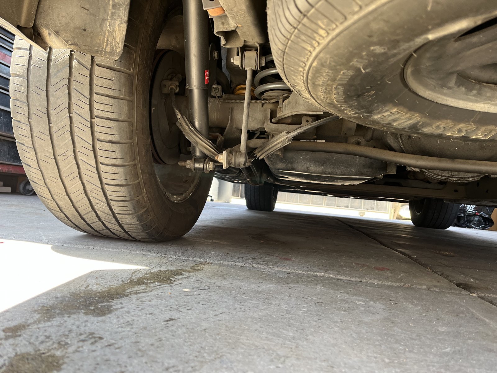

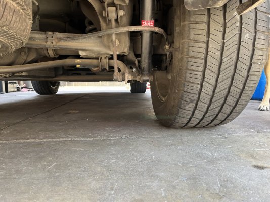

Thanks I took it to a shop and was told that my sway bar needs to be parallel to the floor and mine at the moment is towards the floor

2nd part of your problem are those shocks. I had them on for maybe a week or 2 then tossed them in the garbage. They suck. Do you have ZW7 in your rpo codes?

I have Bilstein 4600. ZW7 comes with the Nivomat shocks, which are really firm, so the springs are a little soft. You can't use non Nivomat shocks with the Nivomat springs, if you do then you'll be experiencing the exact conditions you're having now. Same thing happened to me until I used lowering springs. It was really scary driving on the highway. It was like someone was pushing it side to side in the back.

Getting shorter end links in the rear to level the bar would increase its effectiveness. How about the front? That's where the rear story lies when it comes to excessive sway. But, also with the rear, the springs could be too soft. When driving straight and you hit a bump, does the rear feel cushy?

Check the front sway bar links and make sure they're in place and in good condition. Also the front jounce stops need to be contacting the lower control arms.
Lots of people make the mistake of changing the ZW7 suspension by replacing the Nivomat shocks (the G65 RPO code) with standard shocks, and without going to a firmer spring. Makes things really squirrely.
