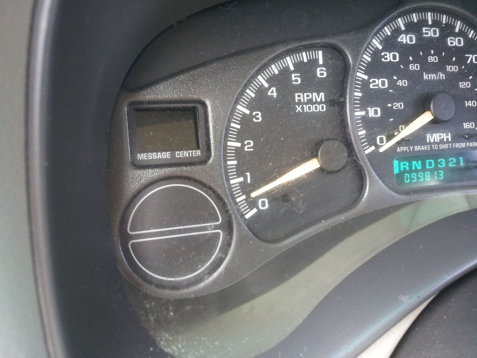

Ok guys I decided to open a thread specifically for this reason. Truck idles between 400-500 RPM's.
Ok, let it be known, the truck idles SUPER smooth at 400-500 RPM's. However at these lower RPM's the alternator is failing & the A/C stops working.

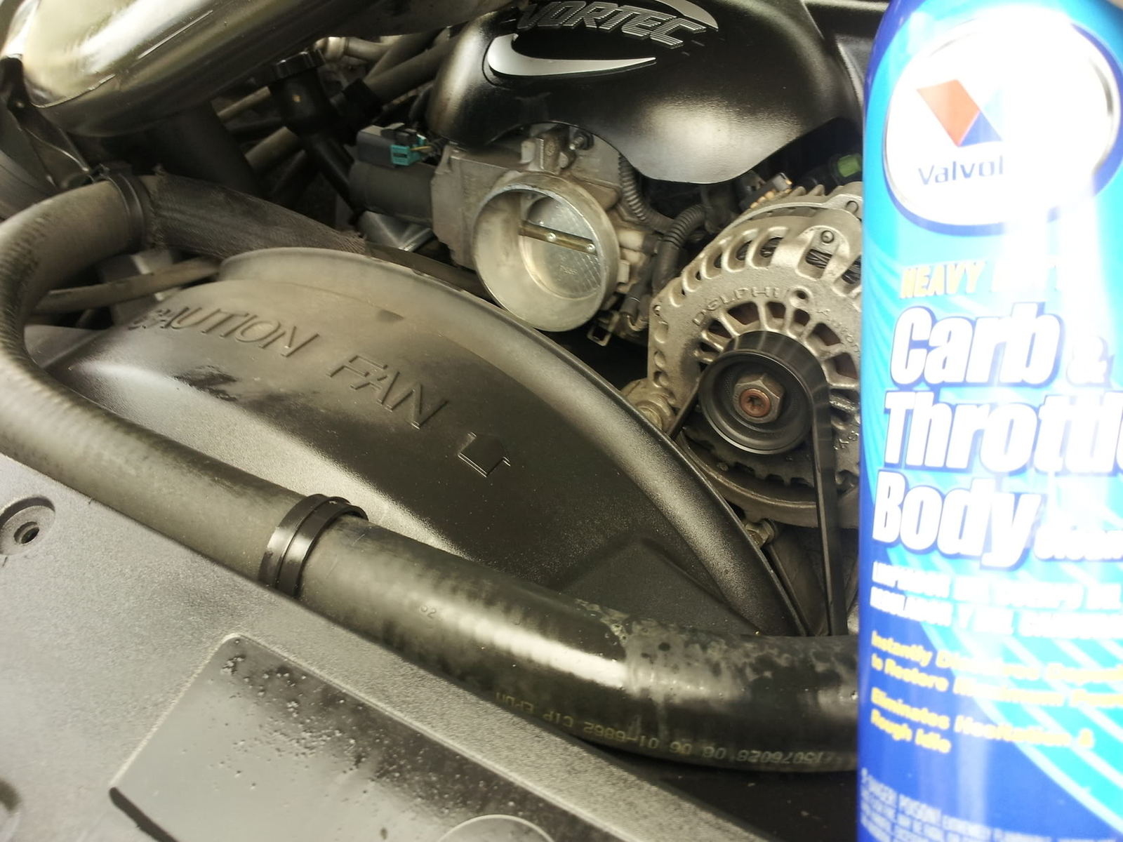

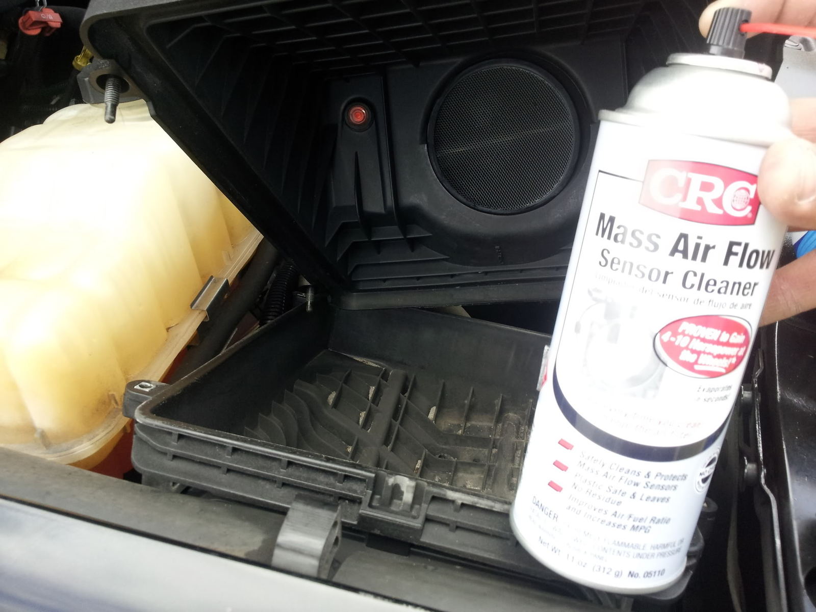

Today I cleaned the throttle body & the Mass Air Flow sensor. Nothing. It's still the same.
Has this happened to anyone else? I don't want to start buying parts & swapping parts on it just to swap & end up on the same boat.

So i had that happen to me and i found out that my alt was not charging as it should. So i bought a new one and the rpm jumped up to like 700-800. Che k your battery as well hope this solves your problem:)

I get worried when it's NOT idling at 500-700, similar thing happened to me as LowHoe stated... ever try and see what happens when reving the engine a couple times? couldn't hurt to try

ALright guys, battery tested ok but crank amps were low(550). My stepfather had a battery with 700 crank amps. No more dead battery. Howevery my RPM's are still the same.
That's kind-of my first instinct. Do it all the time. Doesn't do anything. :(
