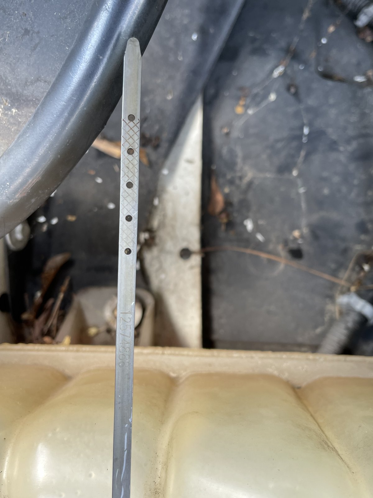

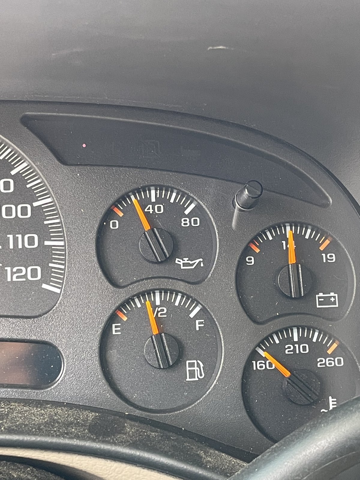

I have a 2004 Yukon XL 269,*** miles I bought about two weeks ago. I changed the oil right after getting it. Filled to the second line from the top. Drove for about a week around town to make sure everything was ok with it and it ran fine. Took a 6 our trip to Tennessee, about 5 1/2 hours in I lost oil pressure. Checked my dip stick and the oil level was at the bottom minimum line. I haven't seen any oil leaking so I'm thinking it must be burning it. Got a fresh oil change and added a quart of Lucas high mile oil stabilizer. After that, the oil pressure rides about 20 psi on the dash gauge. I bought a pressure tester gauge from Auto Zone and that reads about 25 psi. So I am thinking my oil pump should be good? I have read online that the O-ring on the pick up tube is a common problem. It runs fine. No ticking or any noises. Had a mechanics stethoscope on both valve covers. It sounds smooth. Is there anything else I should look at to diagnose other potential culprits? It's a 4wd so pulling the oil pan is going to be a big task just to change the o-ring. Thanks for any input.

Thanks for help. I don't think its the sensor since the dash gauge and tester gauge are pretty similar. I think I'll try the extra oil and see if that makes a difference.
