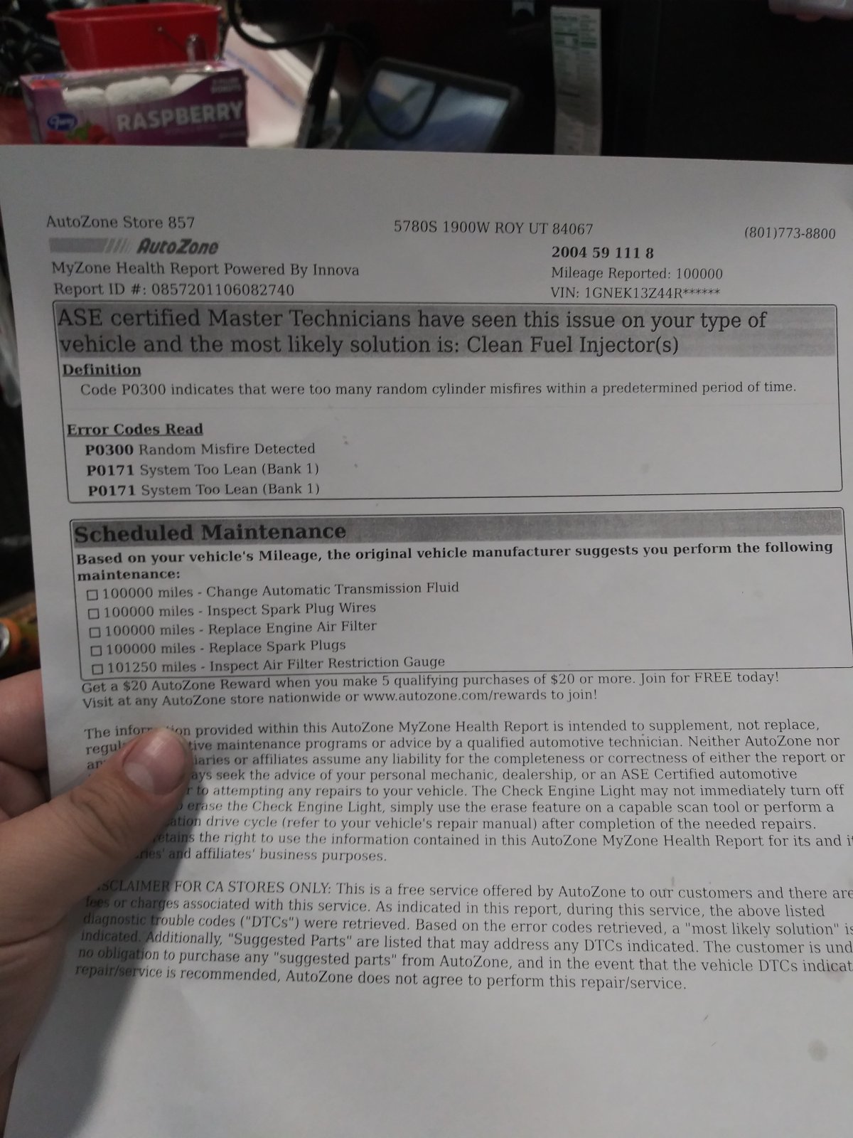

Okay so I am sorry about the delay in reply I had to do a bit of work irl (unrelated)
My Truck is a 2004 Chevy Tahoe LT 5.3 V8 w/E85 FF Tech it is the 1500 series it has 256,904 miles on it and current codes are P0300 Random Misfire Detected
And P0171 System to Lean <---This one throws 2 times and it says most likely solution is to clean the fuel injectors. So I just put Lucas injector cleaner in on a half tank and the AZ tech said to run it till empty and gas up on E91 and use a second one to finish it off with the cleaning.

if the maintenance history is unknown I would put in new plugs & wires and drivers side forward 02 sensor. that should address the codes but it could also need other things like coil packs or a maf sensor. at that mileage you are probably going to have to do a lot of maintenance if it hasn't been kept up.
33,181
51,390
The oxygen sensor for the lean codes? Is there a code for a bad o2?
30,526
47,955
Lean code would be the sensor or cat, cheaper and easier to do the sensor first, or low fuel pressure or maybe a vacuum leak somewhere.

My 2002 Tahoe Z71 5.3 had this problem, which got worse with cold weather. I too did the O2's, MAF, etc., before I replaced the intake manifold gaskets... in this instance it cured the problem.
